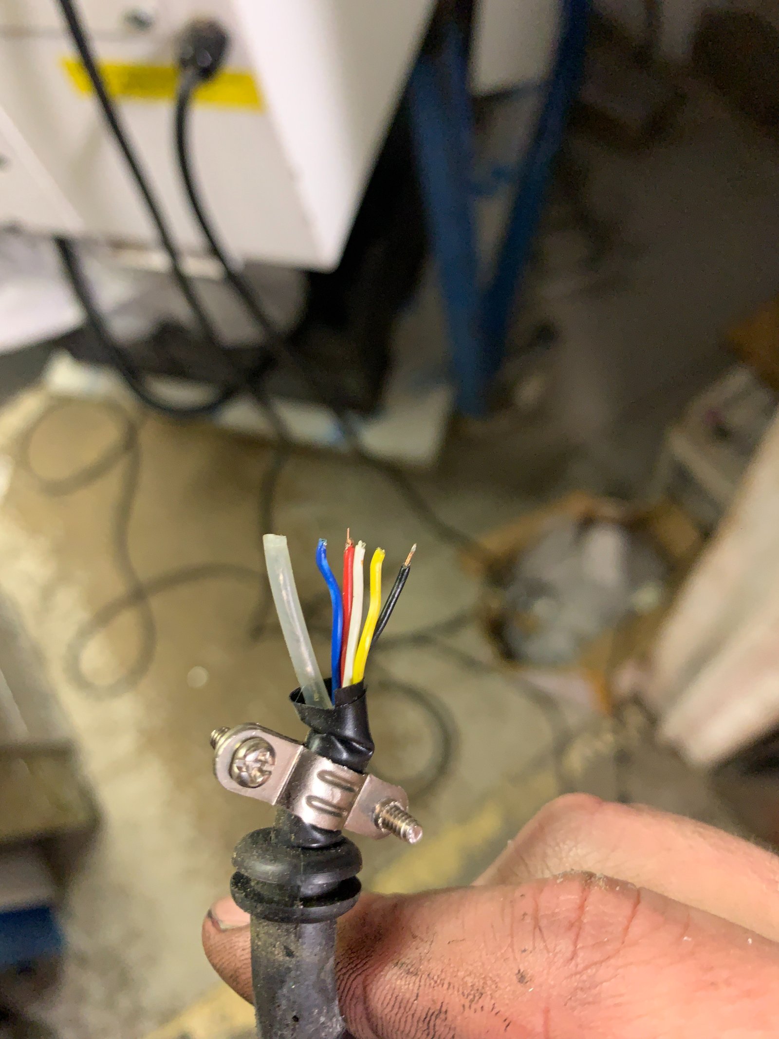

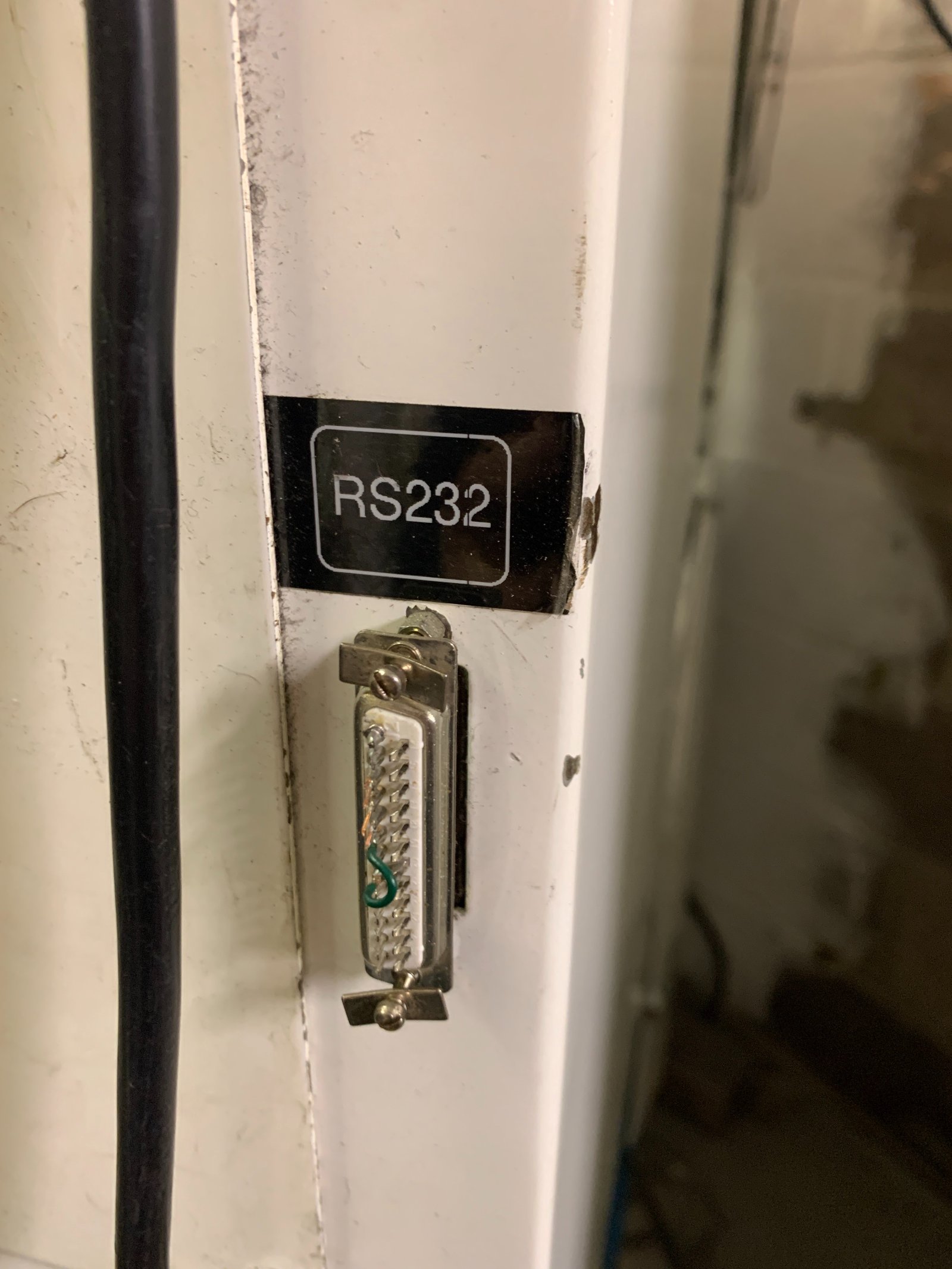

Was moving the machine today and unfortunately the 25 pin side of the RS232 cable got caught and pulled the cables out the pins, does anyone know the correct pin outs before i try and guess?
(Please attached photos for colours and pins)
Help appreciated

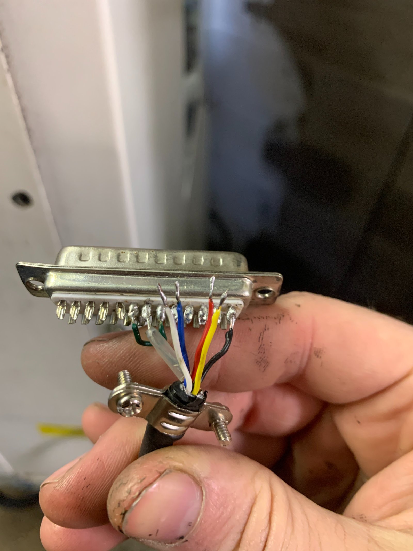

So by looking at what tails were left on the plug I've put 2 wires back in their original places but now it's these 4 left, no chance of guessing which way they go. Does anyone have the correct pins outs?
Excuse the grubby fingers :oops:

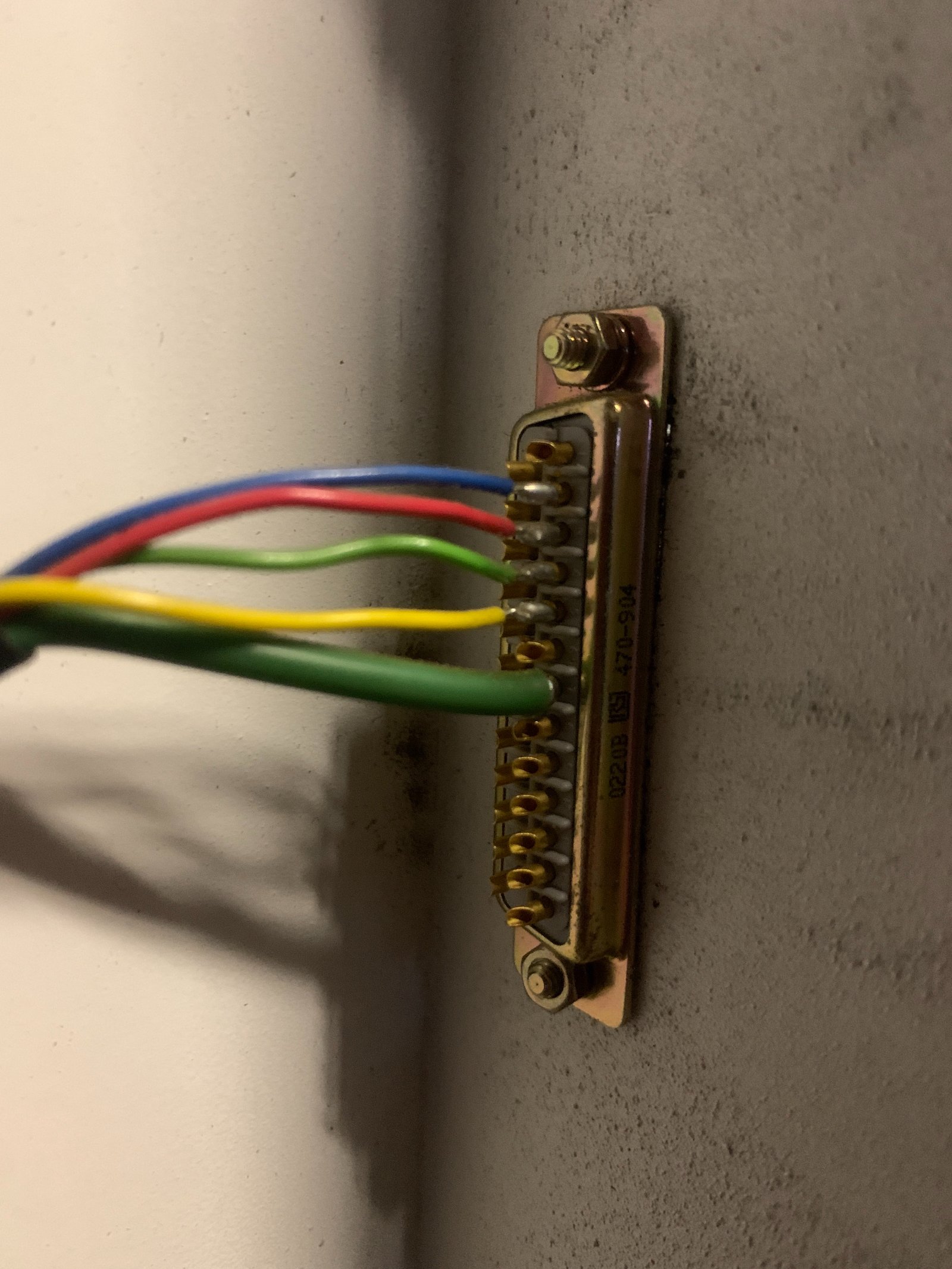

Here are the wires on the inside of the machine going into the RS232 plug. I'm even second guessing i have the Black wire and Shield in the correct place now as pin 1 goes to nowhere.

All sorted now.
This thread had the answer.
viewtopic.php?f=54&t=2351&hilit=BI01812GG
Wiring diagram of cable attached.
Hopefully there is enough key words in this thread to help the next person.
