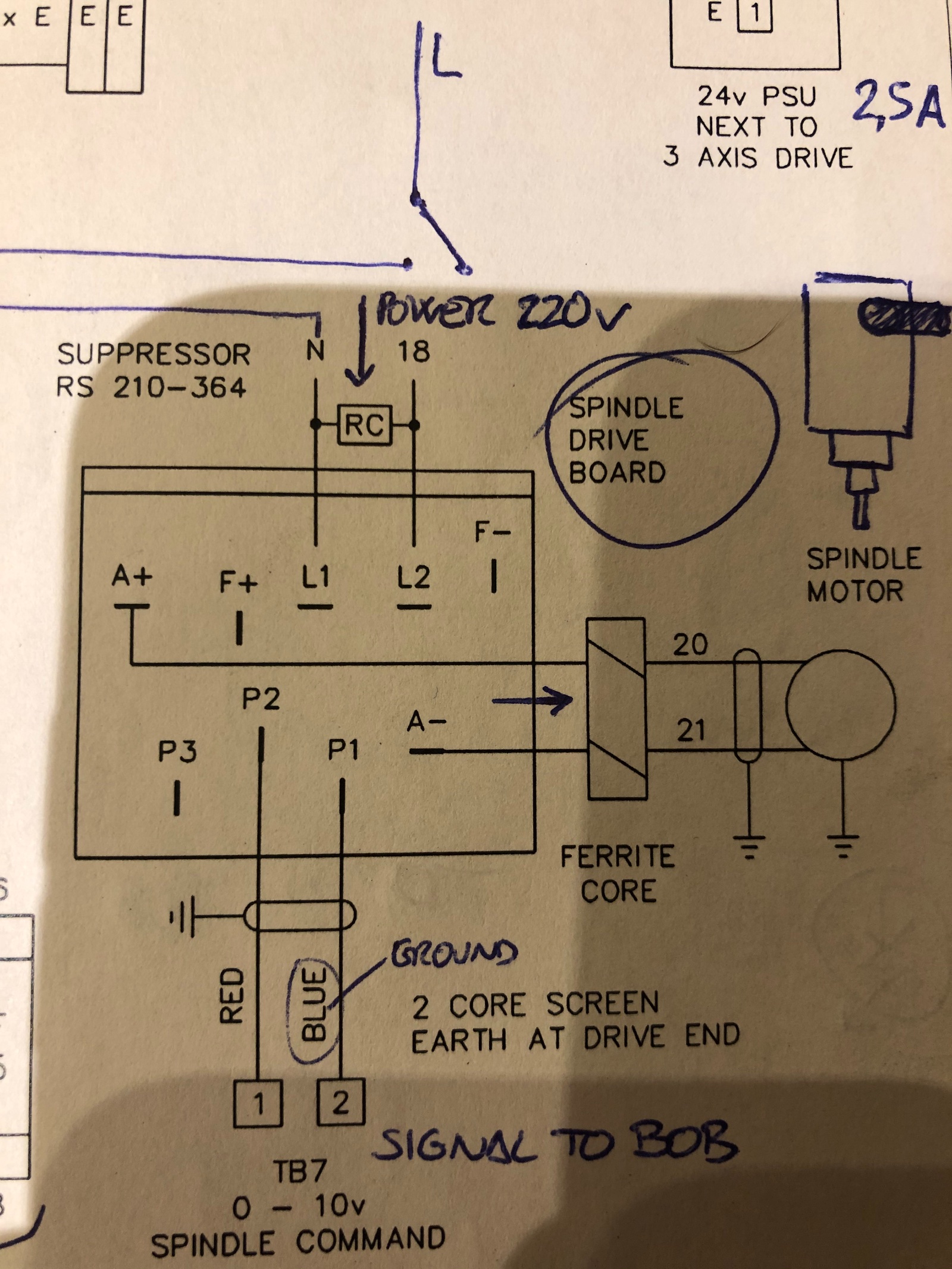

I’m new to the forum, and I’m in looking for confirmation on the spindle board;
I would like confirmation on the connection:
L1 and L2 are the main power 220v
A+ and A- are the output to the spindle motor
Now the real question:
P1 is the negative 0-10v
P2 is the positive 0-10v
So if I connect 5v to P1 and P2 I should have the spindle going half the speed. Is it correct?

IIRC P1 is the 0-10V 0V reference, P2 the 0-10V speed signal input, P3 the 10V reference so you can connect a suitable pot across P1 and P3 and take the wiper signal to P2 if required. The main thing to know is that 0-10V signals are referenced to the motor supply voltage and should not be connected to your BOB ground, it's the reason most BOBs have an optoisolated section to convert a PWM signal to an isolated 0-10V speed signal and its reference so it's safe to connect to the spindle motor board 0-10V speed input. So putting 5V on P2 referenced to P1 will give you 1/2 speed but using the digital 5V from a BOB could be dangerous.
