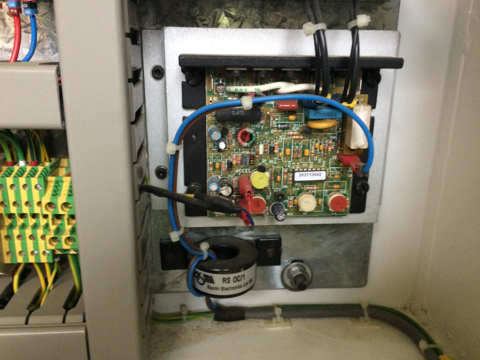

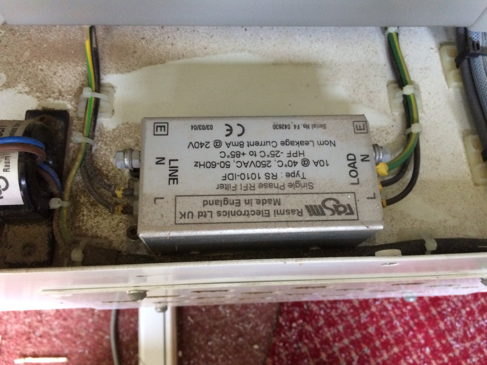

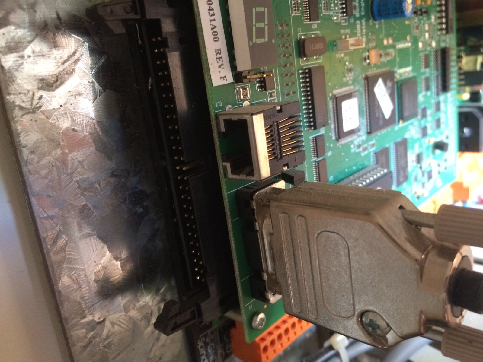

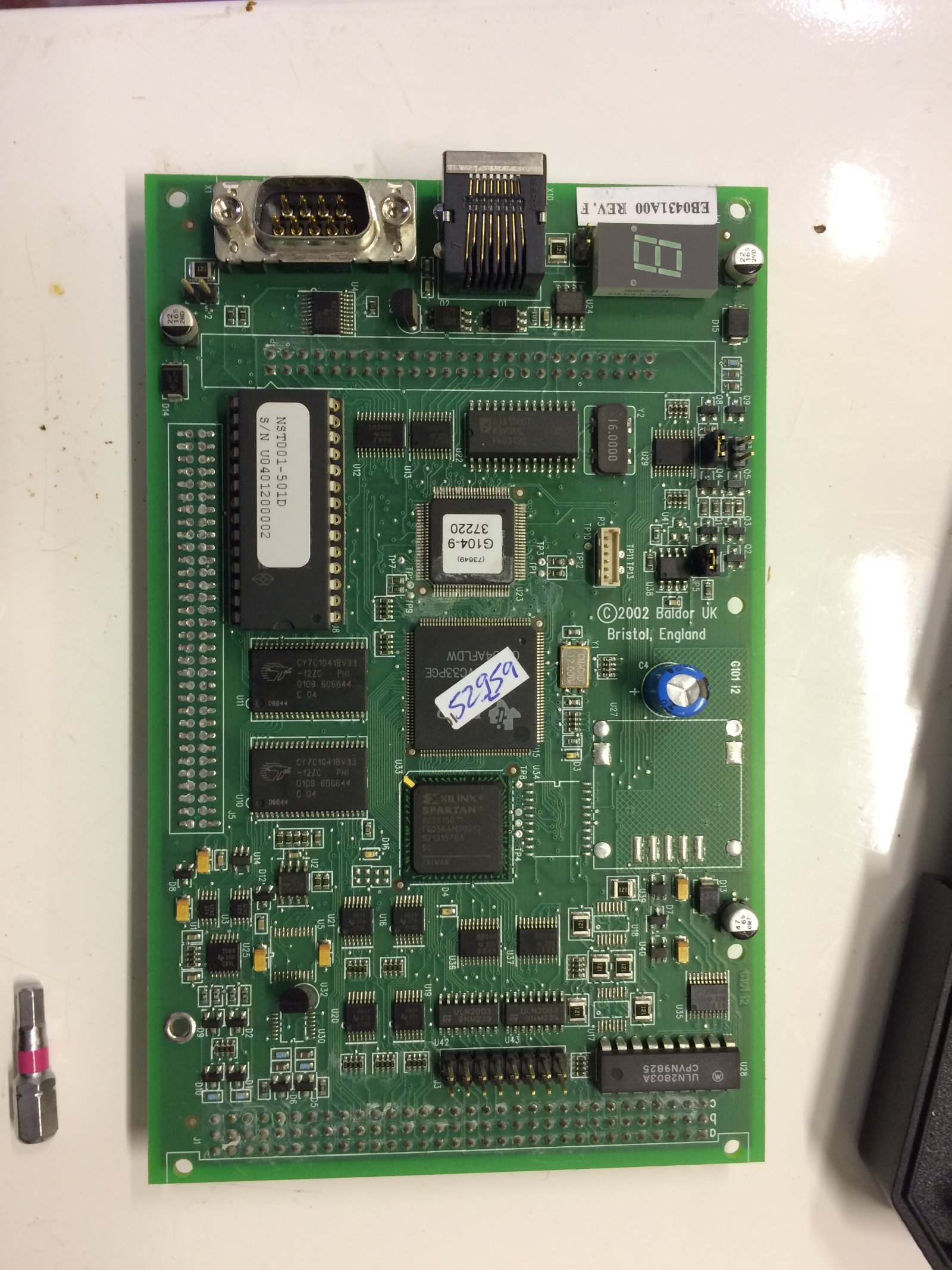

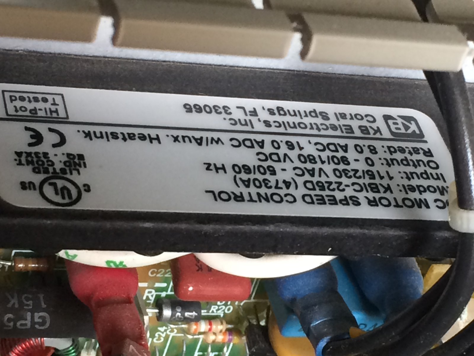

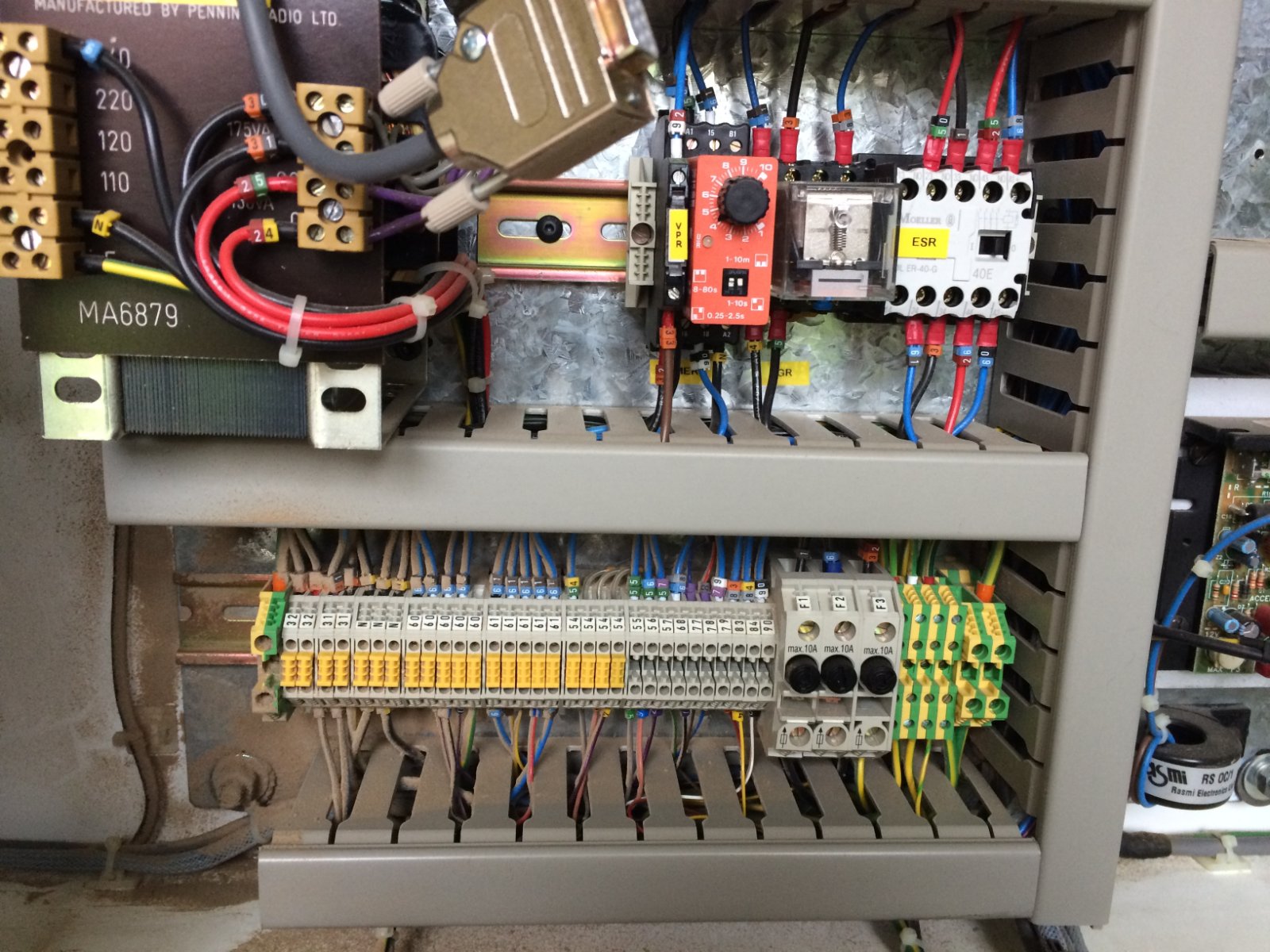

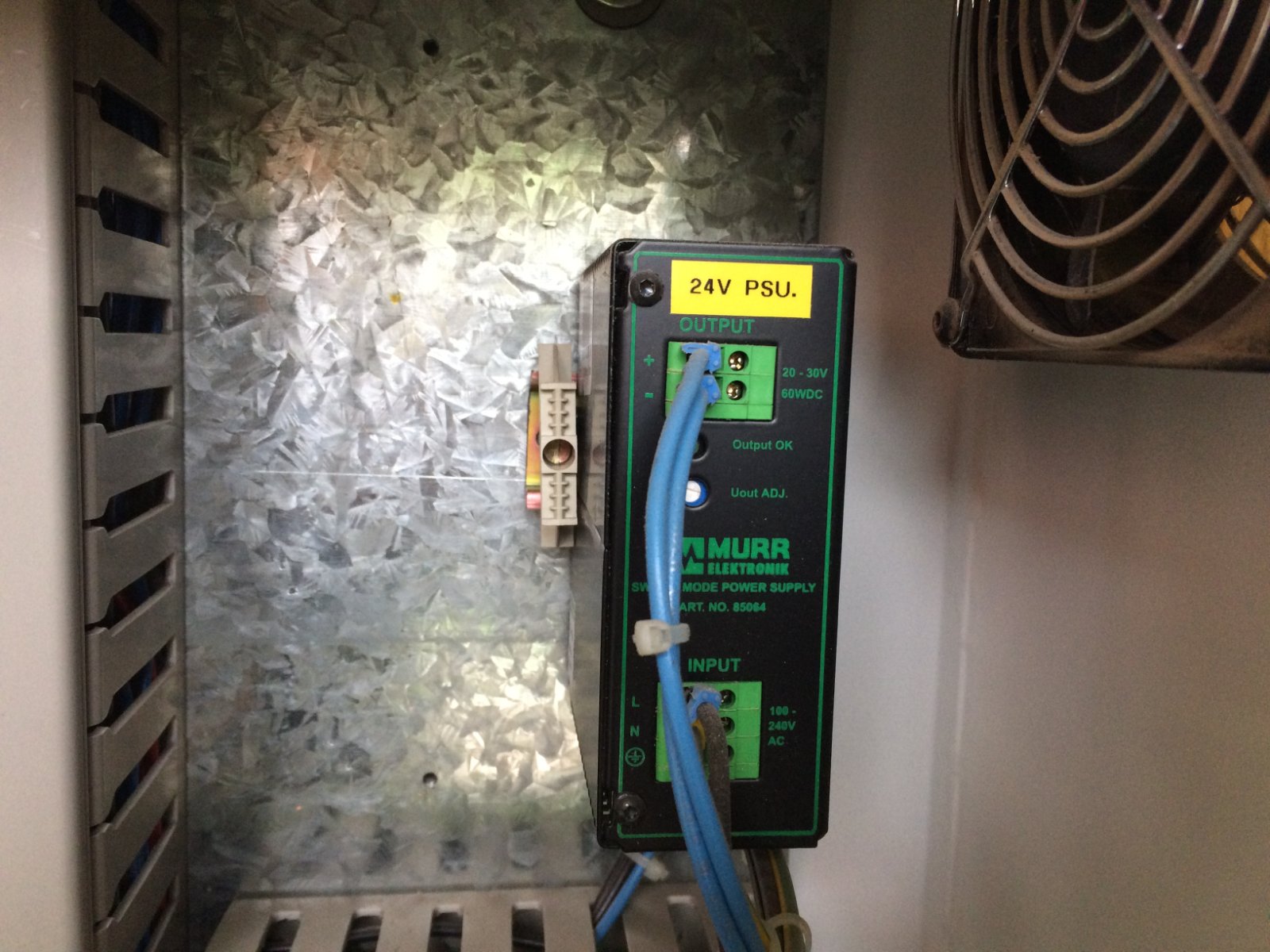

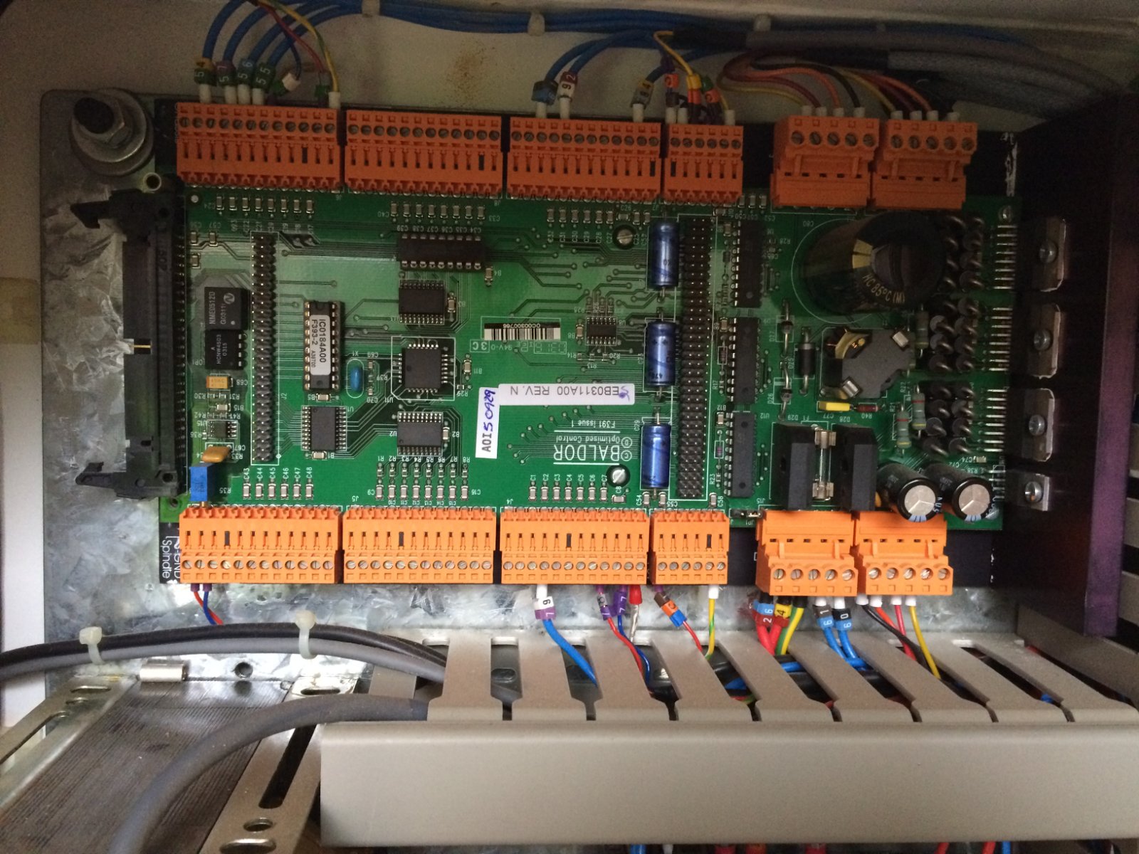

Thanks for the reply. Attached are some photos.
I would like to keep the original electronics but unable to purchases a licence as Denford is shut until further notice due to covid19.
It would be nice to see if everything works as it should before getting a licence as it would be an expensive job is any off the electronics needed replacing.
I have Fusion360 (must get to grips with it) started out on DesignSpark Mechanical and yes I know it was a bad mistake but we live and learn.
I have hooked the machine upto my laptop via a serial to usb converter but laptop don't seem to see it, even when running easy upgrader.
Could do to know if everything works as it should before buying a licence. Going to dig out an old laptop this evening with a serial port (if I still have one) and see if it connects
Ian

ok you have a next step RS232 card so you will need to ensure your PC has an RS232 port, it doesn't need to be anything high spec unless you are doing the CAD on it. I tend to do the CAD in the house and take the file to the garage but inevitably found i have had to modify things so upped the spec, Its just an old Dell dual core. You would be able to run VR5 to control the machine.
Providing the electronics are all OK the only thing they normally need is a good clean out, easier to point and say whats needed than to type.

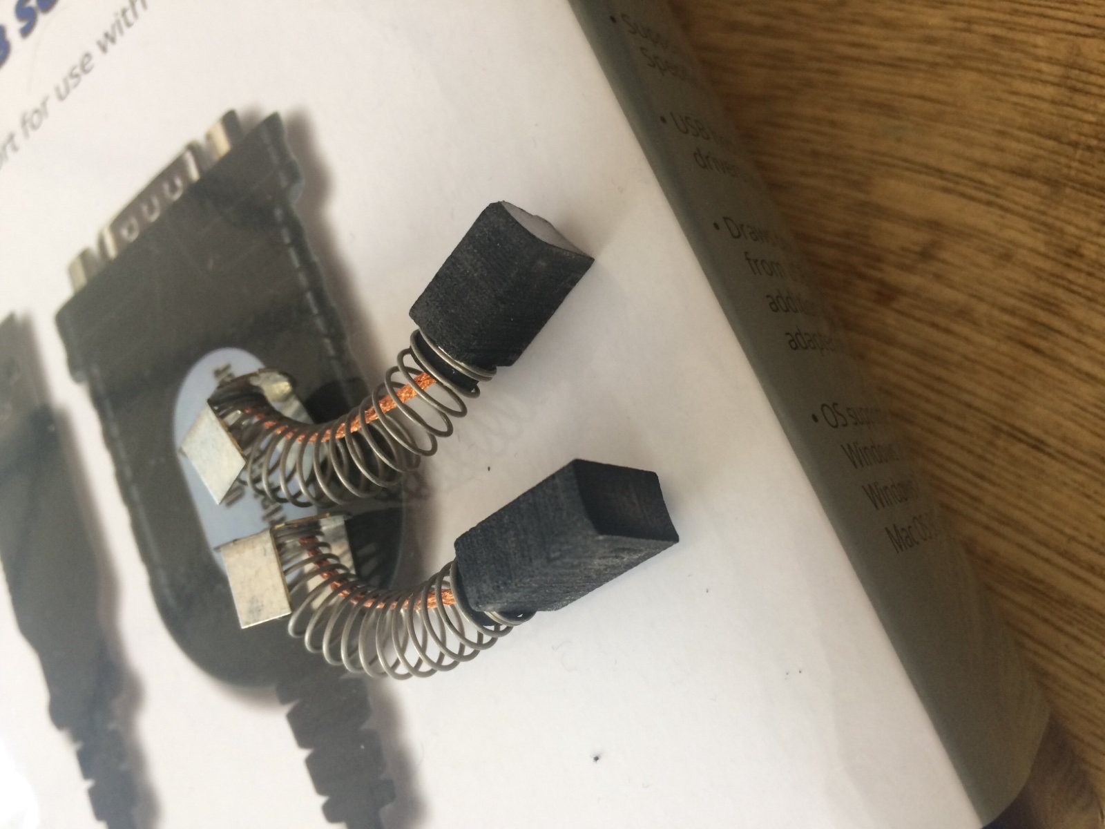

If it has the portacable router motor, it's worth popping it out of the mount and checking the brushes aren't worn. I would replace if getting down to about 5mm, does it have the vacuum bed?
Where are you? if not a million miles away I could pop with my pc and run it up. Drop me a private message.

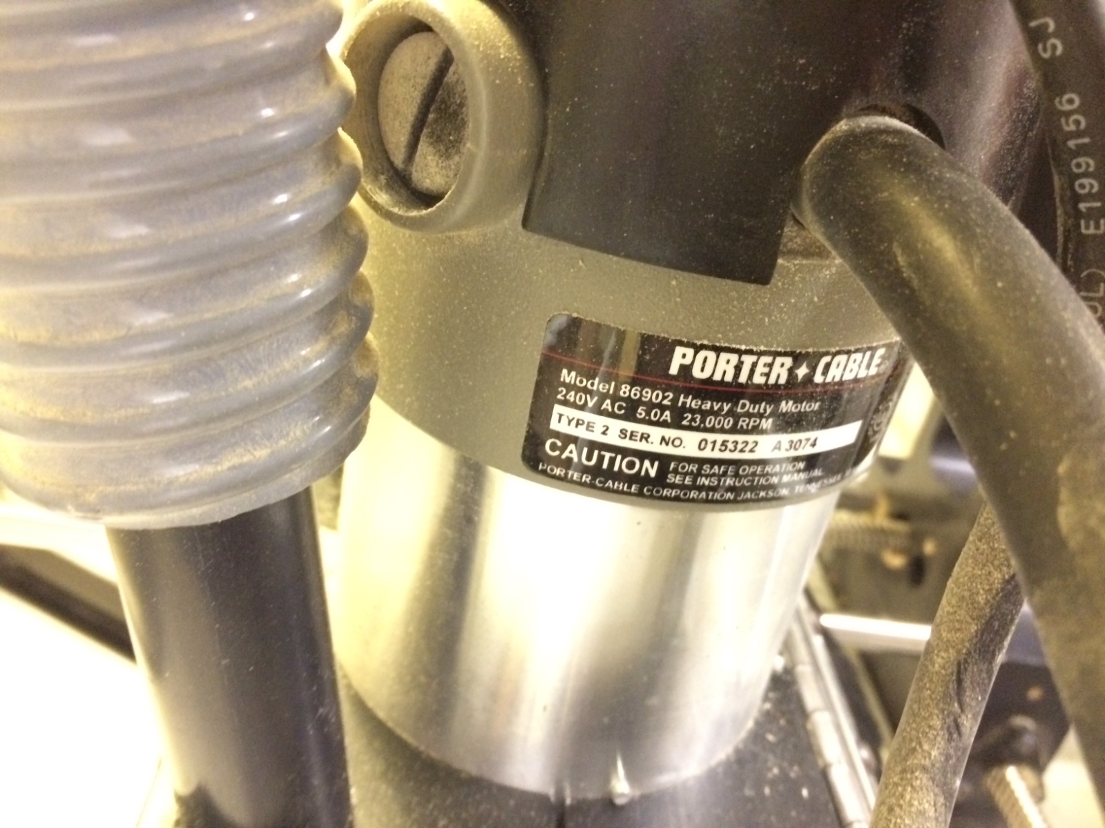

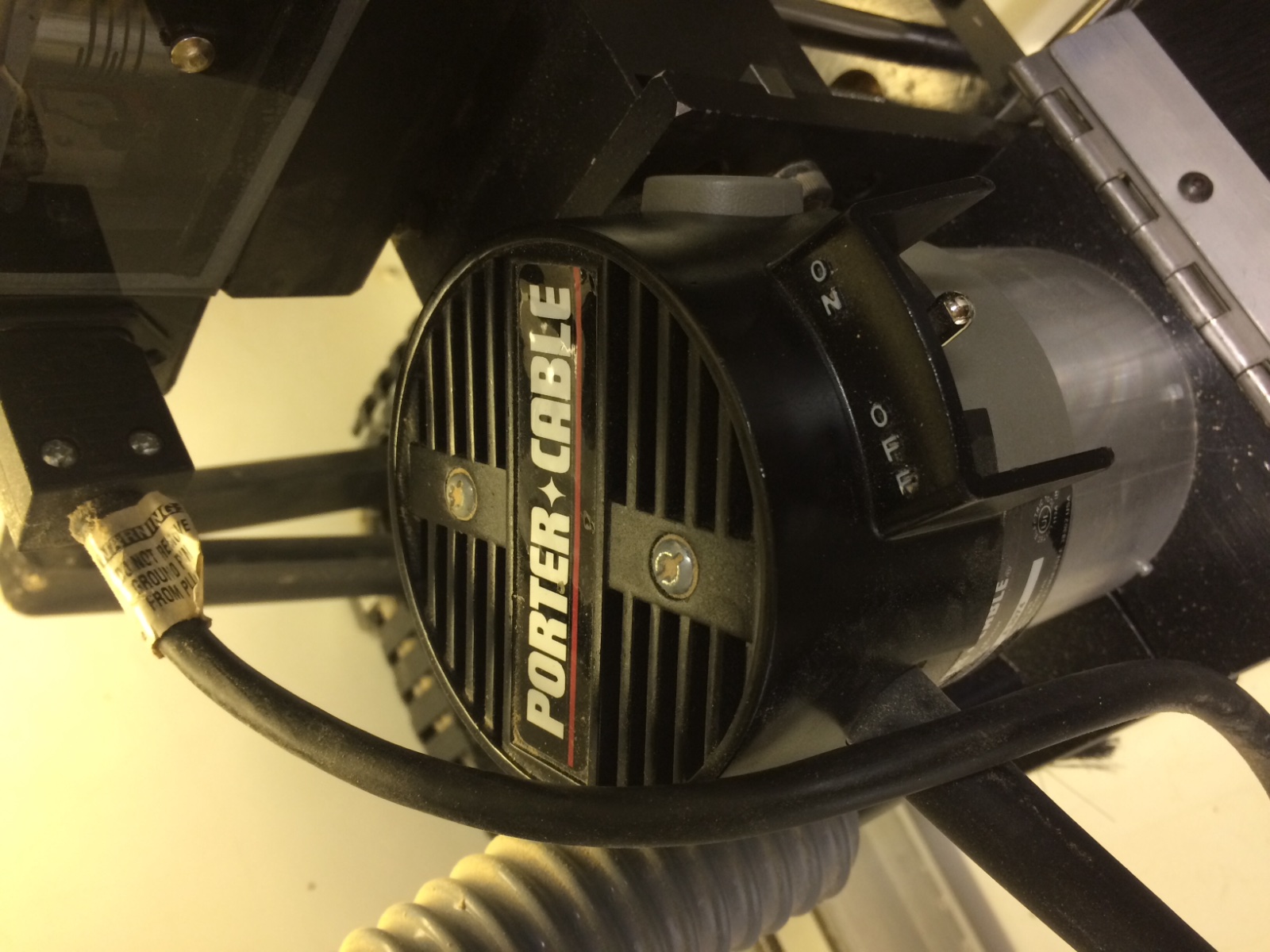

Not sure if it’s a newer motor or not but this is the motor on it
- 6311C757-79EC-4AD6-944D-C175E1D40C8B.jpeg (422.64 KiB) Viewed 33020 times
- 886EFE43-FADD-4C09-8BB2-2B0A8E3FA0D3.jpeg (368.46 KiB) Viewed 33020 times
- Posts: 613
Re: Advice
that looks to be the later of the 2 types fitted, the aluminium base holding it is just a clamp with an allen key, loosen it off and you can lift the motor out (unplug) use a coin or large screw driver to undo the 2 plastic covers (slowly) the brushes are in there, bit of a fiddle but they just pull out, you can check the length then for wear. Should look like this https://www.ebay.co.uk/itm/Porter-Cable ... 3331950151
so you get an idea of how much use they have had.

Thanks Pete
Already removed from the machine, Will check them when I get home

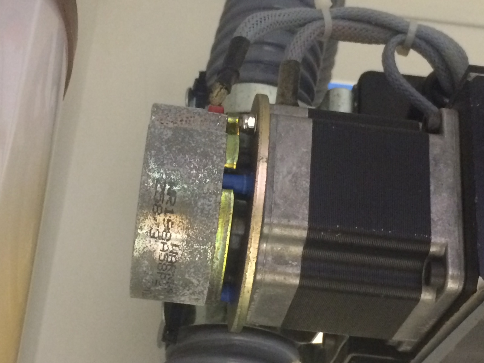

Anyone know if the z axis motor as been modified?
Don’t show the extra part on top in the manual
- FAD73F8F-93FE-4B42-A9BA-FD2B6C61FD50.jpeg (320.68 KiB) Viewed 32983 times
- Posts: 613
Re: Advice
thats a brake, rather than relying on the stepper to hold the height, not fitted to all machines.

Makes sense why I can't turn the motor by hand
