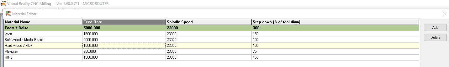

What sort of feed rates are people using on the micro router?
I wonder if I'm going a bit slow?
6.3mm router bit I'm running at 500mm/m on mdf with a 2mm DOC
Re: Feed rates?
Post by Martin » Mon 13 Jan , 2020 8:49 am
We recommend a feed of 1000, spindle speed 23000 & depth of cut 100% of tool diameter.
Microrouter Materials.PNG (12.01 KiB) Viewed 19533 times

so if Im using a 6.3mm router bit, you recommend 6.3mm DOC @ 1000mm/m?

Re: Feed rates?
Post by Martin » Mon 13 Jan , 2020 15:37 pm
Yes that's what we use.
If you want you could lower the depth of cut & increase the federate.

and a denford microrouter can handle that?

Post by TDIPower » Mon 13 Jan , 2020 19:47 pm
I run it all the time on the 2 machines at work and mine at home, your ears are your friend... if it sound rough dial it back on the over ride. So if you are doing a plunge/slot cut then I might dial it back a little then when it is up or down milling it will be fine on 50% step over
