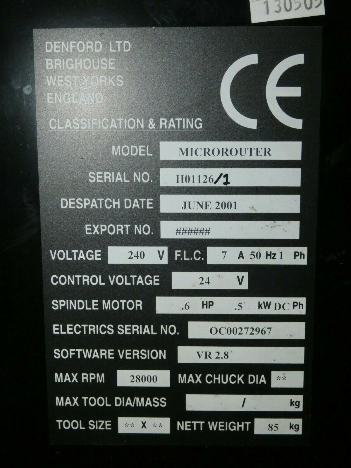

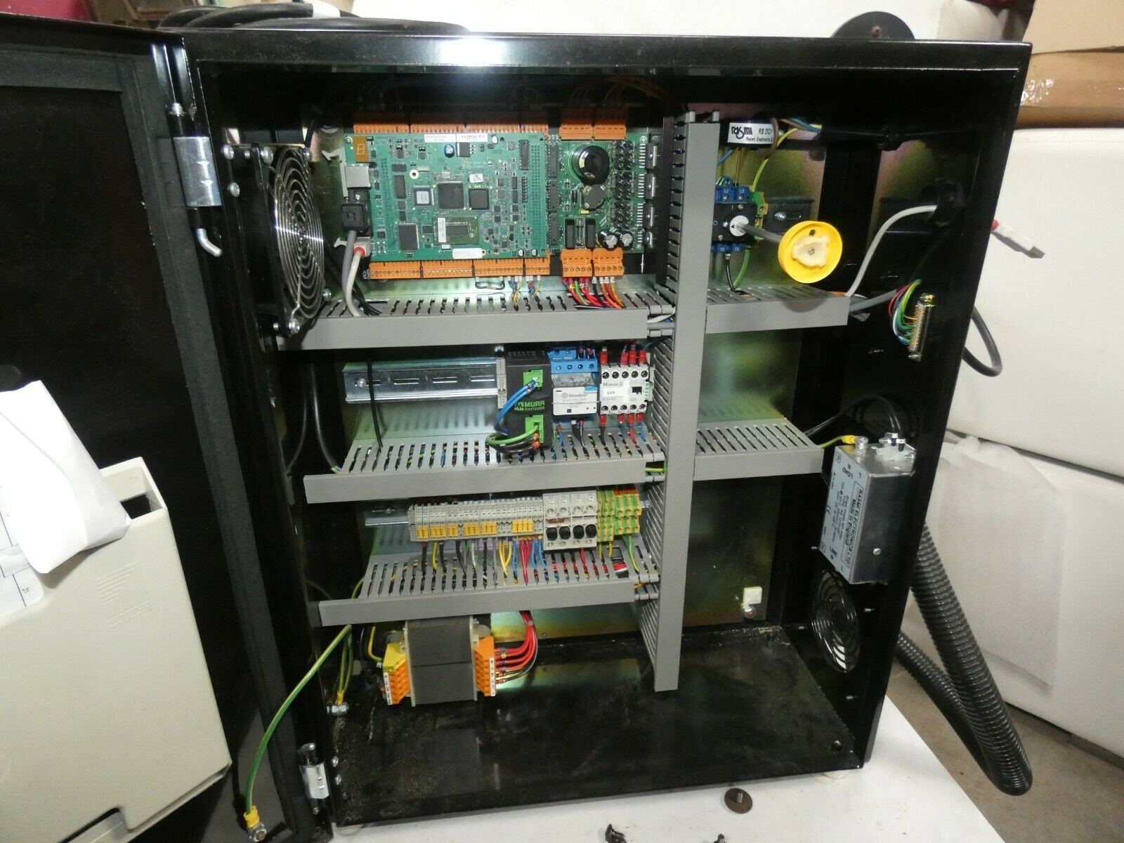

Thinking of purchasing this Micro Router 2nd hand. Came from a college sale. I tried plugging it in when viewing it and the light\fan\electric door lock\emergency stop button worked, but I can't test it fully without the VR CNC software. It has a USB coming out of the back (See picture), a Kress spindle, and I was told by Denford (After emailing the details) that it was upgraded in 2011. I have a picture of the inside, and also the writing on the black box that comes with it. It also comes with all electrical\wiring schematics too. I have seen some pictures on this forum of the inside of other Micro Routers and this looked slightly different so I just wanted to check.
I just wanted to know if everything looks alright on the inside of the black box (is everything where it should be\is everything there)? The 'Spindle Override" button has been removed too.
Also what version of the Micro Router is this? Is there anything else I need to know\look for?

All looks good. In 2001 the machine would have had a serial port and no USB. It also had a porter cable motor which allowed variable speed.
The upgrade to USB gives improved performance and the Kress spindle motor cannot be controlled by the spindle drive as it has a speed selector switch on the motor.
You would need to purchase VR Milling software to use it but there should be no other problem.

PS Thought there were pictures further up the post of my machine, but it's just the black cabinet!! If you need pictures to understand the amateur nonsense I'm spouting, please just ask!
