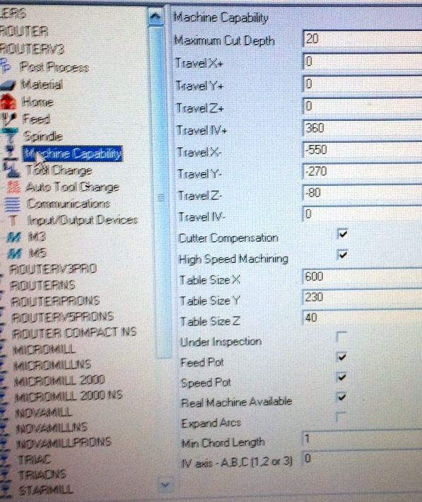

According to the book the y axis parameter should be 320m but when I am moving it to the fullest extent it only moves 270mm. I checked the parameters and as can be seen on the photo it is listed as 270mm. Can it be changed to 320mm and is it just a case of altering the 270mm number to 320 in the capabilities chart.
Also when I am routering a project the description in the Editor has it listed as a Novamill and not a V3 Microrouter. Maybe this issue is linked?
Thank you in anticipation of your help
Mike

We changed the value when we upgraded to the larger porter cable spindle motor. Just change the value as you said & see if you can jog it to 320mm.
Have you got the right machine selected? Right mouse click on Router V3 & then click on set as active.

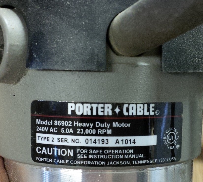

Got a photo of it here. Physicsally it doesnt look like a 1.5hp router and the plate on the contol box does say 0.6hp. It came from a school so I dont think it would have been upgraded as it was hardly ever used.

Just googled the model no to find out it is the 1.5hp model. Very pleased. That has made my day. I just assumed as it came with the 1/4 inch collet that it was the 0.5 hp model. So instead of spending 500 quid I will only have to spend 30 quid to get the half inch collet!
