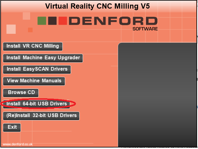

Have you tried installing the 64-bit USB driver from the VRMilling software install page with the USB device disconected?
You may need to alter the power saving options in Windows 7 when you get it working.
viewtopic.php?f=9&t=3365

Re: Microrouter Pro V5 x64 woes
Post by Martin » Mon 29 Jun , 2015 22:23 pm
It will not show up as a printer but you should see the USB device in device manager if it is plugged in & powered up.

Ok, just installed the drivers using the VR CNC milling v5 setup page and they installed successfully.
