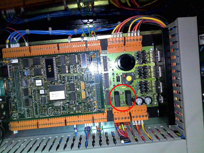

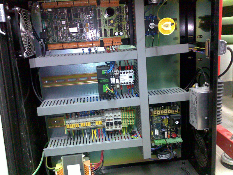

Re: Fuse T6.3AL 250V
Here is the pictures. The fuse is located on the red circle.
- 210820091951.jpg (588.17 KiB) Viewed 22792 times
- 210820091961.jpg (579.04 KiB) Viewed 22792 times
I checked the brushes and it looks fine and still 15mm. and I not sure about E-stop and the heatsink..
Steve, what you are saying is correct.. the fuse blow just after release E-stop button. Then what else I need to do?Steve wrote:It sounds like the problem is not with the spindle.
Unless the fuse blows as you try to start the spindle this is not the problem.
I think you are saying the fuse blows just by powering on the machine.
Martin has suggested that if the fuse on the Control card is the one that is blowing the problem could be with one of the stepper motor drive chips.
Please send a photo of the Electrical cabinet and identify the fuse that is blowing.
Press in the E-stop button and power on the unit.
The 7 segment display should light on the Baldor control card. The fuse should not blow.
Then release the E-Stop, this should apply power to the axes drives if one of the drives is at fault the fuse would blow at this point.
