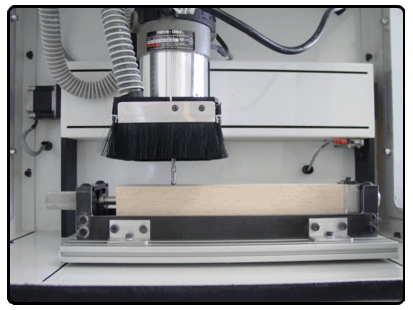

Does your machine already have the black brushes all around the motor mounting plate ?
As far as I know, thats the only method we have for containing the dust so that the vacuum can remove it from above.

No, I don'd have the brush plates to go around the black chassis.
1 - Where can I see pictures of these plates?
2 - Where can I get them?
3 - How much are they taking in consideration that it's for educational purposes? (Without VAT)
4 - Can we get them straight from you?
5 - How soon could it be here in Lisbon, Portugal?

Post by Denford Admin » Tue 24 Mar , 2009 12:33 pm
This image shows the brushes.
Apperently, however, we have stopped fitting the brushes so I'm not sure whether a) we can still supply them or b) they would work anyway...I guess they were removed for a good reason !
I'm sure you could experiment with something, to see if you can contain the dust for long enough to let the vacuum suck it away.
