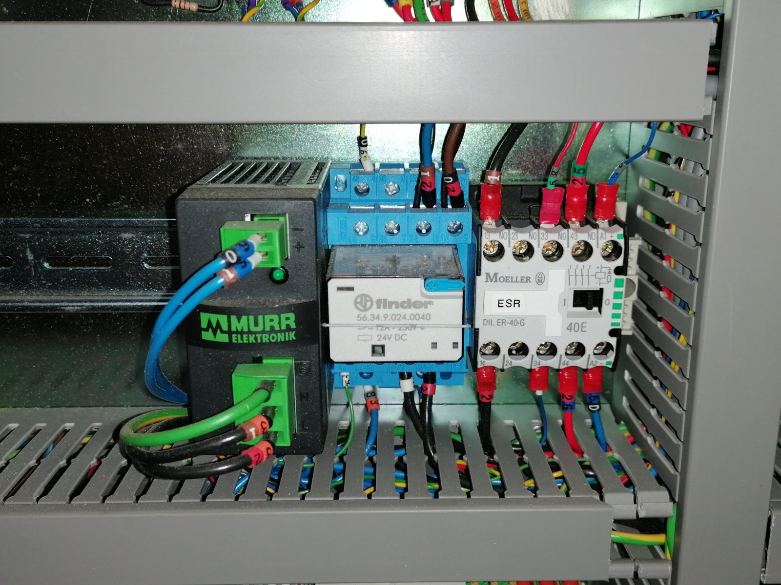

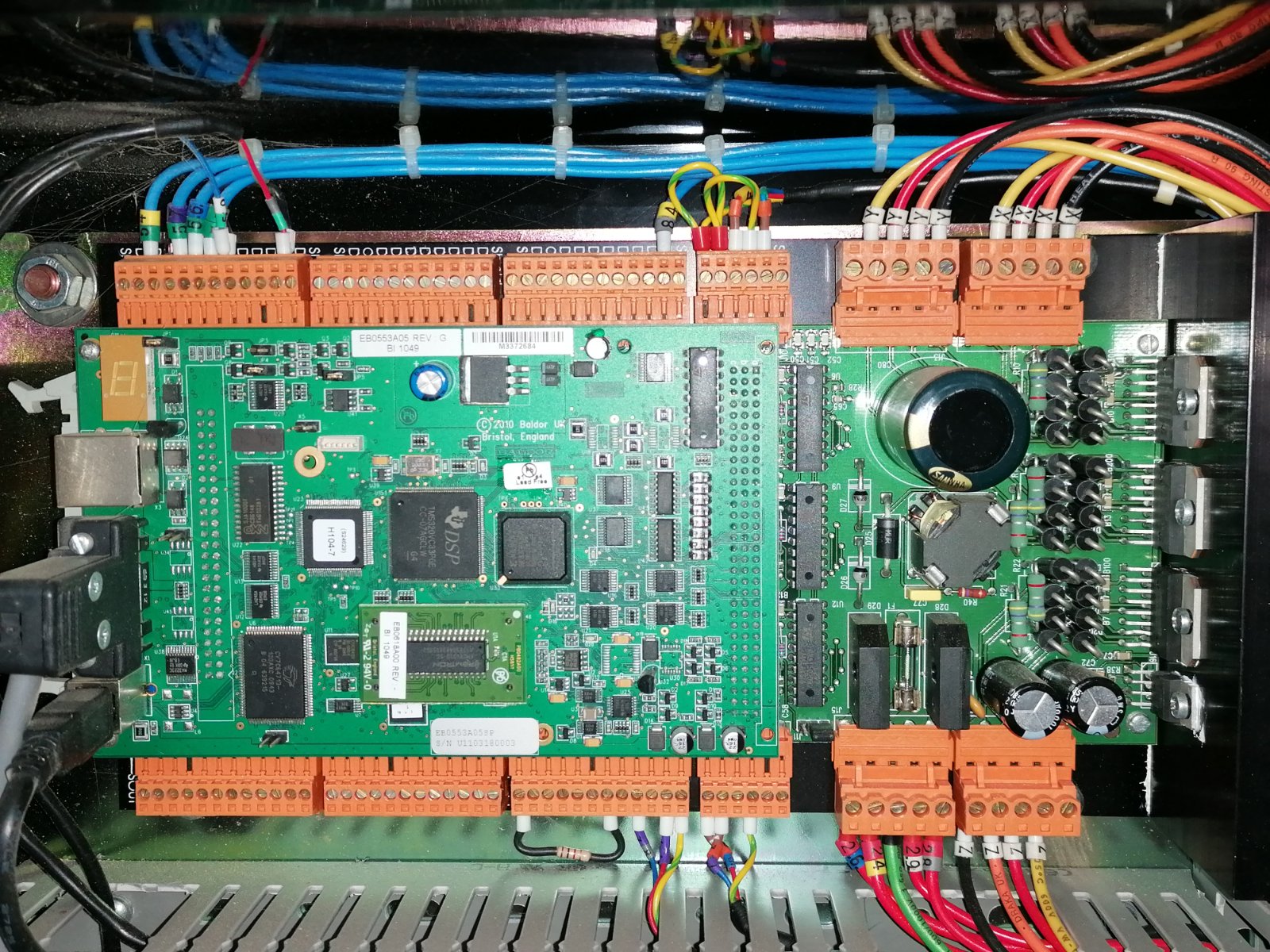

Door Open issue.
You say you have taken the lock off and 'it doesn't look that dirty' what about inside are you able to see inside the switch that is inside the lock and see for sure that it is not full of sawdust? But the lock works, yes that is an electro magnet NOT the switch! just because it is inside the same lump of plastic doesn't mean to say the switch isn't gunked up to hell. It doesn't take much to stop 2 electrical contacts closing (this is where a 'bug in the system' comes from, It was a moth stuck in a relay so it couldn't make contact in a early computer)
I have no Idea on the wiring for your machine, it has been upgraded and is newer than anything I have explored. If you are not confident following a schematic diagram, tracing electronic/electric faults have access to a meter to test things It's a rabbit hole that could be dangerous and costly if you don't know what you are doing. In simple terms I would imagine there will be 2 or 4 wires going to the door switch (then 2 for the lock), when the door is shut they will make contact through the switch. Those wires will go back to the control board. I know Denford mark everything up in the panels so it should be possible to trace it through against the diagram.
A quick proof of issue would be to remove the wires at the control board that go to the switch and put a short loop in to replace them. As I say if you don't know what you are doing this could be a risky thing to do AND I have not seen the diagram for your machine so can't check it myself. If you were to try that it would be at your own risk.
I have a strong feeling from all the posts you have made that the machine is in need of a full service and inspection. They never get the care required in a normal school, they get sold off when they don't work properly. Trust me I know what I am doing and have had to train my technician on this and it is not a job any of us enjoy and the proper clean down after each job is a PITA so there is a trade off run the machine till it fails or, do OK clean ups, Lube the runs, inspect the brushes and when it starts to miss behave it's down time and a proper clean up again. Most schools do not have the experience in staff to be able to do this. So I very much doubt yours will ever have especially as you have said you have had stalling issues and rather than stripping and cleaning it all properly you slowed the feed speed. You have taken on this machine, you need to get to know it if you want to use it. Take that time to go through it properly.
On another note, you have expressed your frustration with the machine and posted up many issues YET when we have posted responses to try and help you rather than working through each point and noting what happens and responding to those points in a logical way so we can try and help further you try to continue with what you are doing and then post up more issues.
I will say it again. STOP, Step back and focus on one thing at a time. work through all the advice that has been put up.

I have taken your advice, taken a step back and am working on the problems one by one:
1. The spindle. Replaced the brushes, and it works fine.
2. The guard switch saying 'guard open' constantly. I have opened the switch checked it thoroughly and it was clean. Re tightened all connections and checked for damage to wires. Still nothing. I then bought a 'good working condition' second hand replacement switch which arrived today with a new actuator. Re-wired this the same way as the old one, and still the same problem.
Does anyone have any advice on the switch problem? Could it be a fuse? I think its highly unlikely that two switches have the exact same problem, but knowing my luck that could be possible. The power is coming onto the switch and the magnetic door lock under 'Emergency lock' and when turning on\off the machine works. I don't know what else to check. The black box and control card, but don't know what I am looking for, bar research I have done online?

The only suggestion on the switch is to go through the wiring diagram. Follow it back to the control board/s work out if the switch should be be open or closed when the door is shut and you want to use the machine. Once you know that and know where on the control board then remove the wires from the control board and put a direct link in as re required to the board. If that works it proves there is a problem between the control board and the switch (so the wires, switch etc). If it doesn't then to me it's point at a control board issue.
You need to test that out to prove the situation then you can plan next steps.

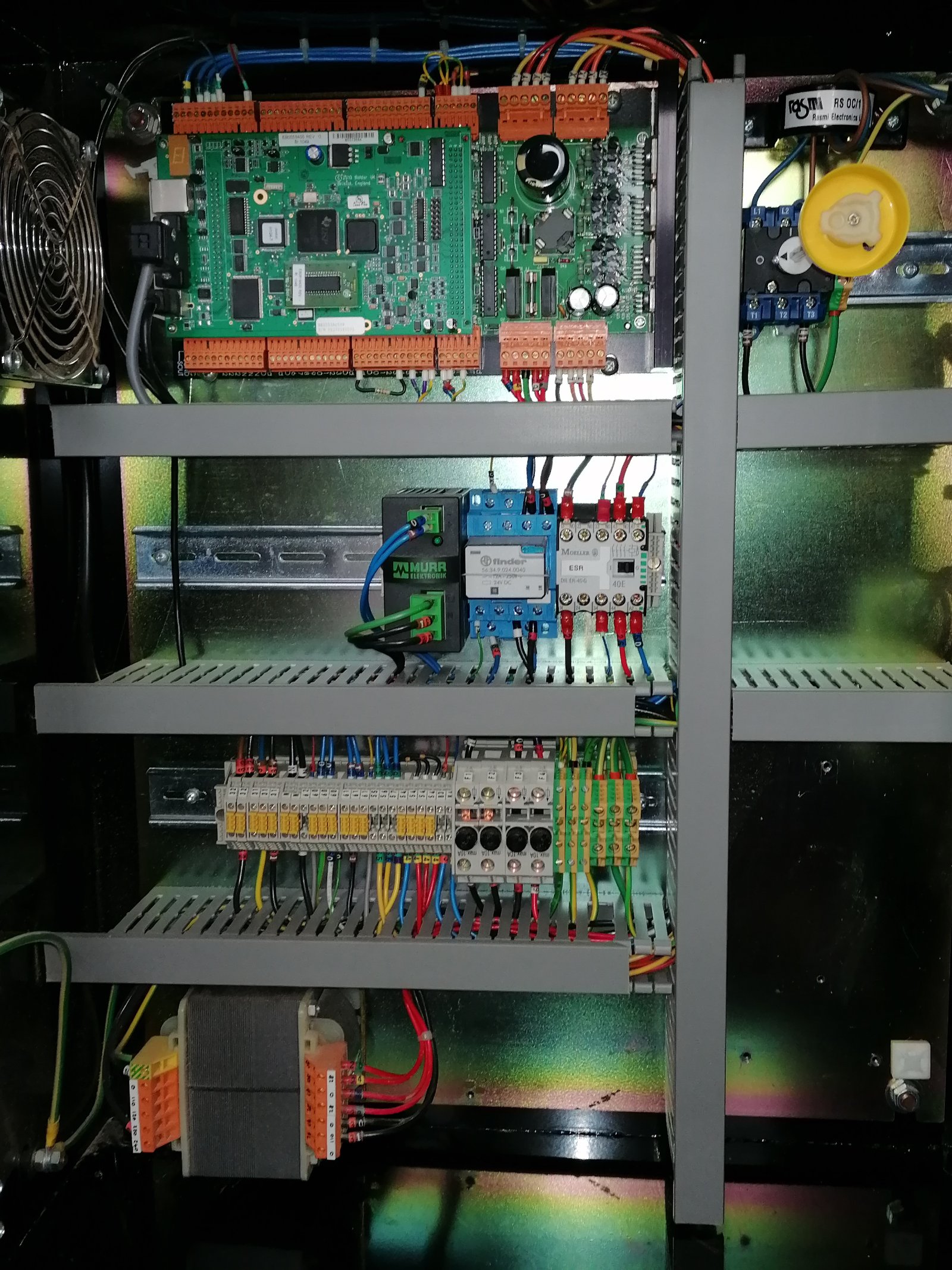

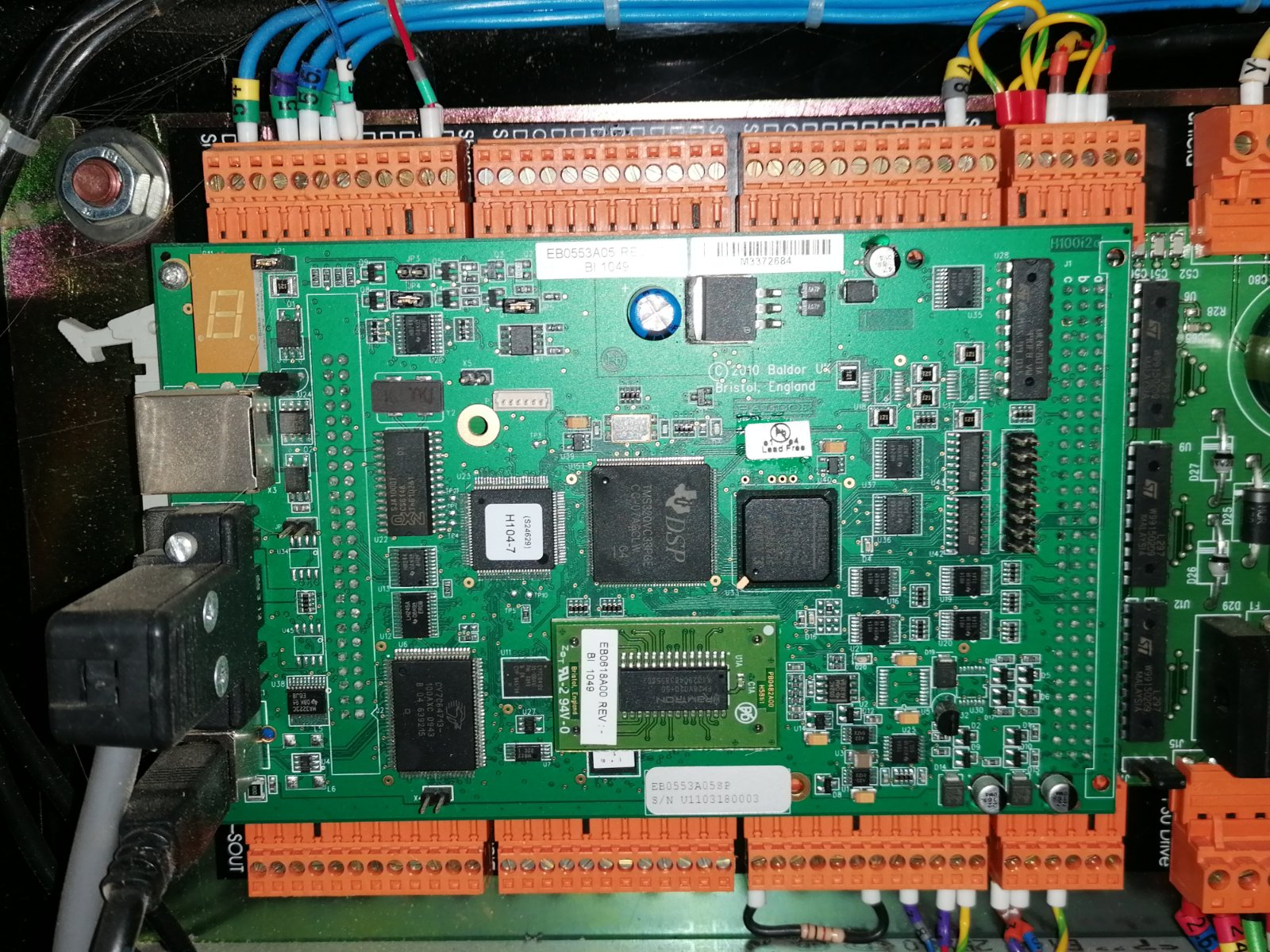

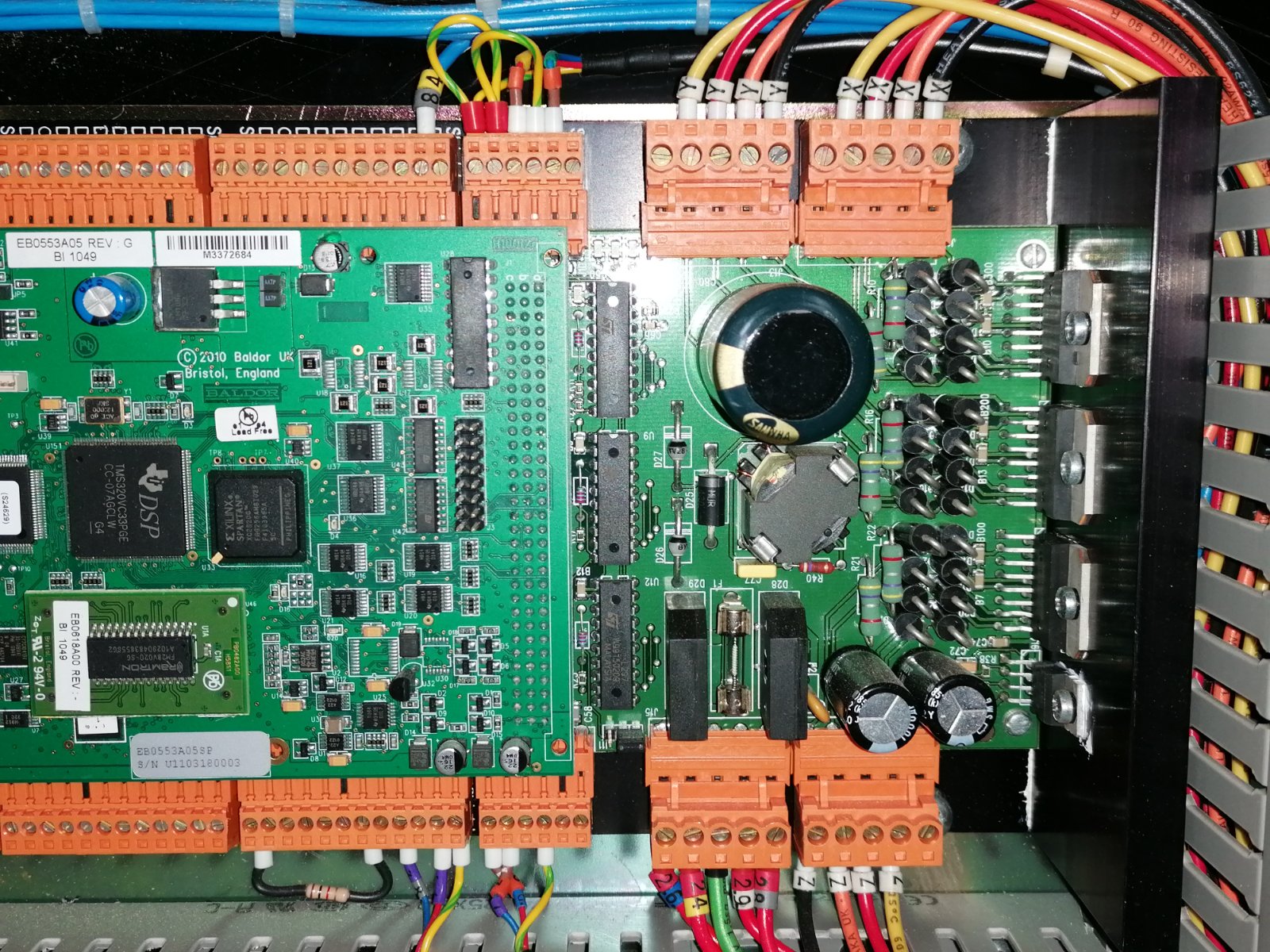

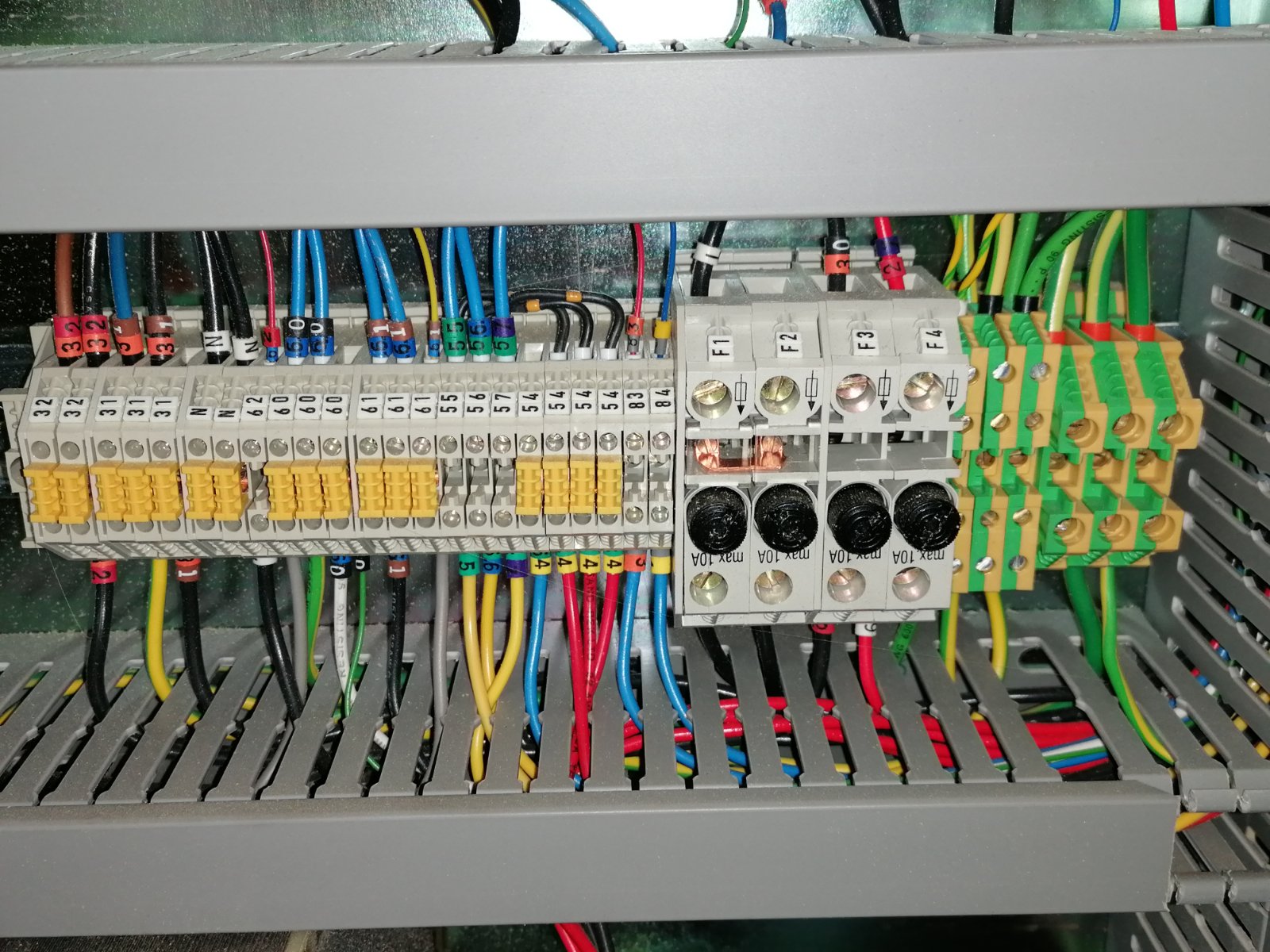

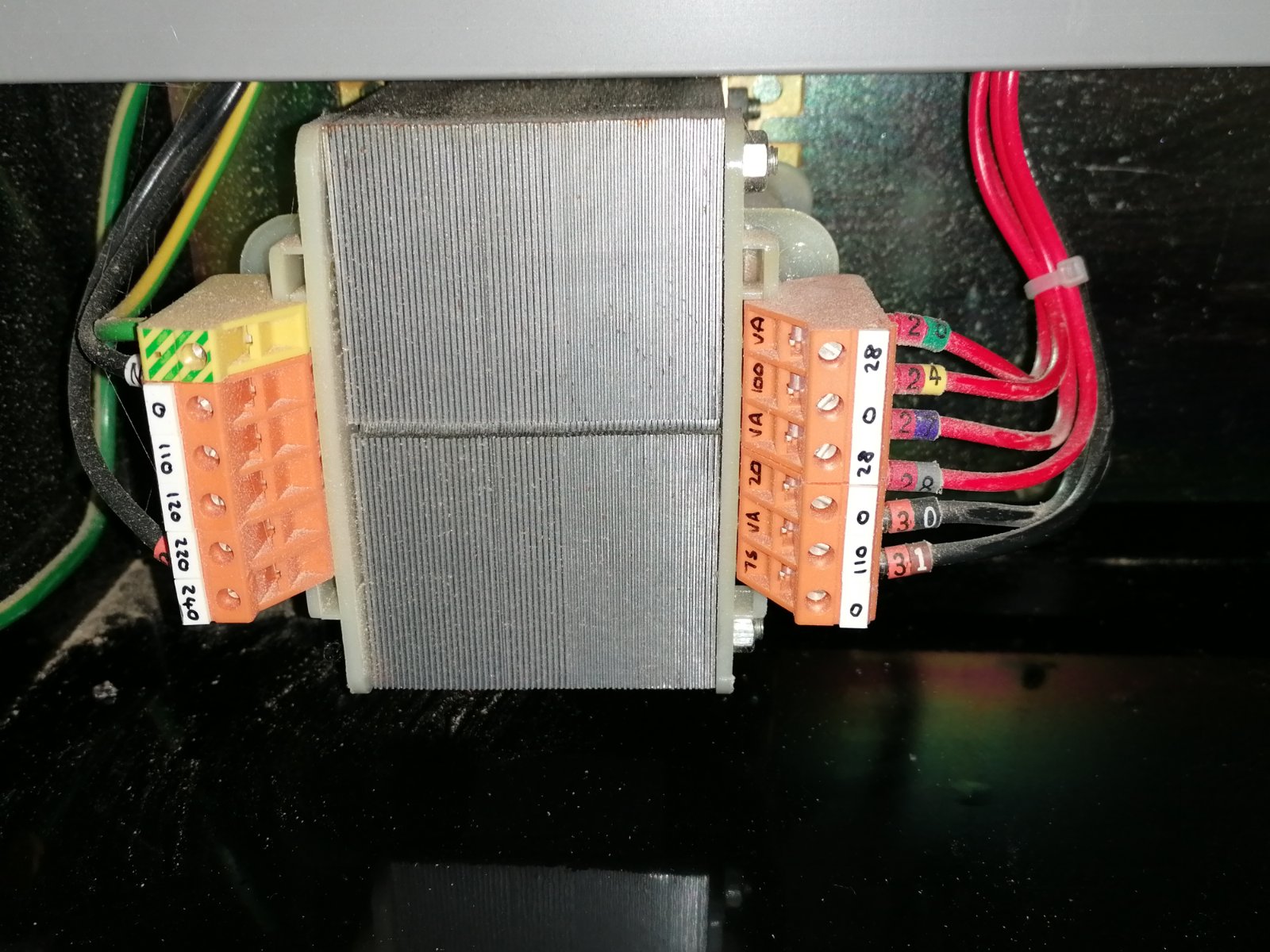

Here are pictures of the inside of my machine and the wiring. I have all the schematics, but they are from when the machine was manufactured and are dated 2000\2001, on the old 'DenStep' controller. Since then it has been upgraded to 'NextStep' so not sure how relevant, useful these diagrams are now. If anyone has any schematics or electrical diagrams for the NextStep card, and any info on my setup would be great.

- Posts: 613
Re: Micro Router 2nd Hand
You need to download the correct diagrams so you can trace your fault through. Look in the section for you machine.

I have an electrician coming tomorrow. It looks like Version 5 if I'm correct? It's very difficult to tell as it was upgraded from it's original control card.
The board connection are similar to v5, but is not v5.
You don’t have a timer or separated driver for the motors.

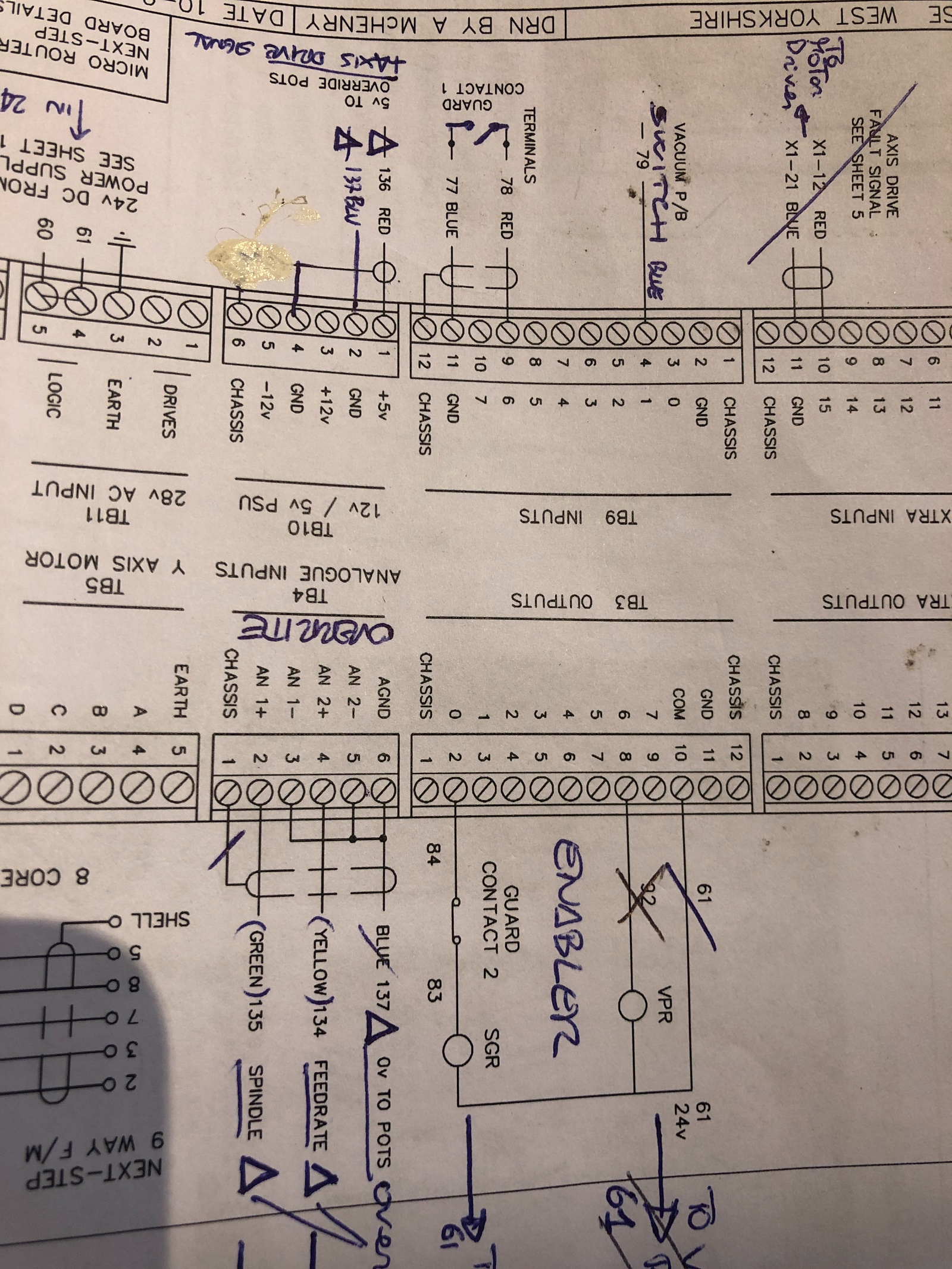

On your board, in TB9 (bottom, third group from left), you have 3 cables, should be numbered 78 77 and the third is ground.
That’s guard contact 1.
Have a look.
I removed it from my Bob.
The other guard contact pin is on the top of the break out board, group TB3, visible in the pic you posted and numbered 84 , this one if you open the door the spindle will stop spinning since is the relay enabler.
Pin 84 goes to the switch and then into cable83 that enter the blue relay in your cabinet. If you want to bypass the contact guard switch (to enable the spindle even if door is open), you can disconnect pin 84 from the Bob and connect a cable that enter directly in the blue relay (remove cable 83). It should be -24v.
Please note these are my advise but you do this at your risk.
Have a look at MY bodged diagram in pic and look at pin 77, 78, 83 and 84
