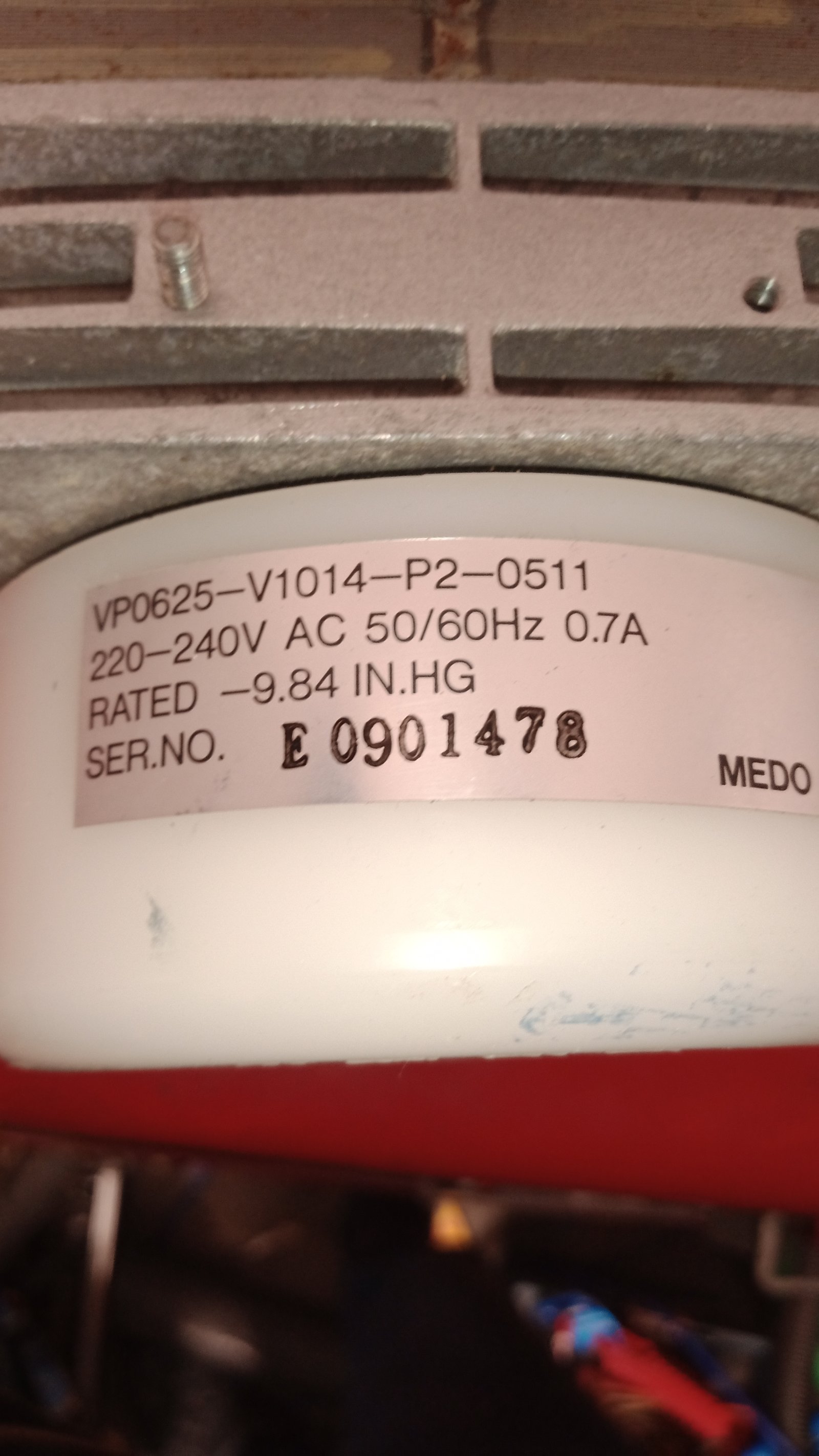

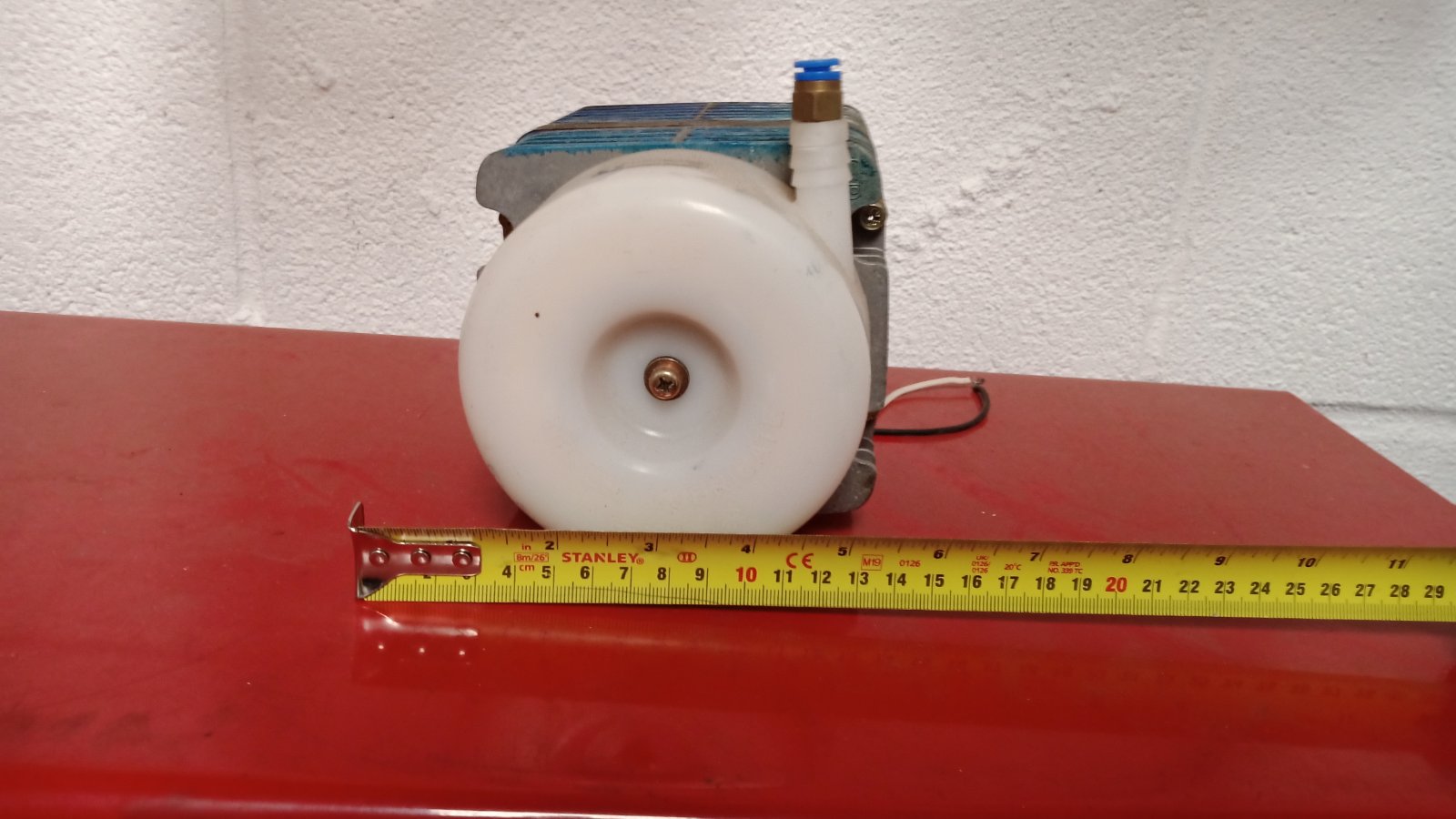

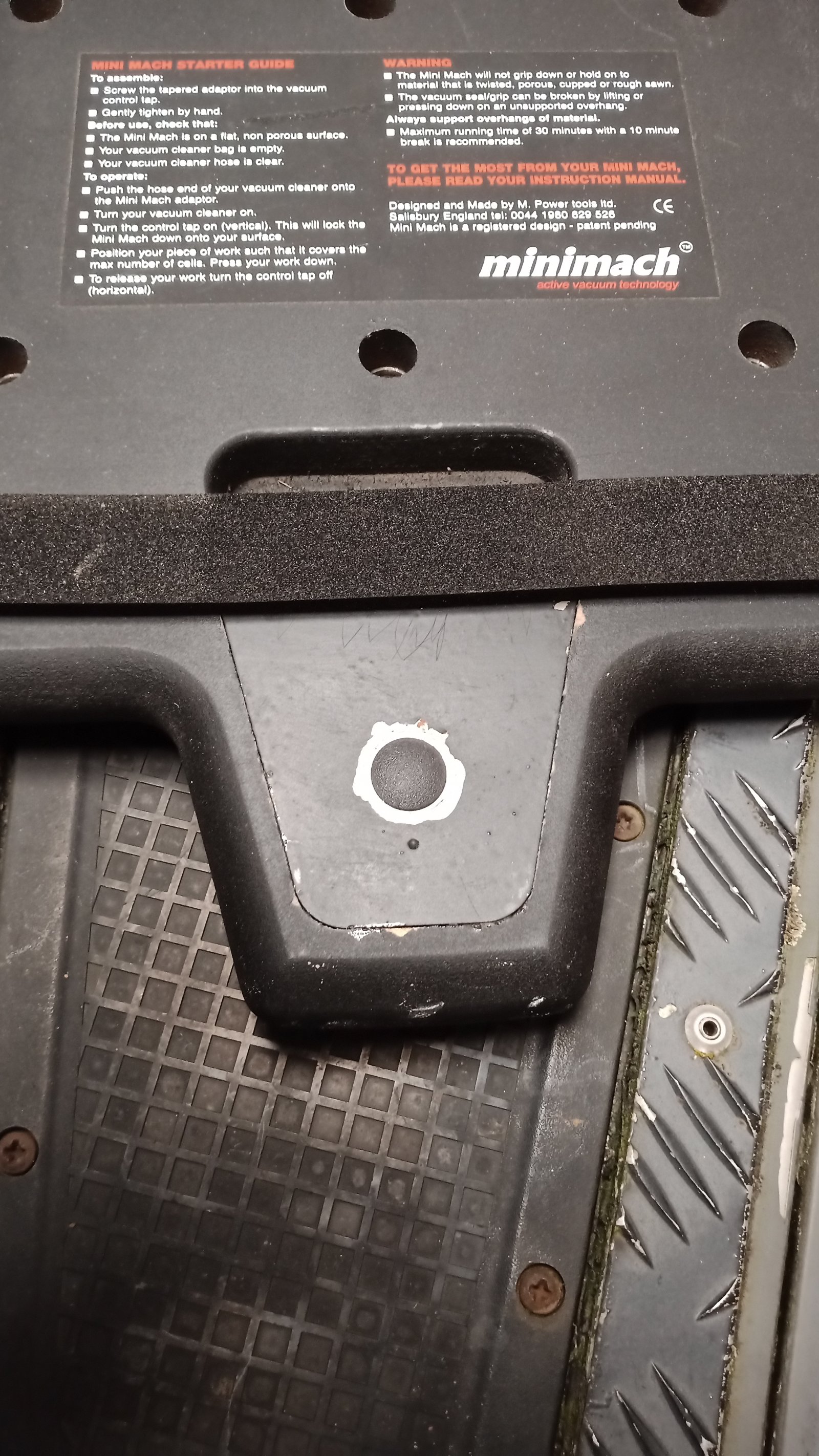

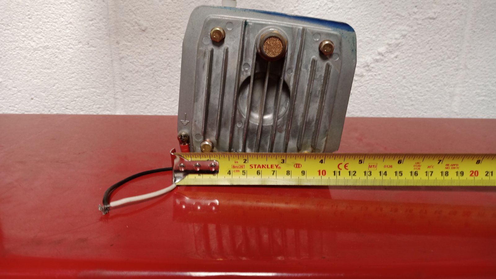

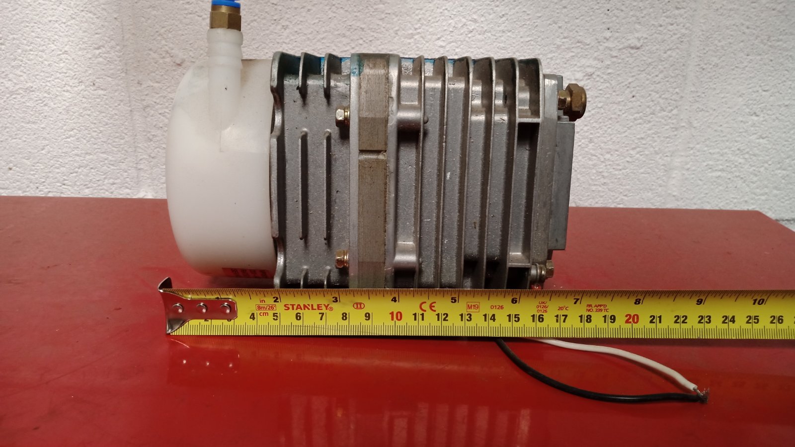

Some pics of the bed and the pump. If you look up the specs and try and get something along the same lines. The white plastic section on the pump houses a foam filter.
- IMG_20200413_162147_8.jpg (158.55 KiB) Viewed 34198 times
- IMG_20200413_162138_5.jpg (169.9 KiB) Viewed 34198 times
- IMG_20200413_162129_7.jpg (215.19 KiB) Viewed 34198 times
- IMG_20200413_162042_6.jpg (344.11 KiB) Viewed 34198 times
- IMG_20200413_161539_9.jpg (728.18 KiB) Viewed 34198 times
