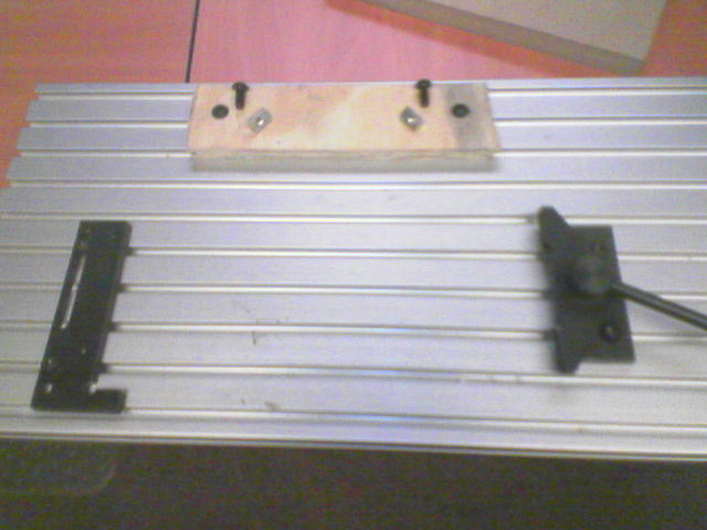

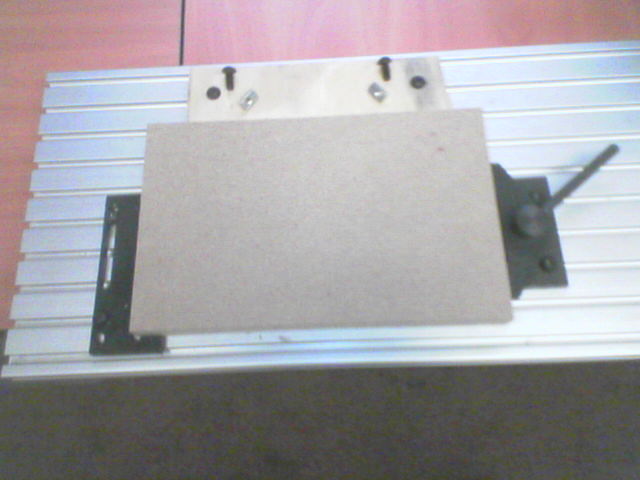

Post by boots » Tue 03 Apr , 2007 22:08 pm
Mount a stop block on the table with a couple of table t-nuts. Slot the holes in the piece for adjustment. You should be able to set the stop block in place and just loosen the the clamp to change pieces.
