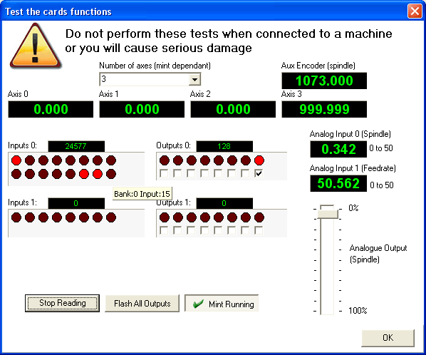

If the switch and wiring is fine, then I'm guessing that the home input has blown.
You can try the latest EasyUpgrader which now has I/O monitoring functions (you will have to email me to get the password)
That way you can connect a test button and wire straight to the Z home input and see if the button changes the input state.

Installed a new NextMove card - works great.
Installed original top card on new bottom card - same problem, Z will not home.
Installed new top card on original bottom card - machine works great.
Problem is in the top card, anyway to correct this?
Post by Steve » Tue 12 Jun , 2007 16:04 pm
Sounds like the input chip is shot :( It will require returning for repair.
