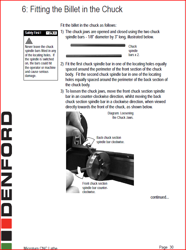

Just purchased the Micro Turn / Mill Pros, they both came with test parts already machined. Silly question how do you undo the chuck to remove part and add new stock? I can't see how to undo and their are no instructions.

The machine is supplied with 2x Tommy bars. these fit into the holes in the chuck to loosen the jaws.

On the software install menu there is an option to veiw or download the manual for the machine
