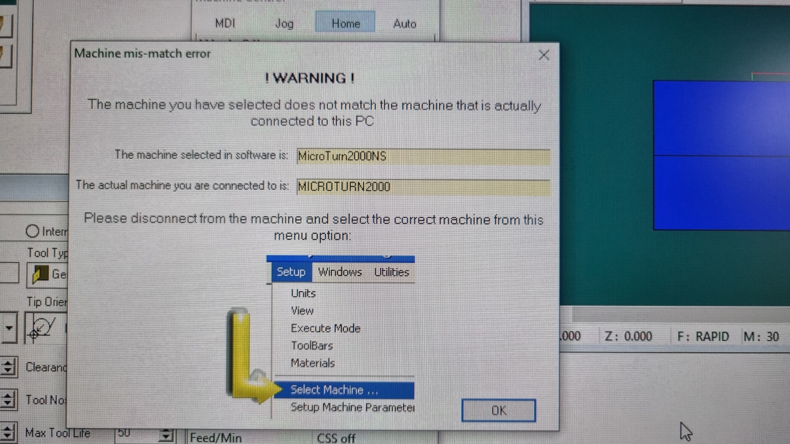

Hi everyone,

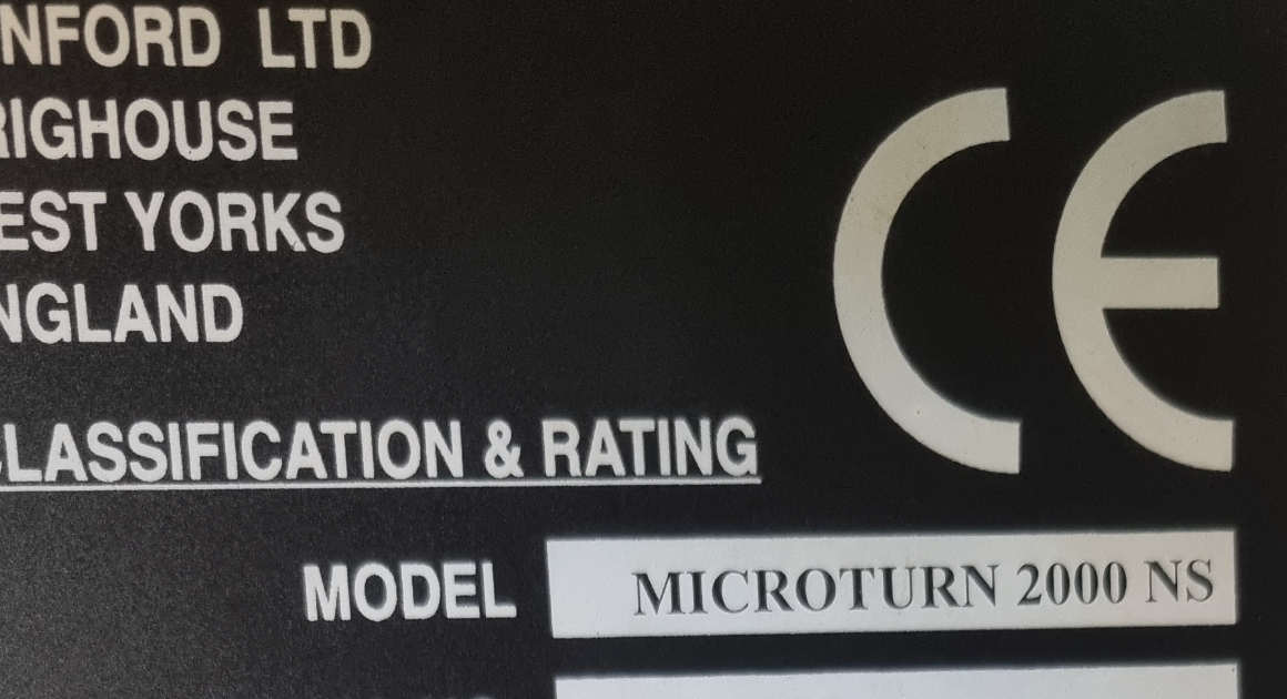

Just installed the latest version of VR cnc turning on windows 10 and I get the message Machine mis-match error and suggesting it is a Microturn 2000 instead of the Microturn 2000NS. everything seems to work fine its just annoying every time I start up I get the error. I did try to switch it to micro turn 2000 and it cannot communicate with the machine.
The badge on the machine suggests it is a Microturn 2000NS and the machine I have is usb.

You can change the Machine Type in Denford Easyupgrader.
You can install it from the VRTurning CD or download it from the Denford Website.
You will need to connect to the machine, Then Right click on the banner at the top. Then go in to Advanced (Password is Dave).
We used to set the Microturns to Unknown.

I have the same issue. Says mis-match! Novaturn should be Novaturn NS
When I do as Martin says, I do not have a Novaturn NS to choose from in the list of machines! Question is, will it be safe to set to unknown/special for my NS

Yes set it to Unknown/Special & it wont display the warning.
