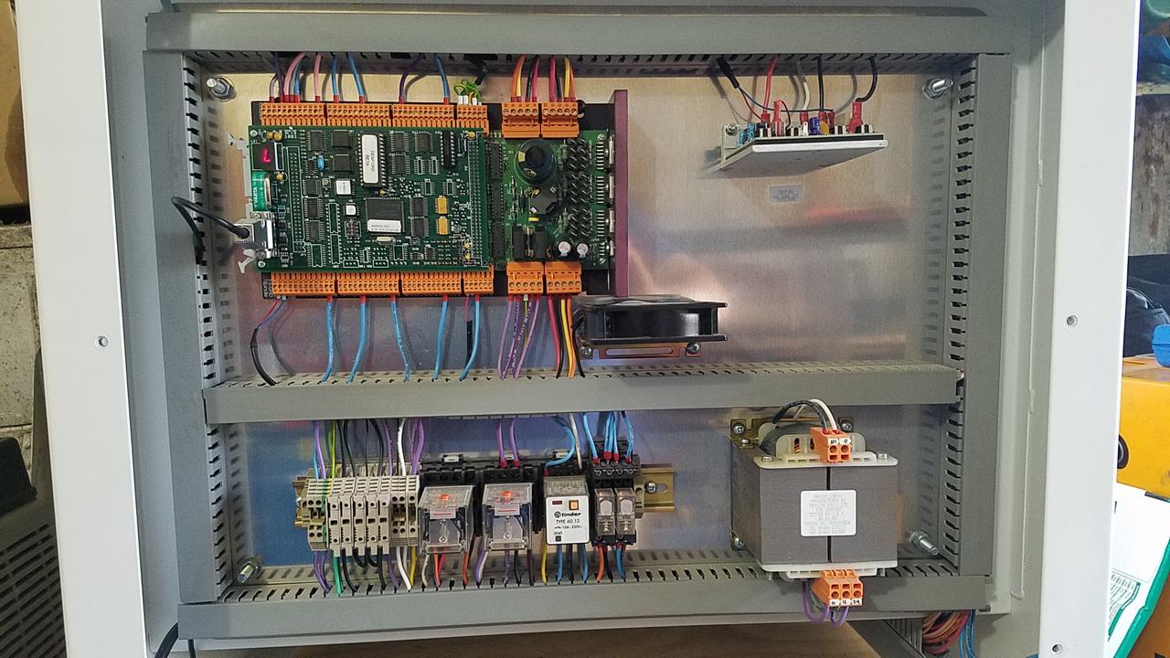

The problem, I think:

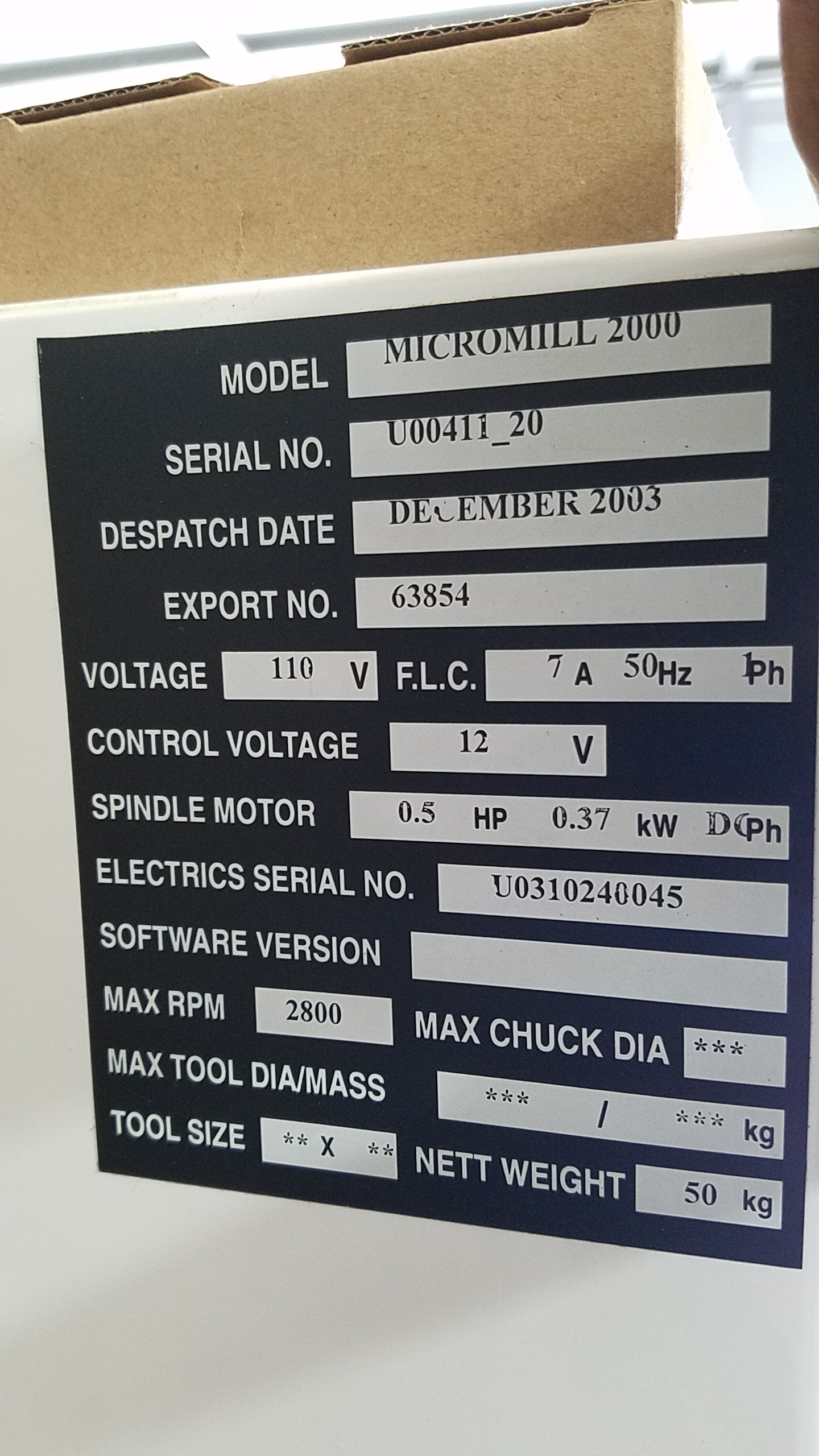

I unloaded the mill and plugged it in. (It has the original power key.)

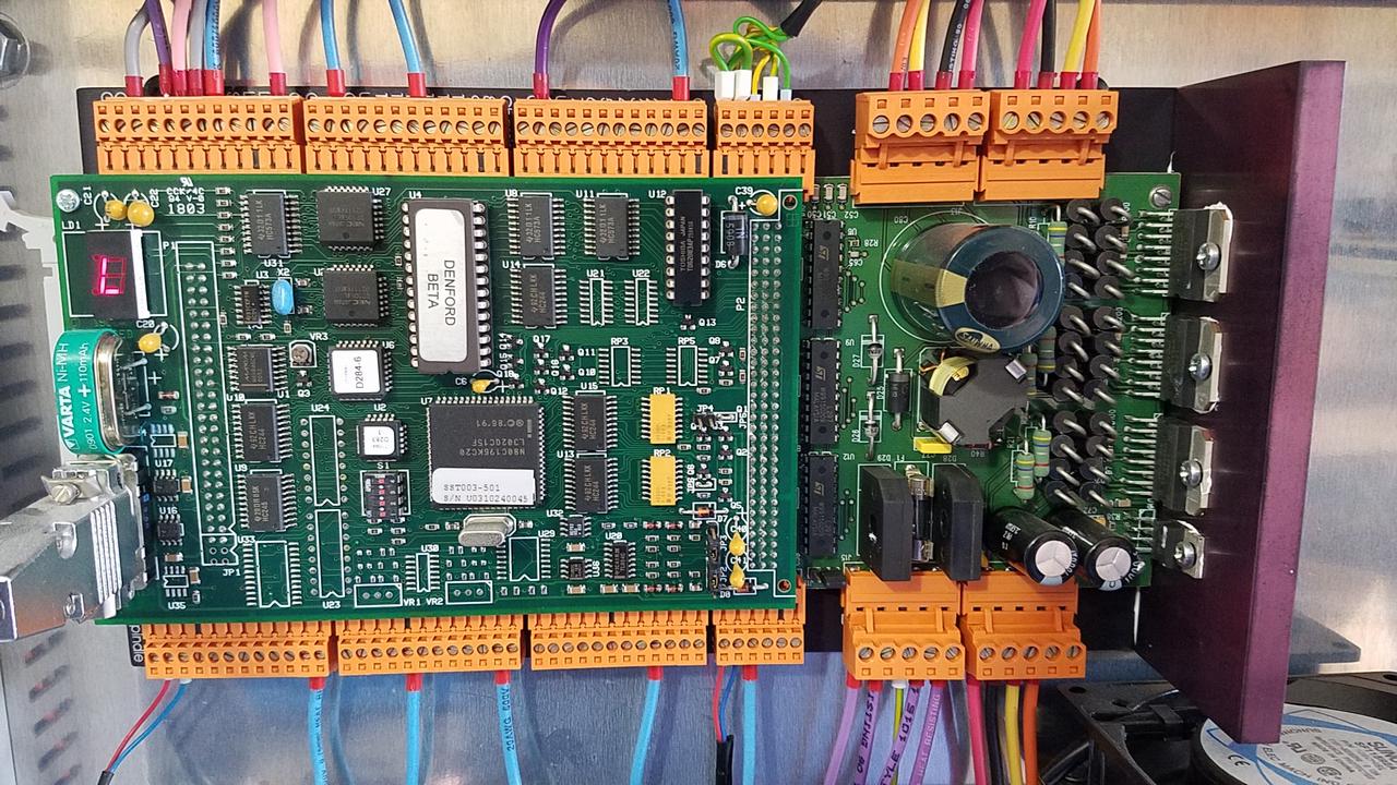

I took off the back cover.
The RED 7-segment-displat has a L and a flashing dot.
What does that mean?
The machine has all of the three axes approximately at the midpoint of the travel. None is on the limit switches. The switches feel fine mechanically.

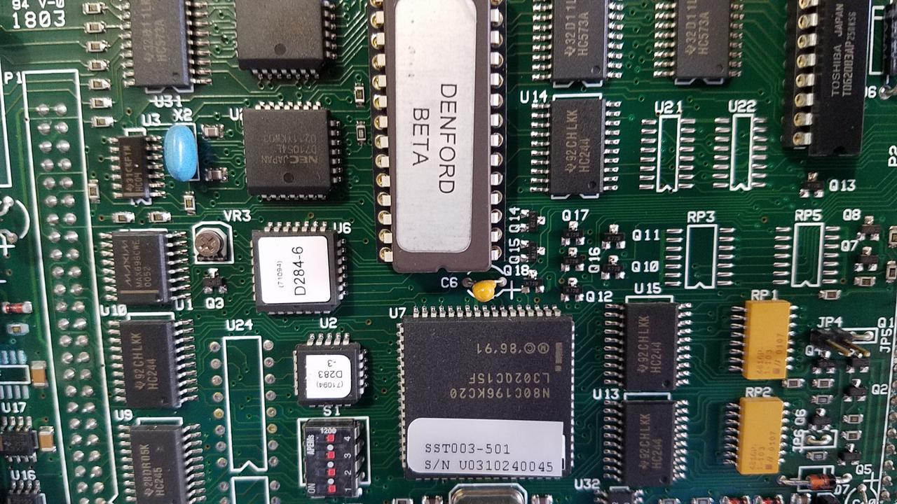

The S/N of the Denford Card on top of the main card is U0310240045
I have not hooked up a computer to it yet. I did successfully install and activate the software on the PC separately.
Can anyone help for what me next step (no pun intended) should be?

OK, so the L should mean LIMIT SWITCH OPEN per this.
viewtopic.php?f=54&t=3167
What should I check. What does that likely mean?
I hear a click of some sort when I open and close the door.
The led display does not change though.
I actuate the limit switches manually but no change to the led display either.
Re: I got a MicroMill and Microturn last week.
You need to connect the computer to the machine & then connect to the machine.
Neither machine will have any overtravels fitted. Just datum switches.

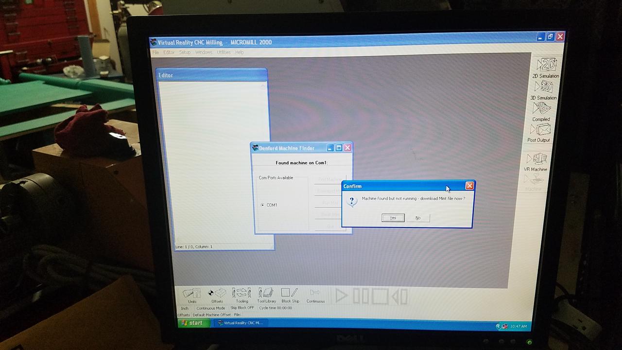

I hooked up the cable that came with it and nothing. I grabbed a null modem adapter from "the box" and It connected fine.
I will go back and confirm the pinout later. It was well after bed time.

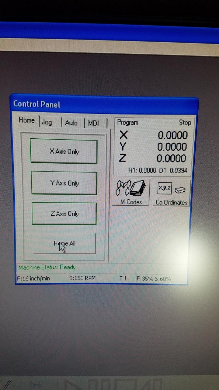

It homed.
It jogged in all axes.
The spindle turned on and off and responded to S codes to change speed.
I put it in auto mode and randomly picked a sample G-Code file from the software.
I proofread it a little to be sure there were no large Z axis moves that would crash the head.
The program initiated fine but ran into an overtravel. It was not a surprise because I have not learned how to operate the work offset or tool offset yet.
That comes next.

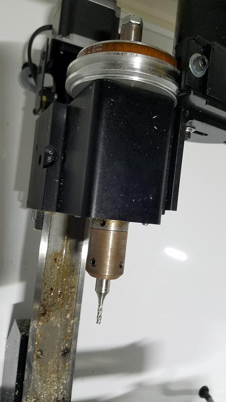

1. I got a scare when I first connected it. I thought the board had a problem.
2. The spindle seems to have the quick change tooling bushing to take a 0.375" shank endmill. This one was already in it and that is what it measured. Should there be a collet holder? Can I buy other bushings?

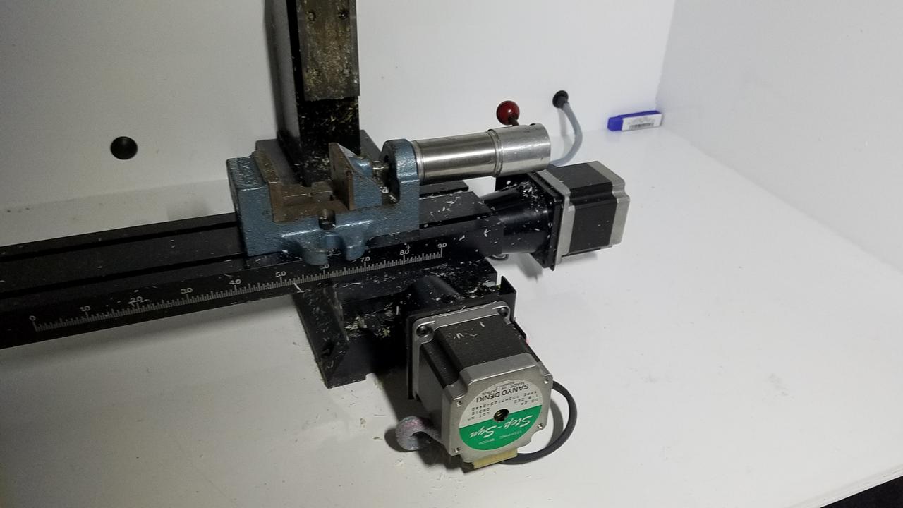

3. There is a little vise or clamp of some sort in it. I need to see how it works. It has some sort of fitting on it, perhaps for air.

- [size=150]I got a scare when I first connected it. I thought the board had a problem.[/size]

- [size=150]2. The spindle seems to have the quick change tooling bushing to take a 0.375" shank endmill. This one was already in it and that is what it measured. Should there be a collet holder? Can I buy other bushings?[/size]
- 20180821_071932.jpg (97.22 KiB) Viewed 30897 times
- [size=150]There is a little vise or clamp of some sort in it. I need to see how it works. It has some sort of fitting on it, perhaps for air.[/size]

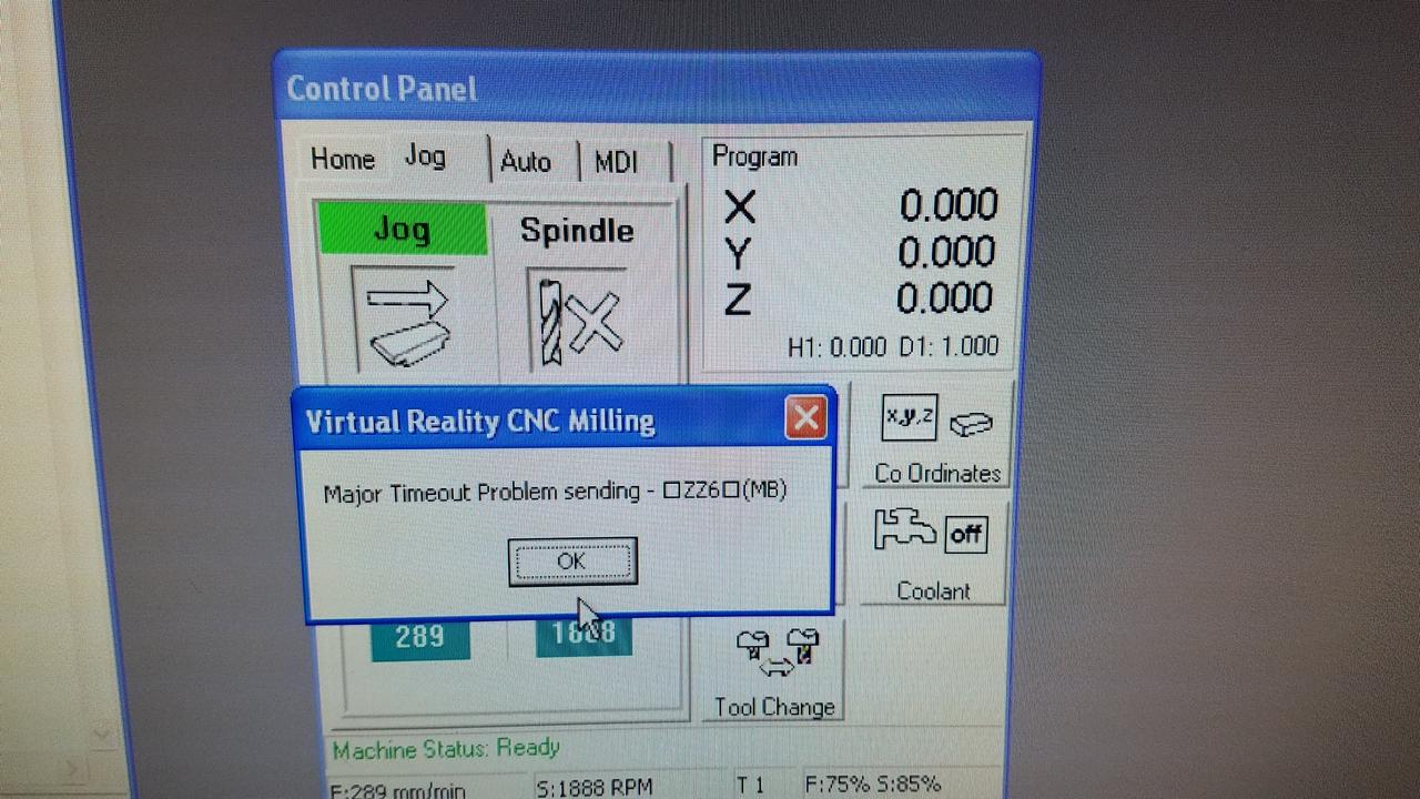

It stopped midway through the sample file Teddy.fnc while in Turbo Mode
It complained of a major timeout issue. (See picture.)
I unplugged and replugged the cable.
It mostly would not find the machine after that.
It did find it a while later.
It homed ok, but I could not jog it.
That was where I left it and went to bed.
What should I be looking at?
The PC is a Dell Dimension 4500 desktop machine with Windows XP SP2.
VR Milling Version is the 2.32 download from the forum.
1. Serial port in PC (any settings to turn off or on in the back end? (FIFO buffers maybe))
2. Serial cable looks perfect. (It was working fine with the null modem)
3. Does the top board need to be reseated to ensure a good connection to the Baldor board? (I figure it sat for years in a school storage building before I got it. )
4. Could I swap the board from the MicroTurn or MicroRouter that I have as a test?
5. Looking through the hole in the back cover, the RED Seven Segment LED had an 8 with no flashing dot.
6. Is there any other information I can provide to help diagnose the issue?

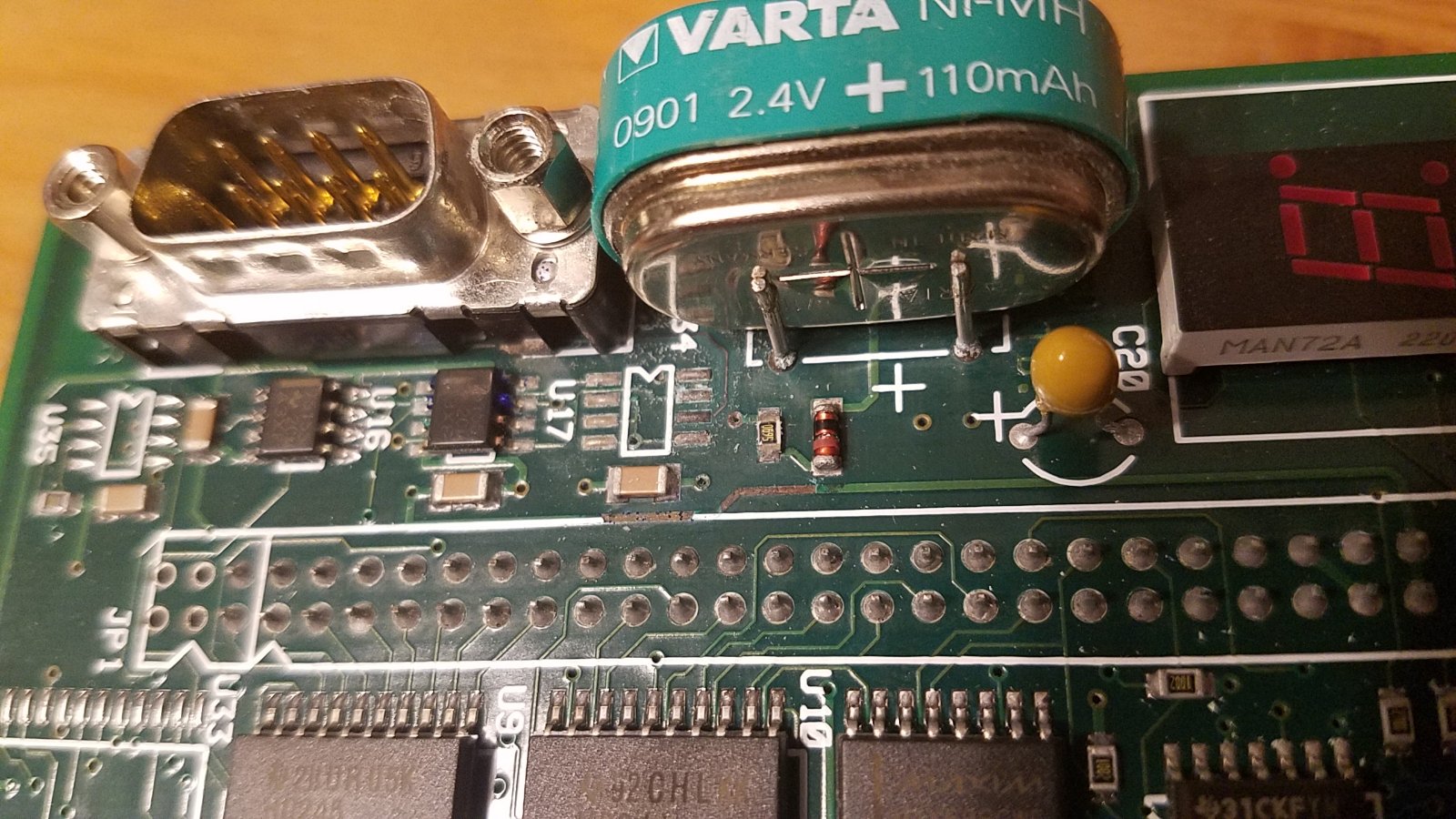

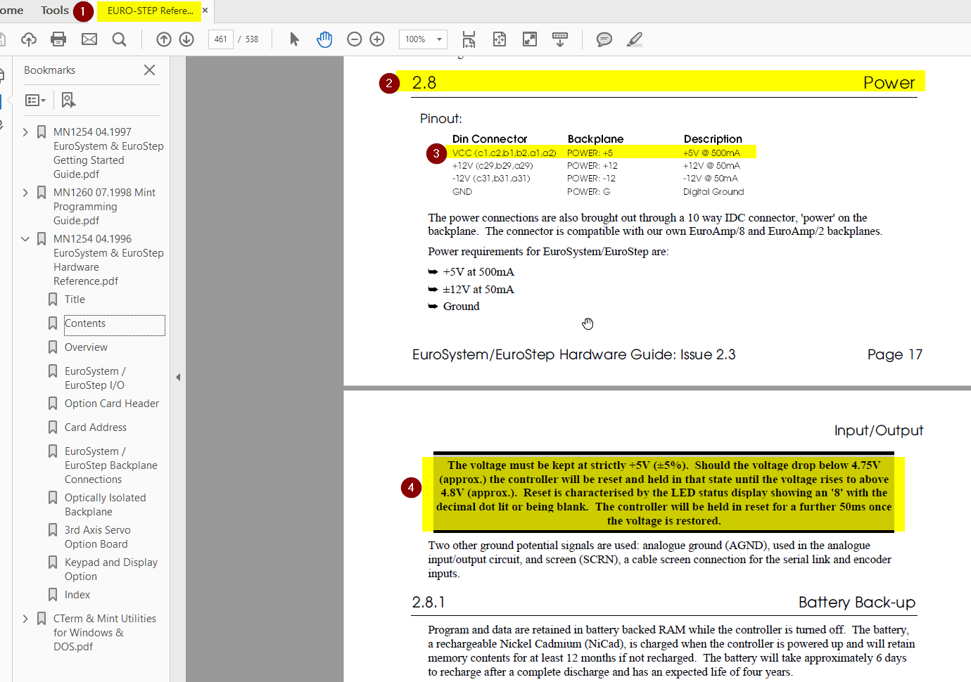

I have swapped cables and I believe the serial port on the PC is okay.
I have been reading the reference guide for the Euro Step cards.
The 8 on the red led display is a possible reset condition state.
One of the causes is not a steady 5 Volts to the card.
Does that sound right?
Where should I have the 5v?
Is there other places than the pins referenced in the image here?
I want to check that first before I consider swapping the card from the microturn.
Kevin
Kevin

CURRENT STATE:
When I power up the machine, the segment display shows an 8.
Now it will not connect to the machine. It tries to initialize and fails with a picture and a message to check that the machine is powered on and the Serial cable connected.
I had removed the top board to clean it. I noticed some discoloration near the battery now that was not there when I took the original pictures above. See this pic below.
Is the board damaged?
If so, Is there a repair service?
Is this the likely source of my trouble? These areas:
attachment=1]20181211_200903.jpg[/attachment]
What I tried tonight:
I decoupled the steppers and limit switches just to make sure the screws would turn freely.(I was thinking maybe a screw that would not turn freely cooked the board in some way.)
I swapped the top board (only) from the Microturn but that does not even light up the seven segment LED.
I swapped the MINT chip between the two top boards and tried again. The Microturn board remained dead.
What should I do?
Is there something specific to ckeck?
Should I look for a board?
Thanks,
Kevin[

- kk2018-12-11 20_33_06-20181211_200903.jpg (213.25 KiB) Viewed 30718 times
