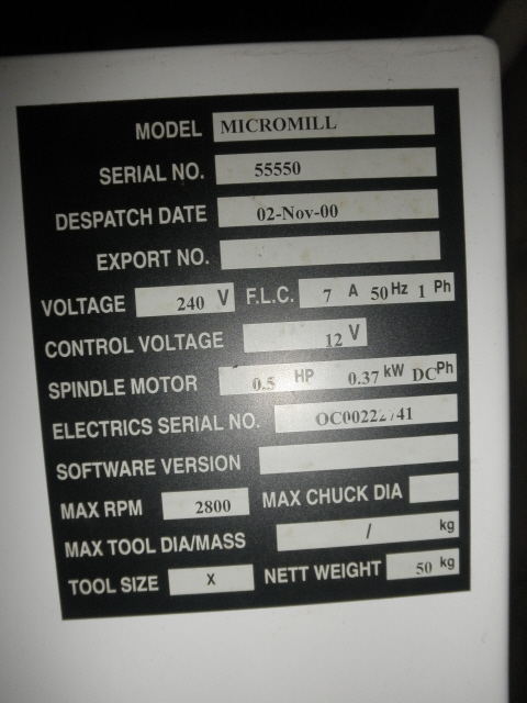

I have an opportunity to get a used scanmill but I live in the US and I see on the spec tag that it supposed to run on 50 Hz but in the US we have 60 Hz, will this be ok?
mini mill 015.jpg (133 KiB) Viewed 14237 times

The machine will run on 50 or 60 Hz
Note it runs off an RS232 cable so you need a pc that has one or a USB to serial cable.
You also need to make sure you have software or you have to buy this.
