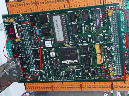

Thank you so much for getting back to me. This is the card that I have, and its showing .L
The issue is weird and the unit will usually start up, but right now it can take a very long time, and may not start at all.
There seems some muck around where the battery is, I am not sure what the function of the battery is?
Really appreciate you getting back to me. I have a project I am working on now, and its really causing me some problems.
David.
Image of the card. it is actually showing ".L"
The problem is intermittent and it does usually come on eventually...

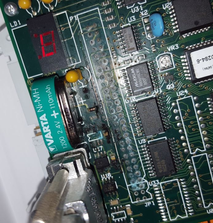

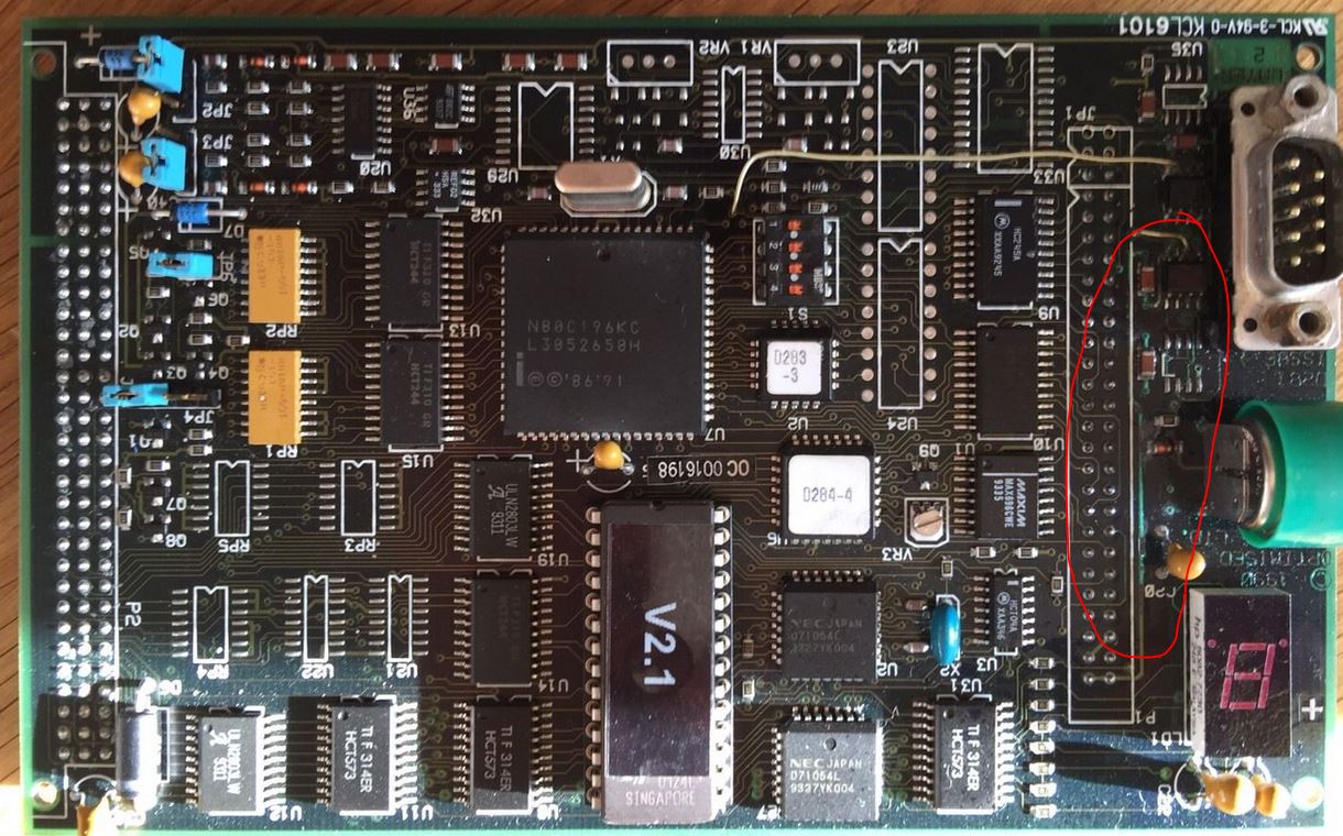

I show a close up of around the battery, and also the back of the connections to the base board... Its seems to me both look corroded... Not sure why at the board end... Different solder?
Anyway, would really welcome your thoughts, and also your thoughts on what is the best way forwards? A repair, A second hand board? A different board all together?
If I can get this working reliably it will be fantastic.
Image near battery and also pins soldered on the right hand of the board to connect to the back board.
Close up near battery
Re: Micromill is going to kill me!
Post by Martin » Wed 13 Jul , 2016 15:38 pm
It does look bad around the battery area.

Looking at that I would guess the battery has had a leak as it would appear that there could be corrosion It's that or it could be some form of water/moisture/condensation damage. They used to use those batteries in PC's 'back in the day' before moving onto coin cells. You could try some IPA (not beer) Isopropanol Alcohol and an old tooth brush to clean it up. It's what we did on PC's and Carphones (showing age) which showed these signs.
I don't know if you can just replace the battery and if you did if any setting would need redoing.
I have had issues with some of the Micromills which were down to dry joints on the connectors. Quick to fix once found.
Post by Steve » Tue 19 Jul , 2016 14:31 pm
I would try replacing the battery and see if its any better.
follow the attached post and remove the top card
viewtopic.php?f=54&t=2562
The battery is available from RS Stock No.422-371 Brand Varta Mfr. Part No.5561560294
You may need to use workbench to set up the card again but it may be OK.

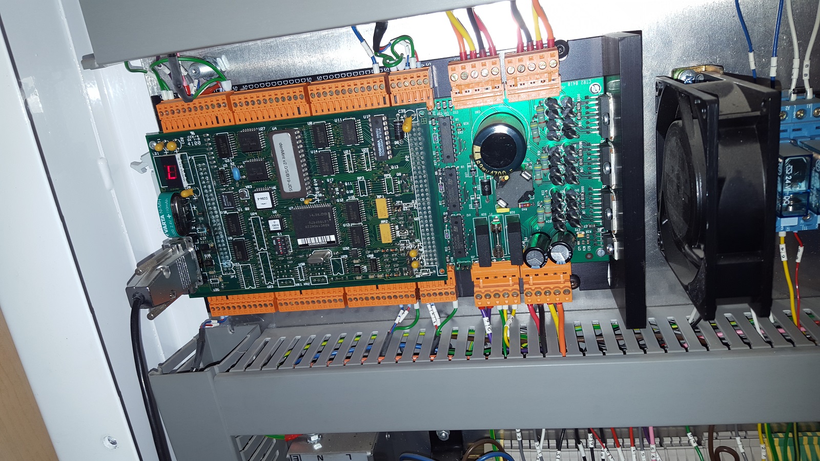

Could anyone help me and let me know if the card in the attached image could be used to replace the corroded card I am removing shown above????
Denford Card.JPG (217.87 KiB) Viewed 41166 times
Post by Steve » Mon 01 May , 2017 20:10 pm
Hi. When you say you are struggling to go online. Does the computer find the machine and download the flash? Or does it come up with the message to check the power and USB connection.
If this is the case it sounds like the machine is communicating but it may be an issue with the ratio.
Can you detail exactly what you men by hearing the click. Is this after connecting to the machine?
Post by Martin » Tue 02 May , 2017 12:35 pm
Yes the cards are the same however you will need to swap the eproms over.

Post by davejfowler » Fri 05 May , 2017 13:06 pm
Have now recieved the replacement card. All looks well, but the battery seems to just have started to corrode. I have also noticed that the board does not seem to have any printed connecttions to the -ve side of the cell. I wonder, is it possible to cut and remove the battery terminals with no ill effects to the operations?
