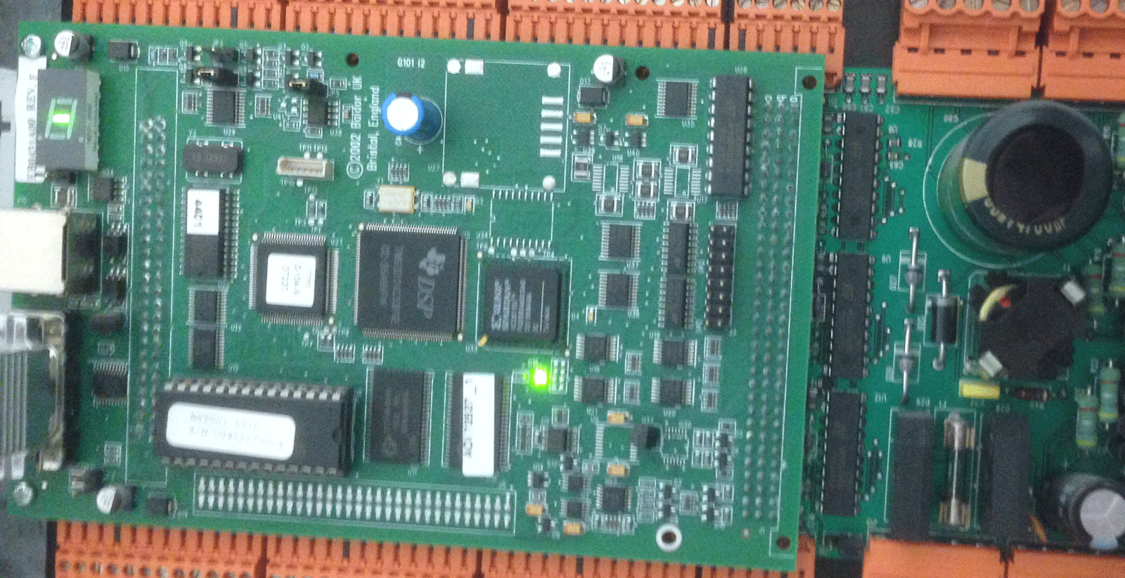

Okay, can someone tell me if anything appears wrong with the board? I'm using an rs232 connection. connecting to my computers printer port (25 pin). Neither Mach3 or VR turning V1.15 get a response. Vr Turning keeps saying can't find lathe, or can't connect to lathe. Is there something I did wrong during software installation? All I did was install the software, made a microturn 2000NS profile and started the program. I did nothing else, and I'm wondering is there something else I should have done. Also what does the dash mean on the 7 segment display mean, does that mean everything is operational?
The green LED towards the bottom right you can see is flashing on/off

What cable are you using to connect? You should be using a pin to pin cable direct to the com port on the computer. As far as I know Mac will not connect directly to the Baldor control card.

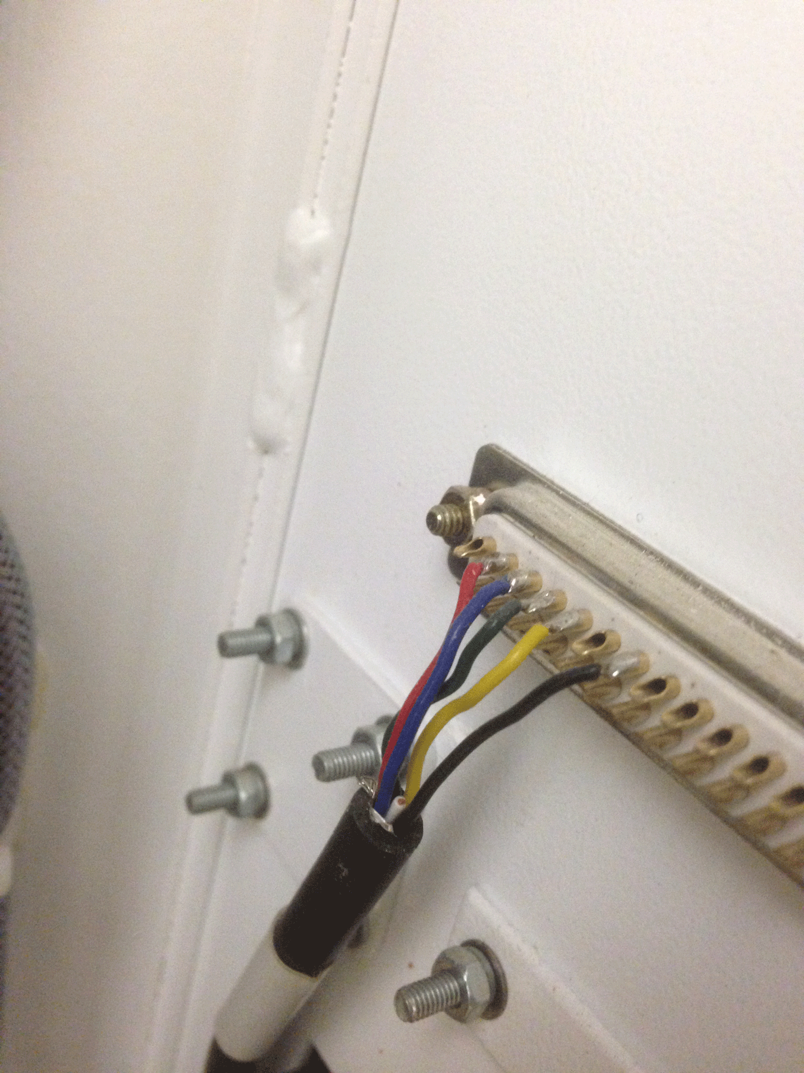

Yes. The next step card has an output port as a 9 pin connector. The connector goes down to the side of the lathe and attatches to the 25 pin connector (As shown here)
The 9 pin cable comes from the board and connects here

You need to connect it to the serial port then & not the printer port.

oh, so I would need to get a 25 pin to 9 pin converter?
So that I could connect it to the serial port?
Re: Help with Microturn 2000NS (2005 2000NS)
Post by Martin » Sun 23 Feb , 2014 22:06 pm
Yes. Just a standard converter.
