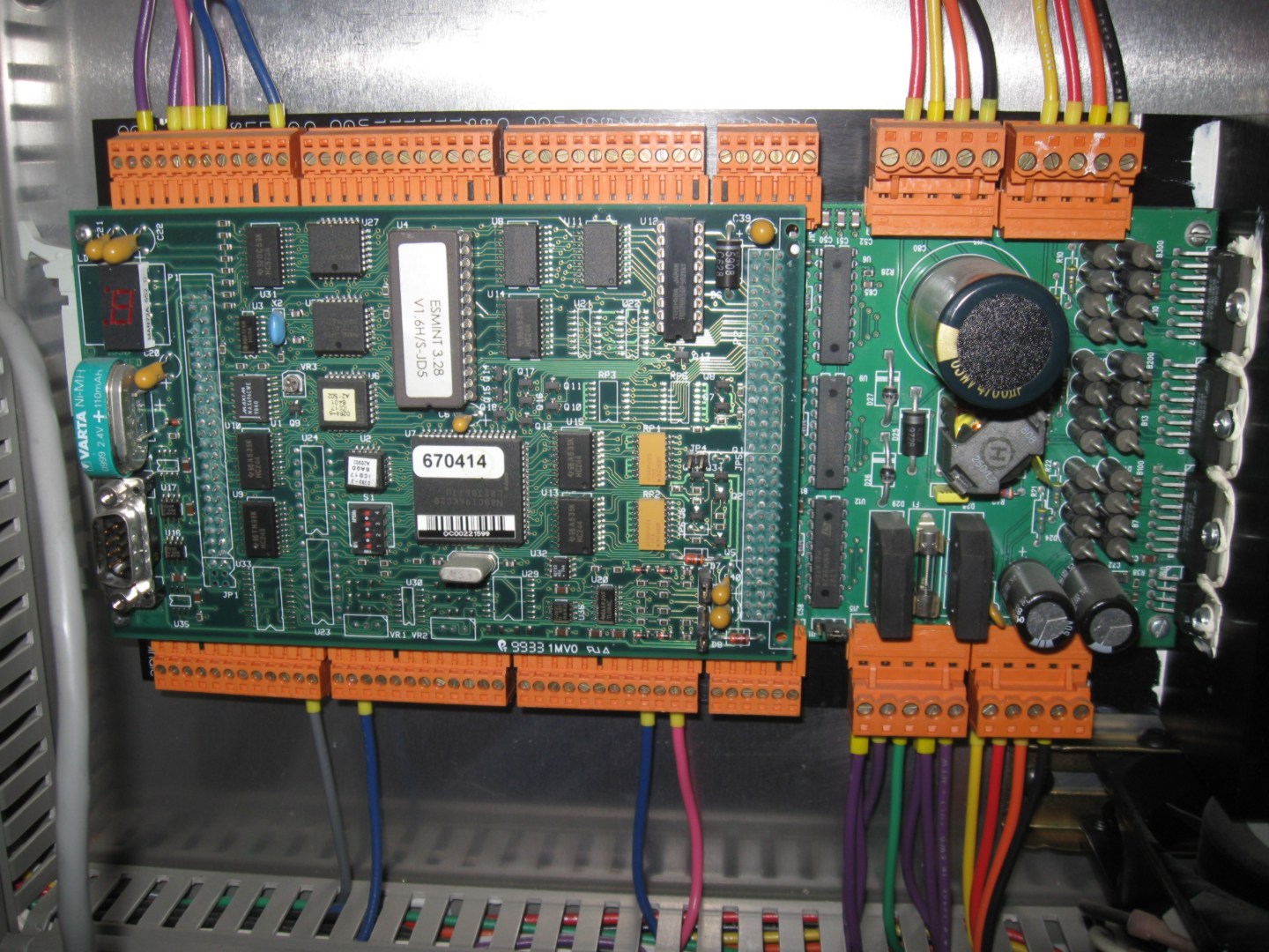

Not sure what I have is called, but here's a picture.
Did not get any flicker at all from the 7 segment LED when powering up or powering down.
- IMG_6379a.jpg (388.21 KiB) Viewed 20035 times

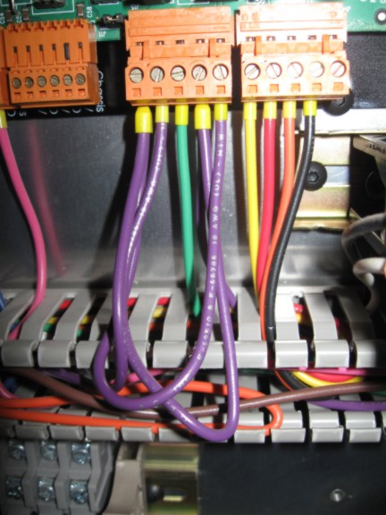

Re: New Owner Mint3.28 hang up
I measure 28VAC on the power in connector both between pins 1 & 2 and between pins 4 & 5. (The link showed that 4 & 5 should be DC voltage, I hvae 0 volts DC between 4 & 5. ????
Which, if I would have taken off the cable trough cover, I would have seen that pins 1 and 2 are jumpered to pins 4 and 5, thus the same voltage.

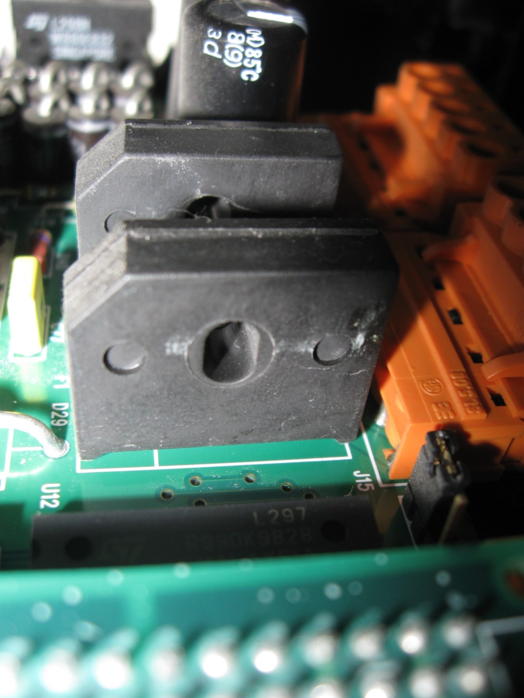

From what I've seen, it's looking like the two big rectifiers on the Baldor board are fried.
Would like to verify, but I think the KBU8D rectifiers are pretty much toasted, as I dont have +5 +12 -12 volts.

Got the Baldor board out, easier than I thought
From what I'm piecing together, the Spindle drive is a small pc board that sits above the transformer.
Looks like there is a jumper (blue wire) between TB1-6 and TB1-2 (Stop and Grnd)
Looks like I have some type of mutation between smartstep and next step.

Looks more like a Denstep, with 24VAC supplied for both drives and logic.
And from looking at the Denstep schematic, looks like the E stop cuts power to the Xformer
I have 24VAC, so it's not a bad E stop button.

Removed the bridge rectifiers, but they test good,,,
What's the most likely issue pulling the +12 and +5 volts down?
What could pull both voltages down?
