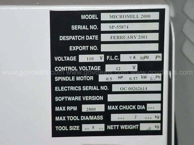

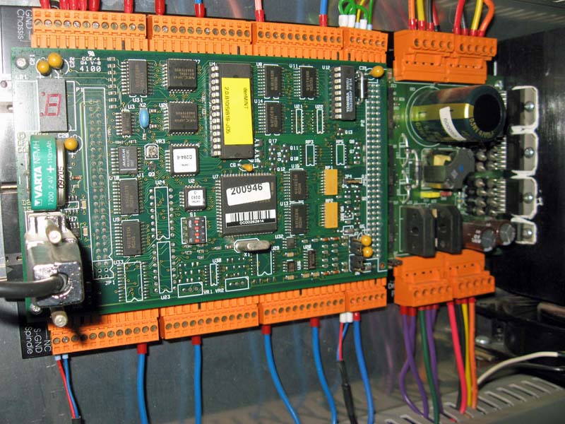

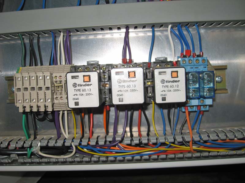

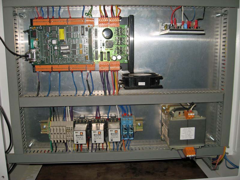

Here are photos of the data plate, electronics panel, and close-ups of the 5 relays and controller.
Speed controller appears to be a KB Electronics.
MicroMill 2000 Controller

MicroMill Data Plate
MicroMill Relays, Terminals, and Fuses
Electronics Panel

Please take a look at the photos of the electronics panel in my MicroMill 2000.
Note that there are 5 relays, not 3 as in the drawings you recommended and that the spindle speed is controlled from the DenStep and not from the front panel mounted pot.

Re: Which MicroMill 2000 Wiring Diagrams?
Post by Denford Admin » Wed 14 Nov , 2012 10:39 am
Sorry but I can't find any drawings which match your machine...it could be a development or test machine which would have been documented in the USA office (now closed)
I've added all I could find to this post:
viewtopic.php?f=36&t=2929
