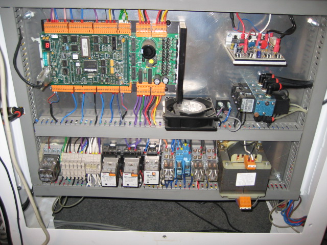

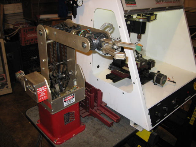

I have a Micromill 2000 interfaced with an AMATROL Pegasus robot.
I am working to put the system back in working condition.
The students have pulled the wires that interface to the front pannel of the robot controlled.
There is a pneumatic cylnder configured to feed blank parts and the robot insert blanks and remove milled parts.
Does anybody have a system with this configuration?
If so I really need the wiring configuration for the 2 wires that to to the controller input,
and the 10 wires that come from the controller output.
Pic 2 is the robot and mill
Pic 1 is the modified electronics of the mill.
Thanks :3D:

Hooray!
I got the system running.
I traced down the extra interface connections and found they were integrated into the E-Stop and various "STOP" functions.
They all were normally open so when I removed the external plug going to the robot controller the mill completely responds to VR Milling.
