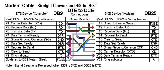

There were 2 types of RS232 communication for Micromills and Microturns
1. The UK ver (Although I believe some US specification Micromills and Microturns were sold in the UK
) had the RS232 cable wiring in the external cable, this was known as a MACHINE LINK CABLE (Pt No 9-25 machine link cable (RS232) BI01812GG)
viewtopic.php?f=4&t=2352&hilit=BI01812GG
viewtopic.php?f=4&t=765
2. The US version had the RS232 cable wiring in the internal cable of the machine and was connected externally to the PC with a Simple Straight Through Cable i.e. pin to pin
Internal Machine cable details
UK Pt No BI01812A
9 Pin_______________25 Pin
Pin 3 -------Blue-------- Pin 2
Pin 2 -------Red--------- Pin 3
Pin 7 ------Yellow------ Pin 4
Pin 8 ------Green------- Pin 5
Pin 5 ------Black------- Pin 7
Internal cable details
US Pt No BI01812B
Pin 2 -------Red-------- Pin 2
Pin 3 -------Blue------- Pin 3
Pin 8 ------Green------ Pin 4
Pin 7 ------Yellow----- Pin 5
Micromill / Microturn. PC (9 Pin) to Machine (25 Pin) connection cable details
- Modem Cable Micromill - Microturn - extrenal - 9 -25.JPG (49.66 KiB) Viewed 5315 times
