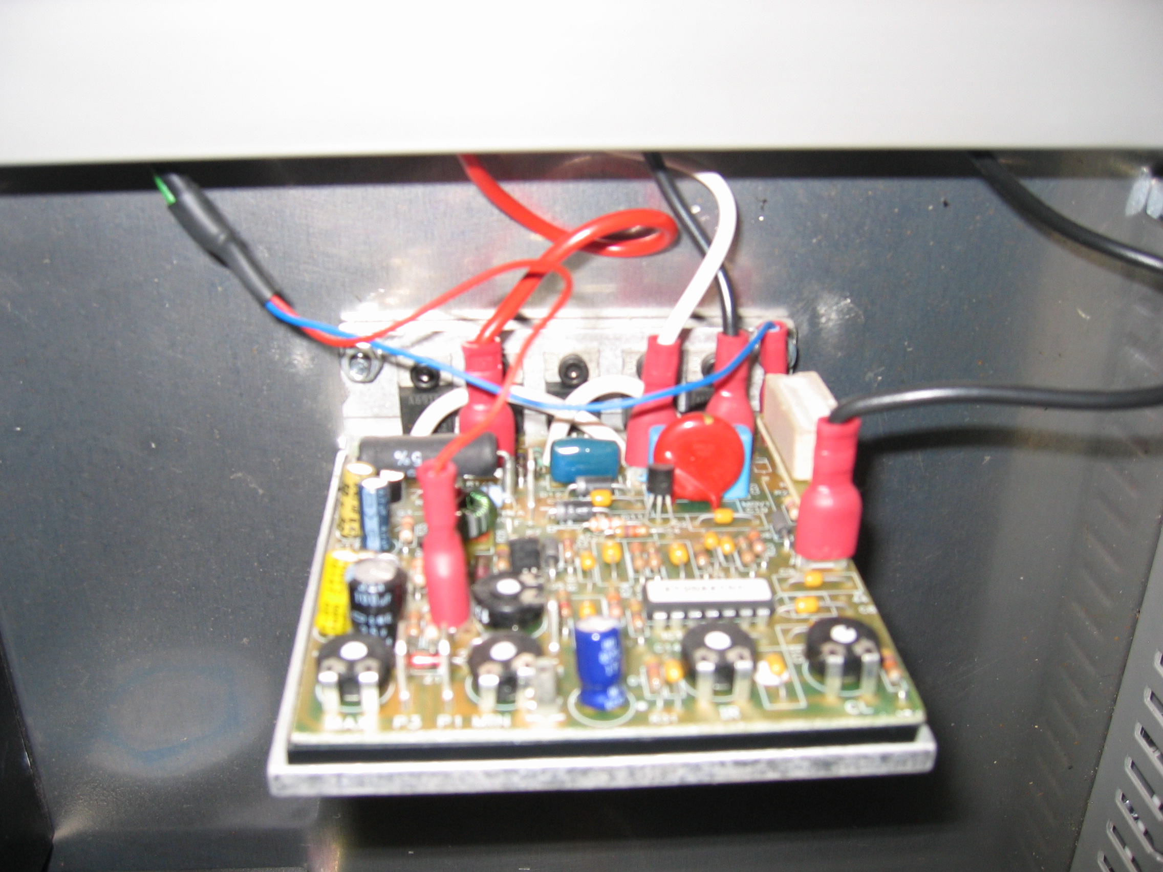

I have a 2002 Micromill 2000, and I need to know who makes the spindle drive card, so I can get a wiring diagram for it. Thanks

The spindle drive is made by KB electronics.
I attach a spindle drive PDF. The drive number is not identical but the one you have has a different number as it is an OEM product.
