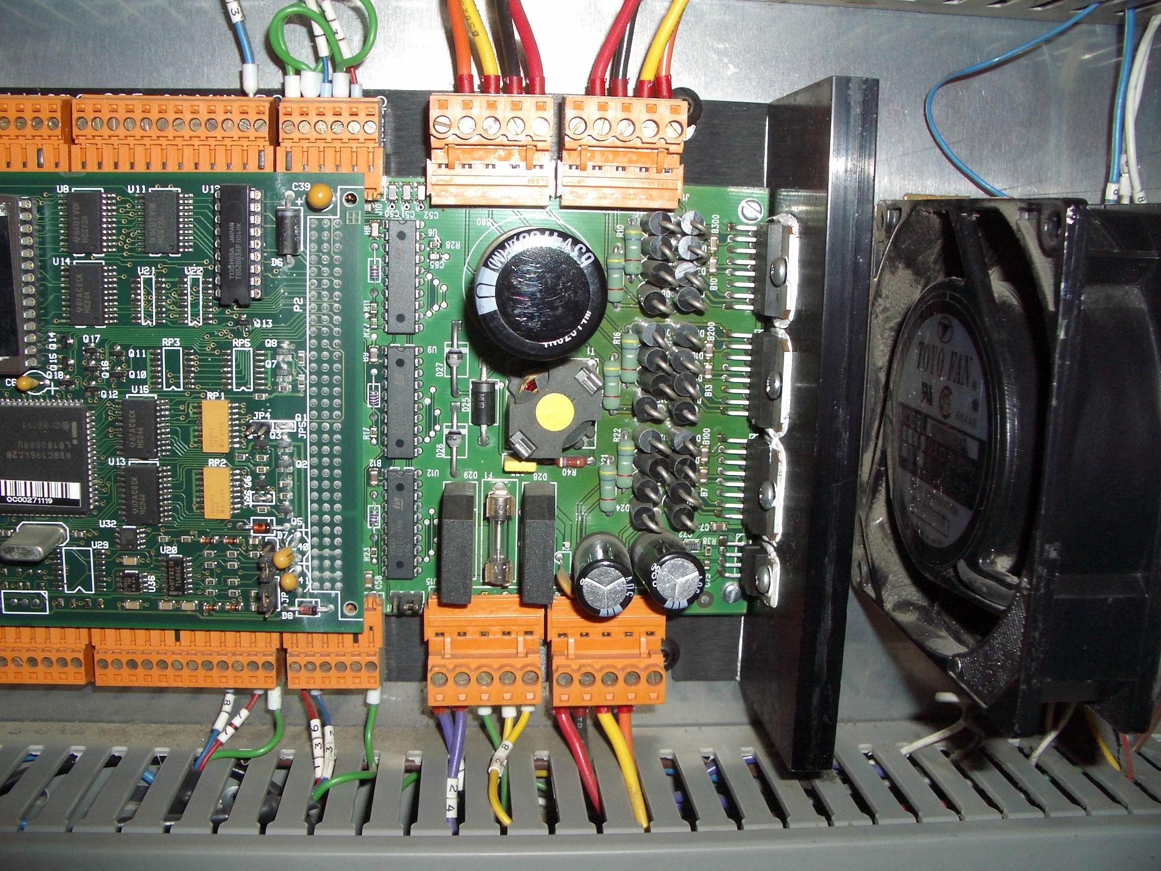

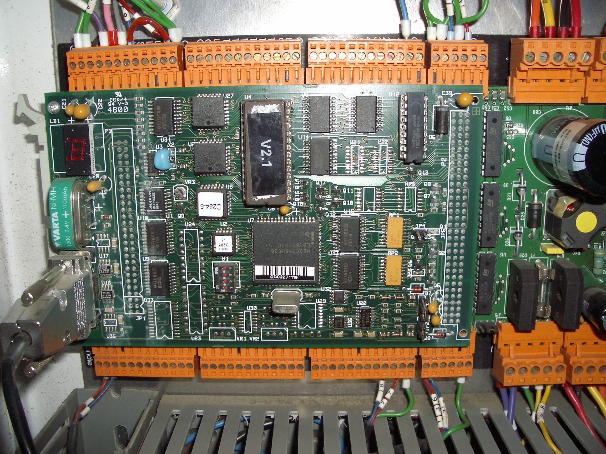

Controller
Here is pics of controller... I noticed there are just 3 driver chips !
Also the step motor wire colour is not the same on the circuit.

Hi Chris,
After looking at your pictures & a Denstep card in our factory, it does not support the 4th axis. I have confirmed this with Technical.
Sorry for getting your hopes up.
You can still fit the Aux`s though.
The other option is to upgrade to the USB Next Step top card with VRMilling ver 5.
Regards Martin
Regards Martin

Hi - as Martin says, you wont be able to get hold of the 4th axis step/direction signal because the top board doesn't have the IDC header which we currently use to drive a 4th stepper drive.
