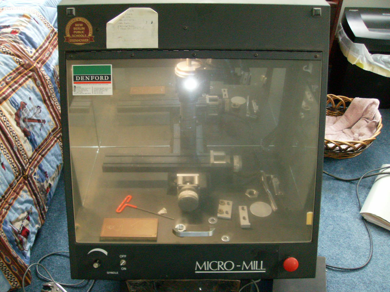

Since my machine doesnt have a serial number that i can see i included two photos. Can you tell me if this machine will run on your windows software? I notice the screen on the Denford rs232 communicator goes pink when i shut off the machine so i believe it has communication.

- SANY0002.JPG (244.87 KiB) Viewed 8085 times

It appears from the exterior of the machine you may have a standard micromill using DOS based control software. We no longer sell or support the DOS based control software. You may download any of our DOS based software for free from our website
