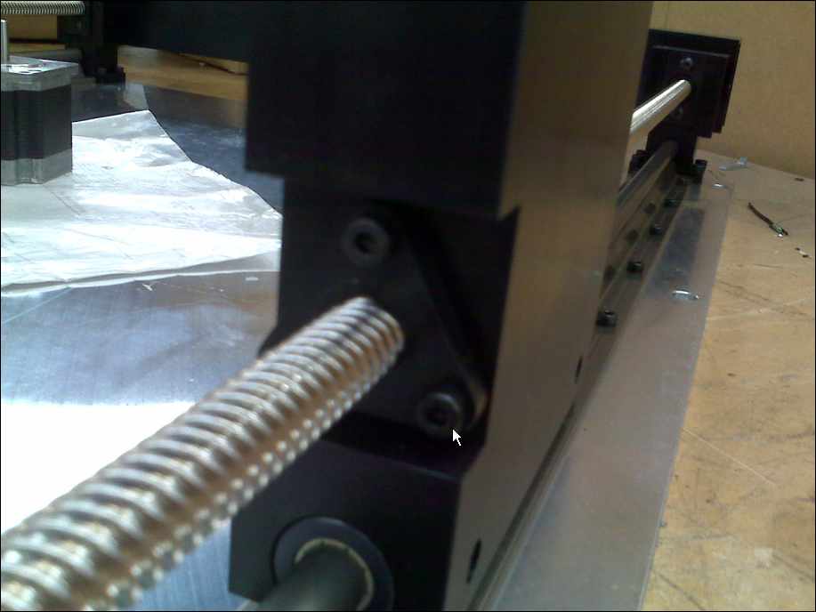

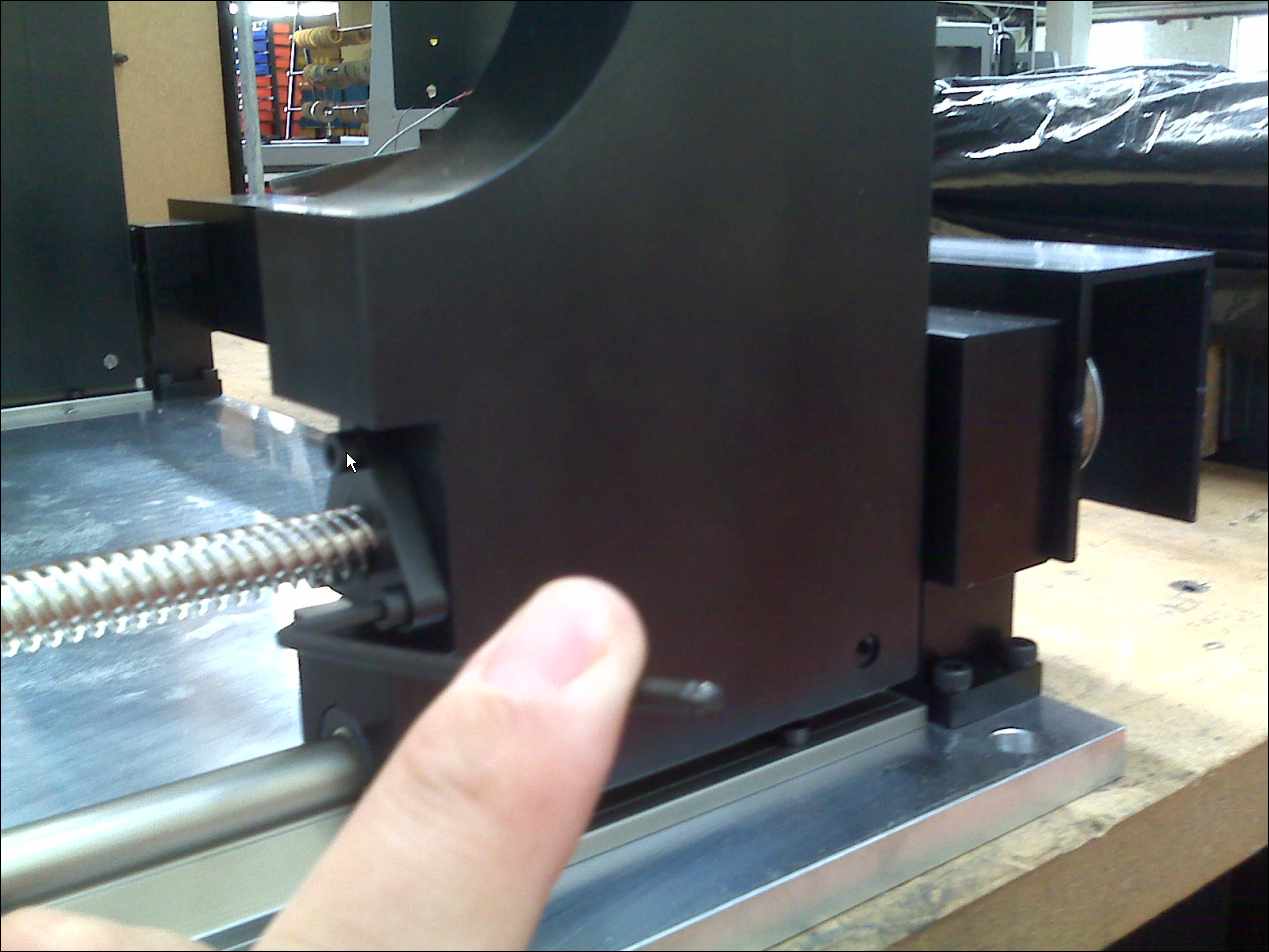

Now remove the screws that mount the nuts to the Pillars. You should then be able to push the beam away from the nuts.
The nuts will be visible as in the photo below. Clear out all the dust from the nuts and pillars with an airline.
Check that the slide moves freely on the rails without the nuts connected especially at the home end of traverse where you have had the problems.
Reassembly is important because doing it incorrectly could cause the problems you describe. I will describe after the photos.
- x axis nut fixings.jpg (34.77 KiB) Viewed 7163 times
- nut out of machine.jpg (37.03 KiB) Viewed 7163 times

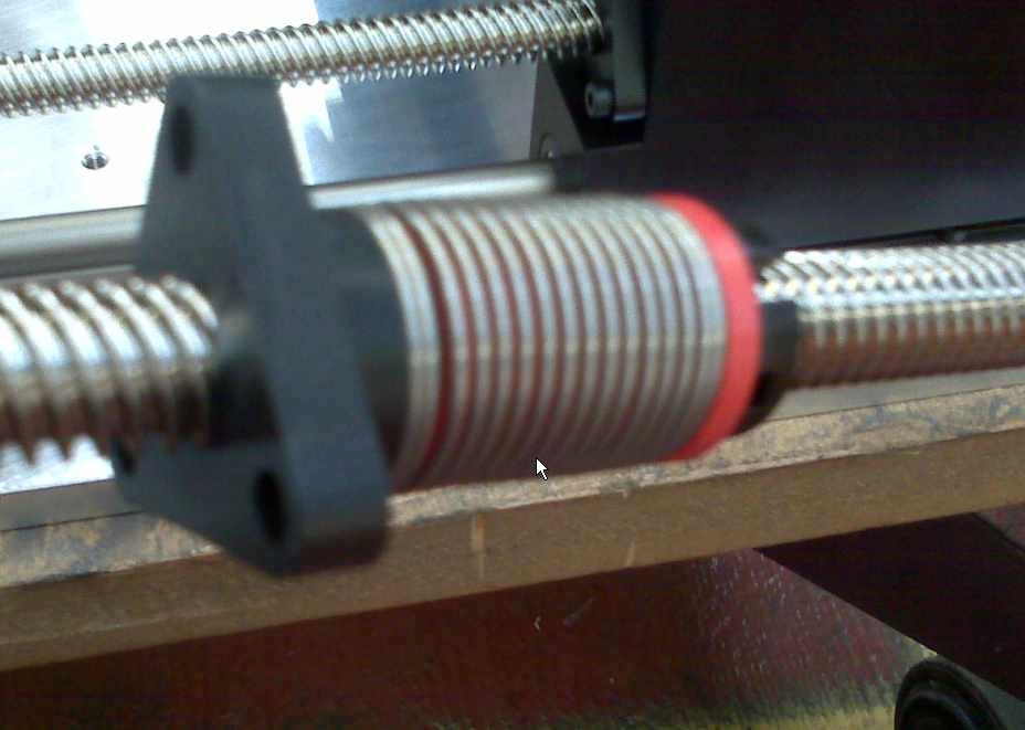

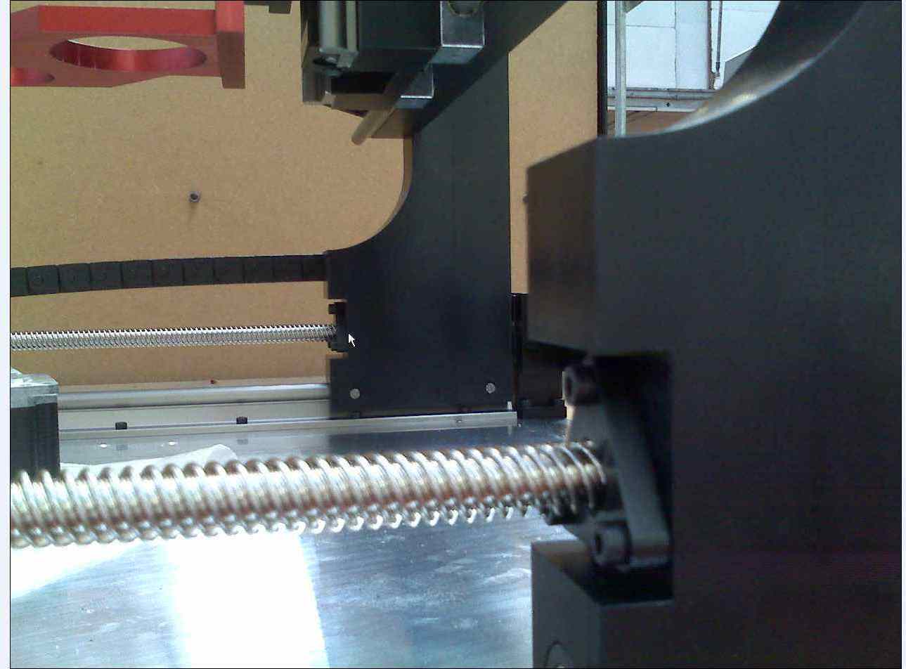

Another couple of Photos.
One shows the beam at the end of travel which is where it should be when you secure the nut with the 3 screws.
The other looking across the machine shows both nuts secure.
If the nuts are fitted correctly if you loosen the 3 mounting screws on both the flange of the nut should stay flush to the towers. If one of the nuts springs away then it could be incorrectly fitted.
- nuts secured in home position.jpg (62.44 KiB) Viewed 7156 times
- tighten nut at home end of travel.jpg (66.42 KiB) Viewed 7156 times
