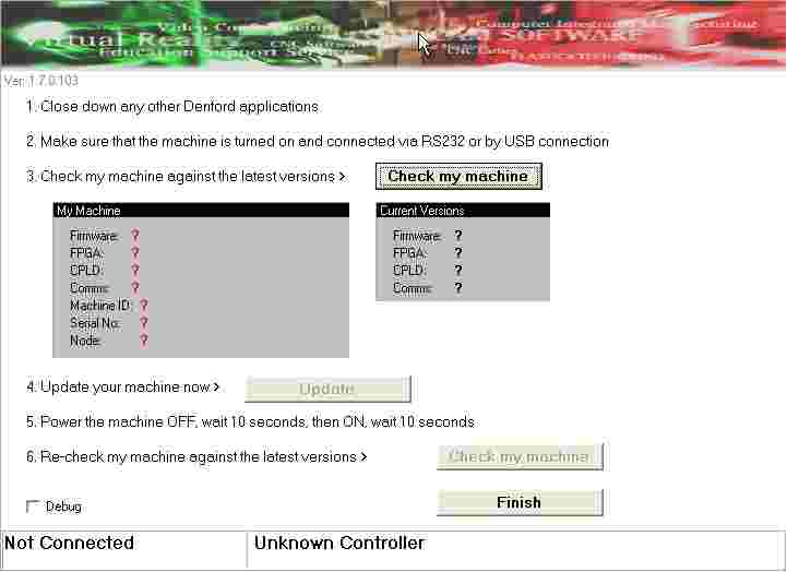

Open the easy upgrader software.
From the opening window move your mouse over the top of the red and green banner at the top of the screen shown in screen 1 and double click.
You will now get a new window open that allows you to try and force a firmware update.
If the firmware updates successfully then the machine should now connect correctly and all is OK.
If it is still unable to communicate then you will require a replacement card.

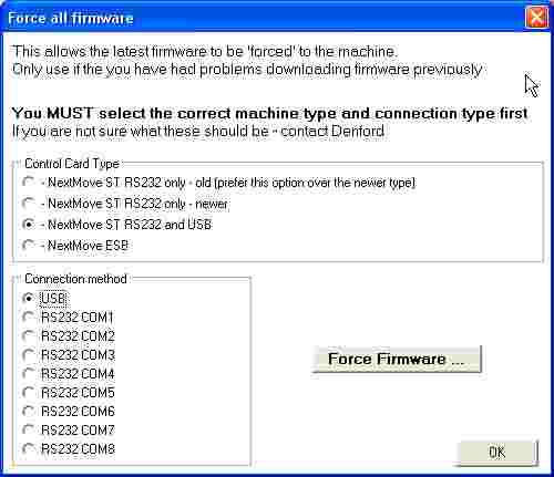

Make the changes to upgrade by USB and identify the card as shown in screen 2 then click on the force firmware
- Double click to open the force firmware menu
- screen1.jpg (20.32 KiB) Viewed 7847 times
- select the correct card type
- screen2.jpg (17.03 KiB) Viewed 7848 times
