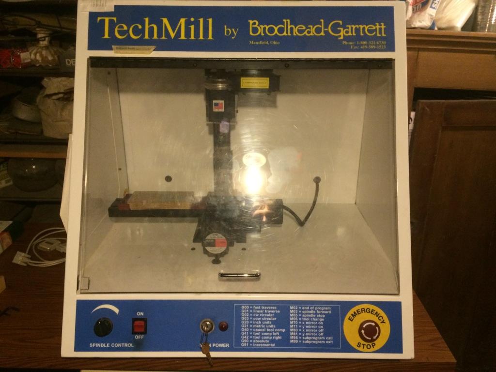

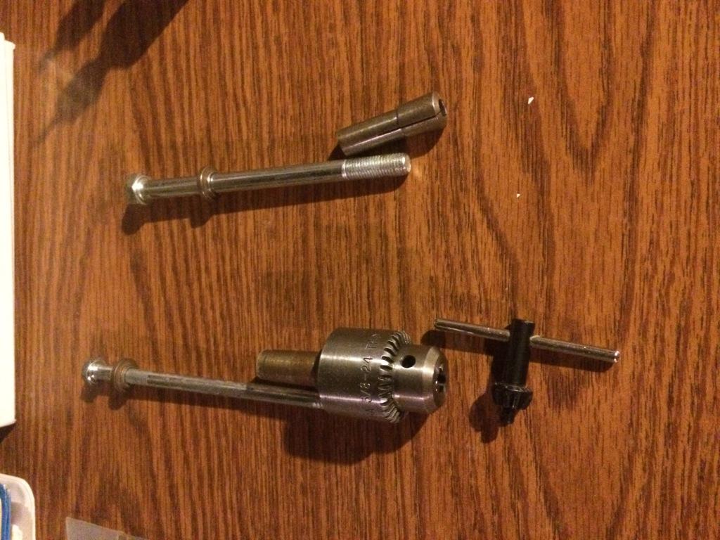

I need some help with setting up the micromill I recently acquired. I am an engineering student, and recently got introduced to CNC in a class. I have recently acquired my instructors old Micromill that they replaced recently because it would not run on the new computers they got. I don't know much about it other than what he has told me, but he said it would only run on windows 95. So my first question is, can I upgrade the software to get it to run on XP or will it take more than that? I have included pictures of everything that came with the mill.

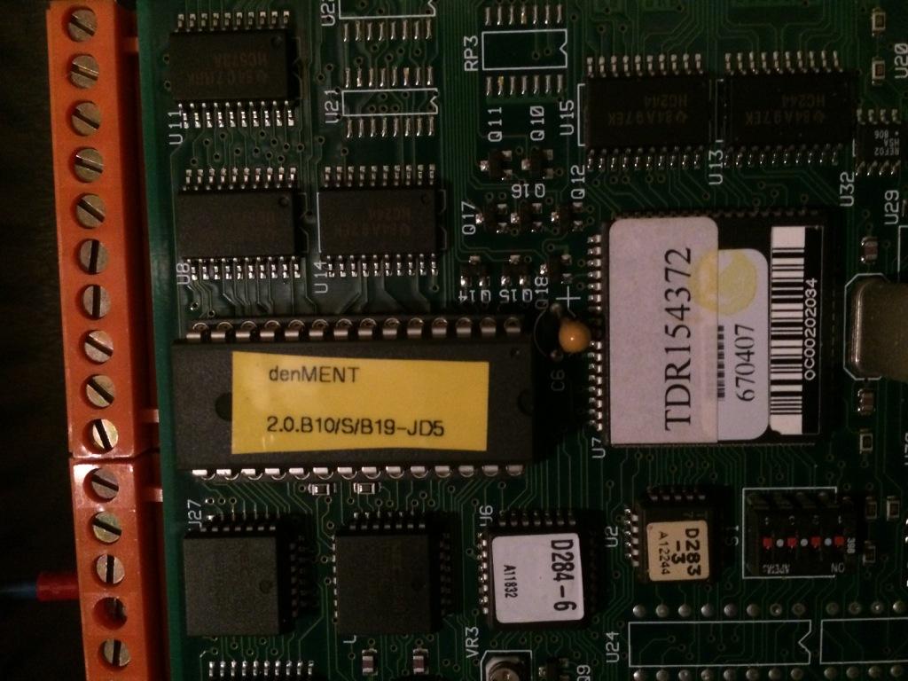

You may find it will work of XP, possibly Windows 7 but that depended on the software on the eprom on the main board (large chip with a sticky label on the middle with a version number on it and possibly other data, looks to be a yellow label in the photo) and the control program you have.
If you can post up what info is on the label someone should be able to give you a better answer than that.

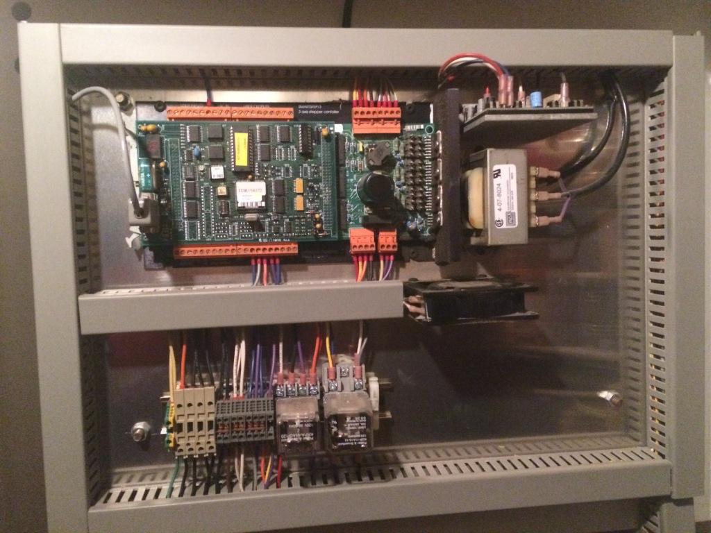

I popped the back off the mill today and took a picture of the label you had mentioned. It appears to have " denMENT 2.0.B10/S/B19-JD5" printed on it

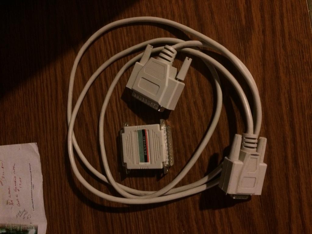

I noticed you have a 'dongle' that plugs into the parallel or 'printer' port (NOT between the RS232 25pin plug and the machine) on the computer I am 99% that will be so you can run mill cam designer which I saw a floppy for.

As I said earlier the physical 'Dongle' you have will be for mill cam designer. As Martin says the VR CNC Milling 'dongle' is actually the licence file on the floppy disk.
