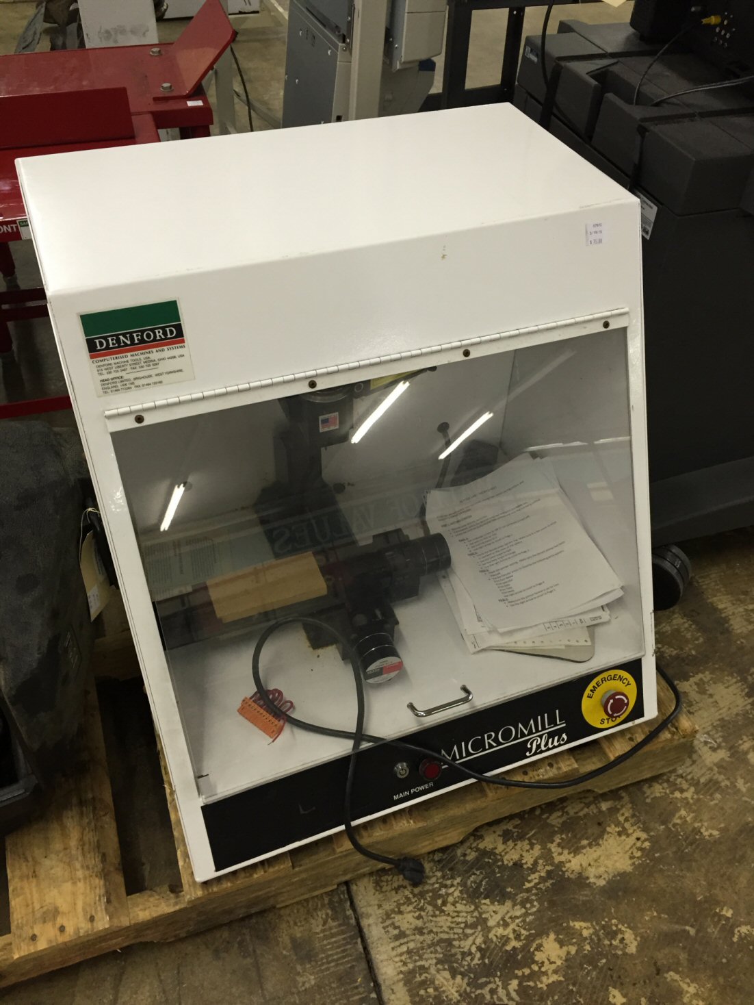

Hello. A local surplus has a Denford Micromill Plus for sale for $75 USD. I have no idea of the state of the electronics, or the motors, etc. It is sold "as-is". The machine looks to be in good condition all in all. It does not have any discs or software with it.
I have a few questions. I cannot find any references to a "Micromill Plus" anywhere at all. It says MICROMILL on the bottom face between the power button and the emergency stop button, and under that in script it says "Plus". Does anyone know what the "Plus" indicates? It has a power button and security key in the middle, and an emergency stop on the right. On the back right side there is a RS232 parallel port.

I've attached a picture of the Micromill Plus:
Photo Mar 20, 2 18 17 PM.jpg (268.51 KiB) Viewed 11626 times

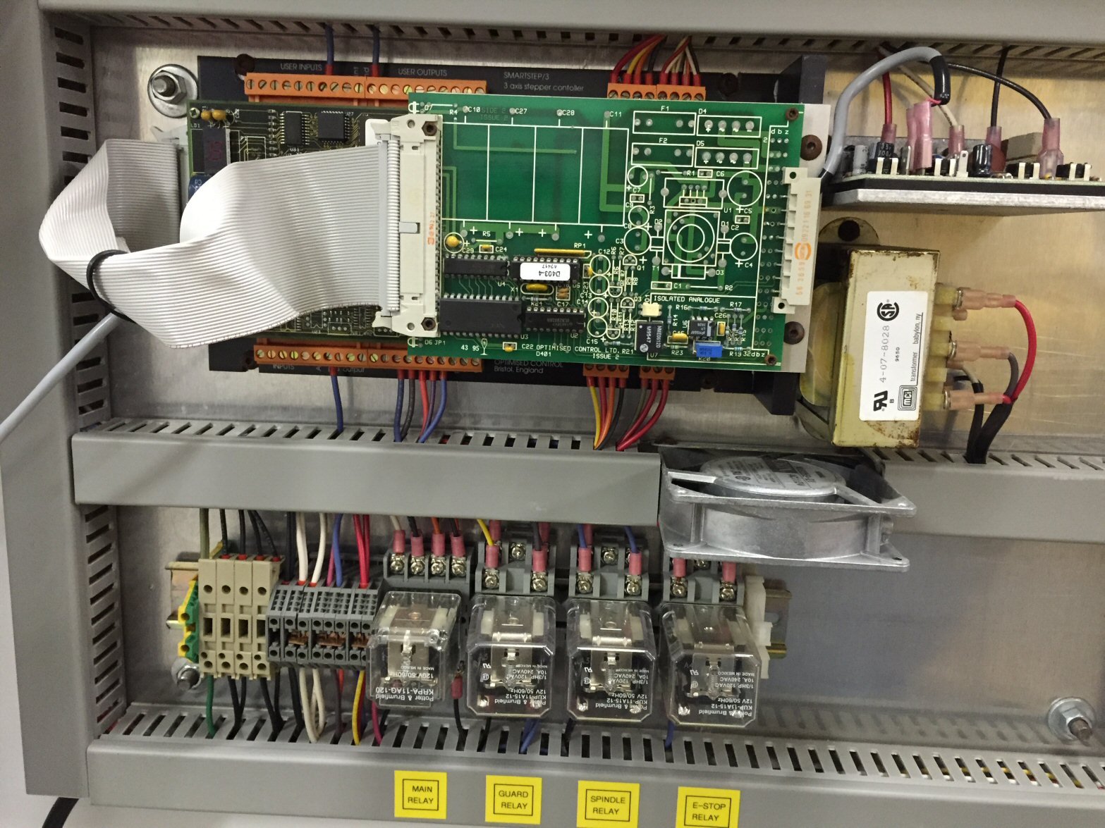

It looks the same as the micromills I have in work (the oldest is just called a Micromill, the newer a Micromill 2000). Only Im on the other side of the pond. If you remove the back panel you will be able to show the control board, there will be a chip with about 1" by 0.5" and 28 legs. it should have a sticker on the top, this should be the software version. It is not soldered into the board but in a holder so it can be removed an upgraded.
If you can get those pics you may be able to find out more info. there are different types of control board and software and it is those that will dictate what you need to get it running.

Post by Martin » Sun 22 Mar , 2015 14:17 pm
We only ever made Micromills so I guess the agent added the sticker.

Firmware says:
denmint v2.0/S/
B19-JD5
So from what I've seen on the forum, it doesn't use the DOS drivers but the Windows drivers that cost a significant amount (or did at one point anyway).
Photo Mar 23, 9 01 30 AM.jpg (416.27 KiB) Viewed 11606 times

Looking at other pictures of the Micromill circuit board, I see the mill I purchased (I went ahead and bought it) has an extra daughterboard that none of the other pictures show. It is attached via the big ribbon cable, and reads "C22 OPTIMISED CONTROL LTD. R21". I wonder what that is? I have a hunch it has to do with the "Plus" model. It has what I presume is a ROM chip labeled "D403-4 A2417"

Post by daneast » Mon 23 Mar , 2015 15:27 pm
To answer one of my own questions, that daughterboard is for spindle motor control.
