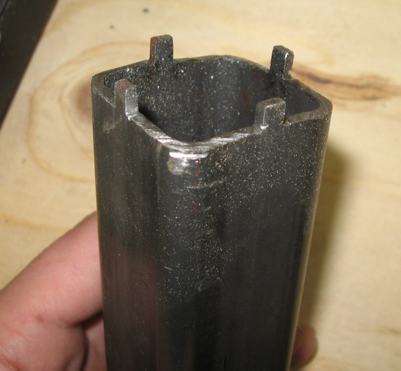

You'll need a bunch of metric hex wrenches; 4mm, 5mm and some other small sizes that I forget for the motor gearbox, and the PCB underneath. Also a custom spanner / pin wrench like this :
custom spanner

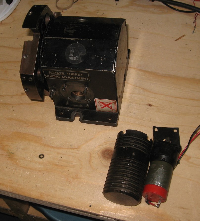

1- (no pic) unscrew the ATC from the saddle, tilt it on its side to reveal the bottom access panel and electricals. Remove / disconnect wiring and PCB.
2- remove the motor + gearbox + heatsink (IIRC it can be removed as one piece); I don't recommend removing the motor from the heatsink unless necessary.

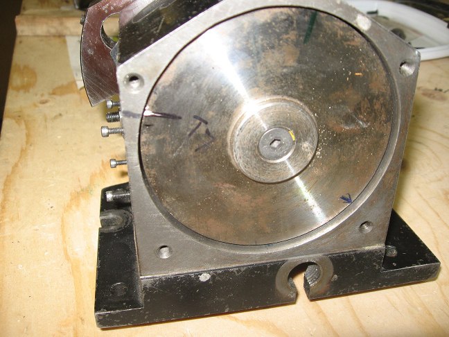

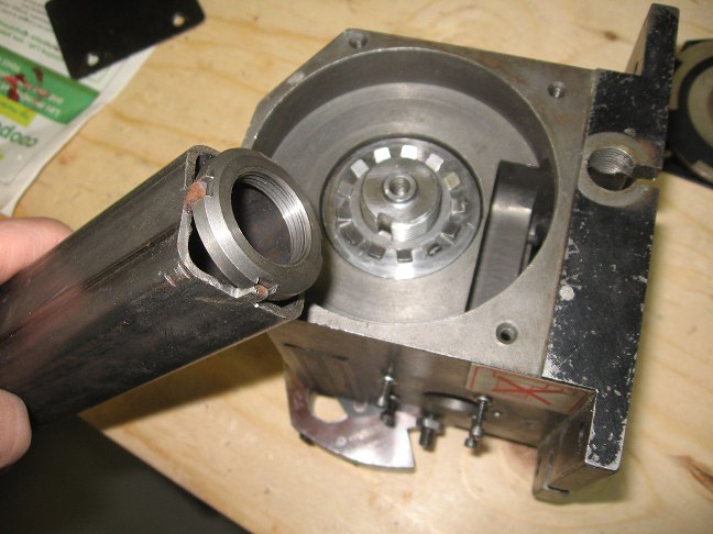

3- Open ATC rear panel; trace a witness mark on the ATC body and the index wheel. Remove index wheel (be careful with the shiny traces on the other side !)
index wheel
4- with custom wrench, remove locknut (unbending some lock washer tabs may be necessary)
lock nut

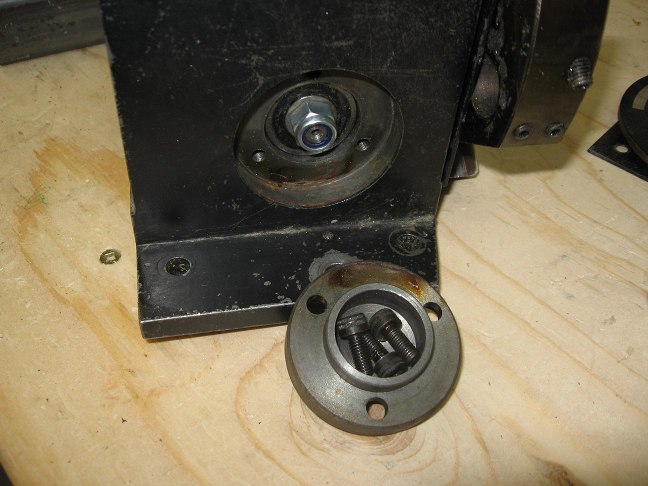

5- remove worm gear side cover

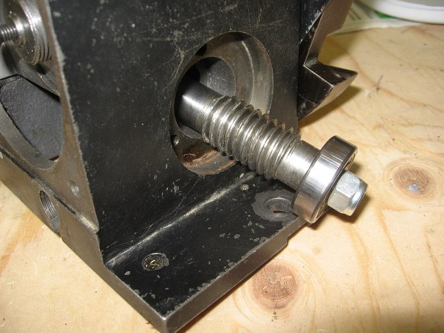

6- push out worm gear shaft; turning the tool holder face with one hand can be helpful
worm gear

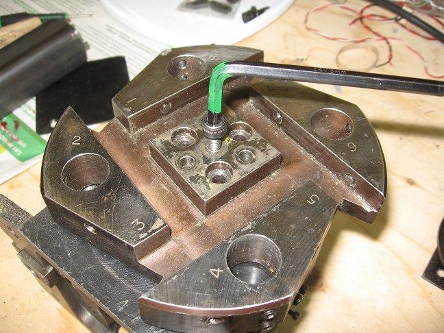

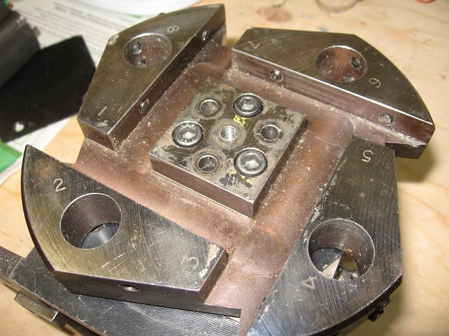

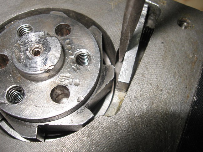

7- holder face : remove plastic caps if necessary; remove 3 bolts.
Note, the 3 other holes have dowel pins in them. On my ATC, two of the dowel pins had snapped flush at the holder face / ATC shaft mating interface. These pics were taken after the whole ordeal of welding a washer + nut, and pulling with a slide hammer / vise-grip combo.
holder face
8- take one of those bolts (or any M6 bolt) and thread into the middle hole. This should push out the holder face from the ATC shaft.
holder face 2

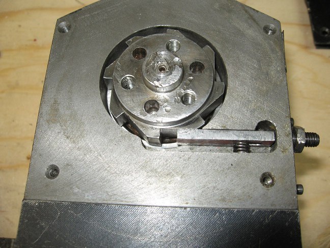

9- note the ratcheting mechanism. Very simple; almost effective, but not super repeatable and accurate. And hell to put back together after taking it apart.
The mangled face of the ATC shaft is due to an angry afternoon of failed attempts at removing the snapped dowel pins.
ratchet
10A (preferred): unscrew ratchet ajuster fully out, and fit a random object (here a flat blade screwdriver) to ensure the pawl clears the bearing outer race, otherwise it's going to be very difficult to push the shaft out. I know, I tried !
pry ratchet
10B (alternate) : remove ratchet spring guide screw, convince the pawl to exit its groove without throwing the spring into orbit (or into an eye). Good luck putting it back together !

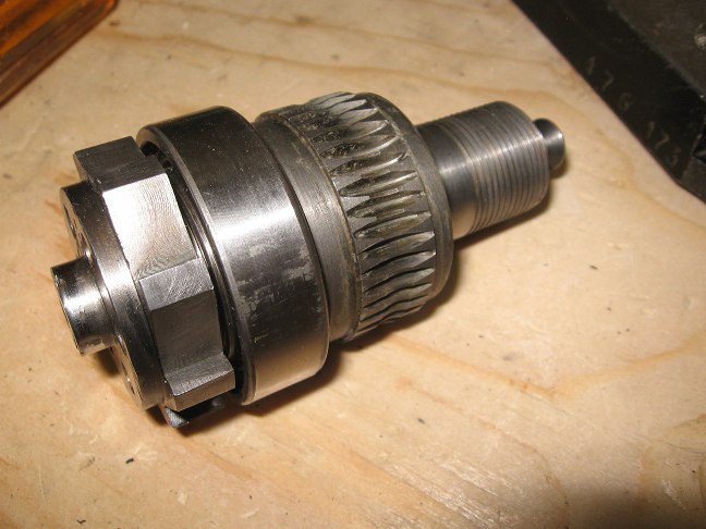

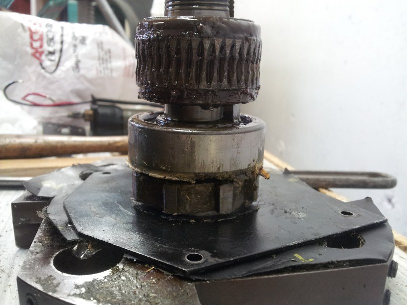

11 with the ratchet pawl taken care of (either out of the way (10A), or removed (10B)) : push out the ATC shaft from the back. A bit of persuasion may be required; a small hammer and a piece of wood used as a drift punch works fine.
shaft assy
12 tadaaa. Actually I cheated; the ATC shaft assembly really looked like this on mine !
dirty shaft

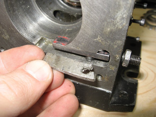

Here's the original ratchet pawl. This was causing massive issues - shitty repeatability, impossible height adjustment, etc. Also I noticed that every ratchet tooth face is worn slightly differently. I'm not sure what I'm going to do to fix this...
ratchet pawls

You're welcome - glad it could be useful to at least someone. As for reassembly / adjustments, I'm not sure when,how, and if that's even going to happen. As I mentioned, the ratchet stops are worn unevenly, which means that no matter how I adjust it, each tool position will have a slightly different height above centerline...

Have you thought about either filing/machining the ratchet to the same lower level or building it up with weld and machining back to correct height?
