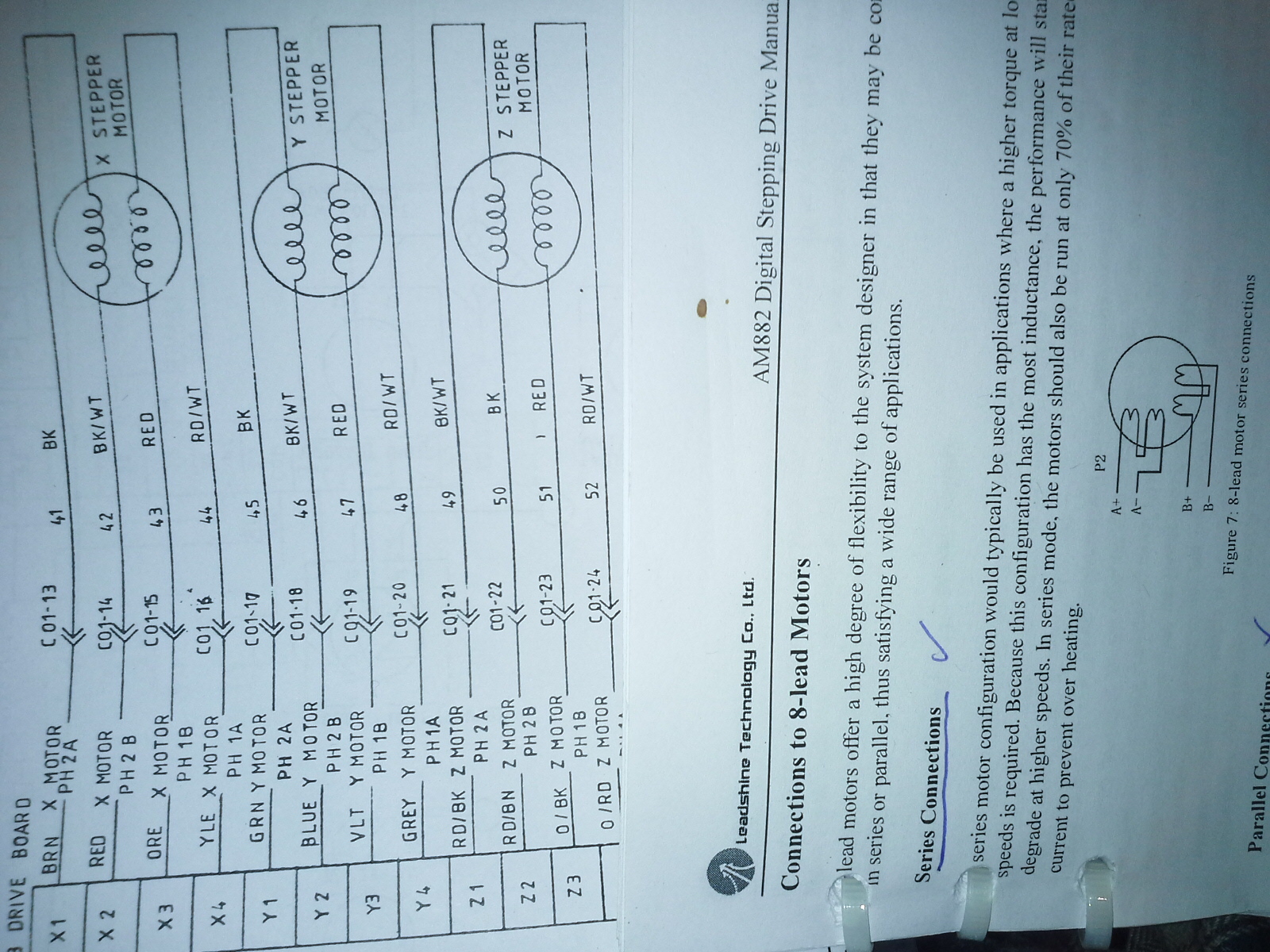

I've got to the stage in my build where I am connecting the stepper motors to the new drivers I have bought. The manual for the Leadshine stepper drivers asks for wires labled A+, A-, B+ and B-, while the Easimill drawing number A3-200014 shows the wires labled as 1A, 1B, 2A and 2B with wire colours as red, red and white, black, black and white respectivley
On the Easimill drawing 1A and 1B are at opposite ends of one winding and B1 and B2 at the opposite ends of a second. Is it true to say that -
A+ = 1A
A- = 1B
B+ = 2A
B- =2B
Attached is a photo showing the relevent diagrams from the drawing and stepper driver manual.

Post by Martin » Sun 23 Mar , 2014 20:56 pm
Yes. It's they are the same . If it turns the wrong way invert 1A & 1B.
