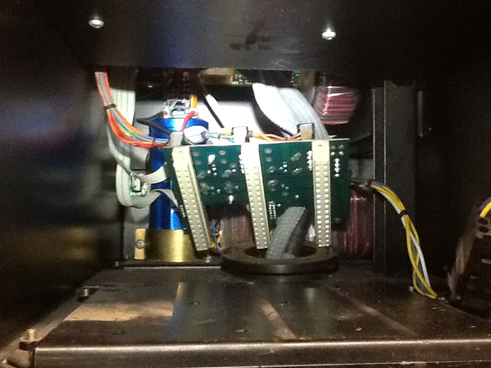

Attached are some photos of the machine with info plates and some of its insides.
Looking inside the control box at the board that the stepper drivers connect to.
Stepper driver connection board.JPG (397.7 KiB) Viewed 40965 times

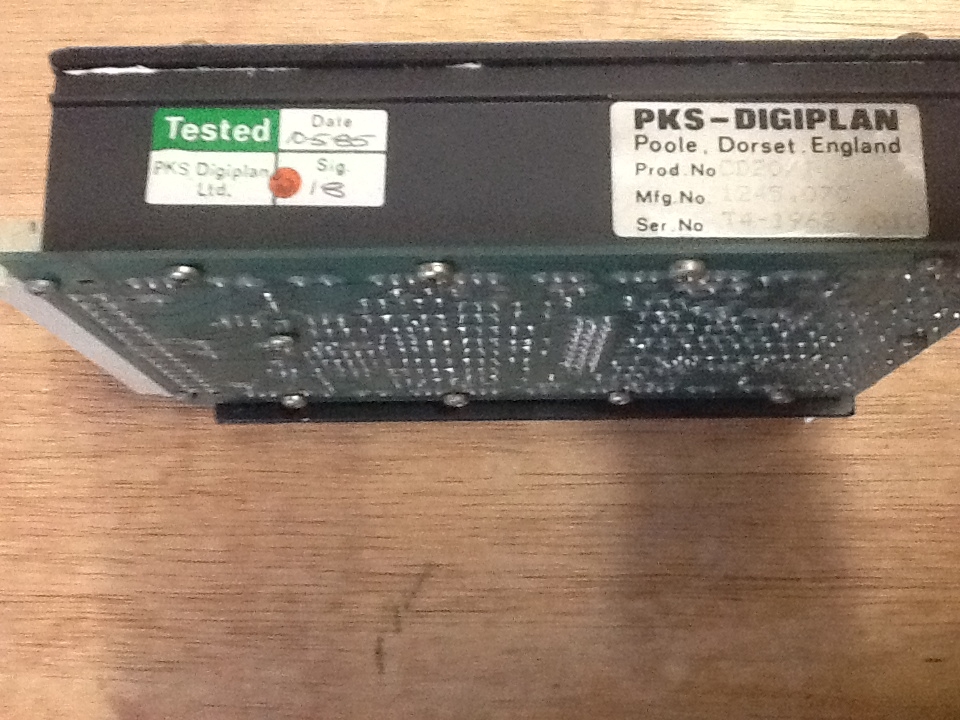

One of the stepper driver boards showing the manufacturers details.
Stepper driver.JPG (451.67 KiB) Viewed 40965 times

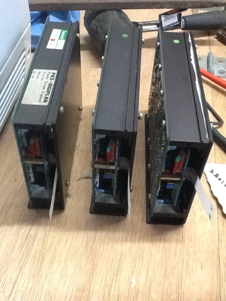

The three stepper driver boards removed from the control box.
3 off stepper drivers.JPG (487.07 KiB) Viewed 40965 times

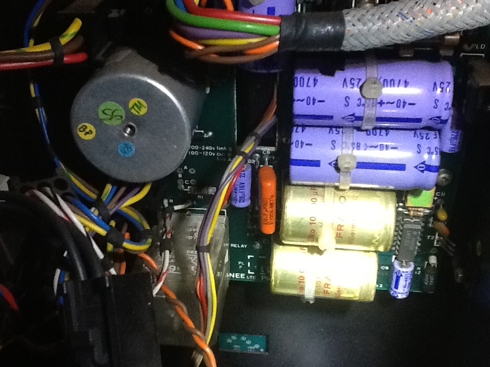

The North East Electronics Power Distribution board.
NEE Power Distribution board.JPG (428.47 KiB) Viewed 40965 times

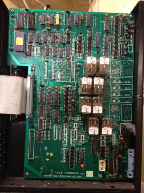

The PNC3 board.
The PNC3 board.
PNC3 Board.JPG (241.74 KiB) Viewed 40965 times

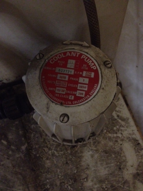

The coolant pump motor plate.
Coolant pump.JPG (162.59 KiB) Viewed 40965 times

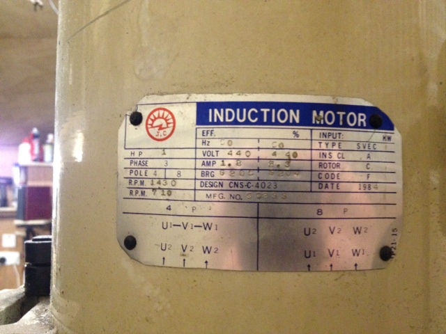

Main spindle motor plate. It looks like its been attacked around the edges with tin snips.
Spindle Motor plate.JPG (183.16 KiB) Viewed 40965 times

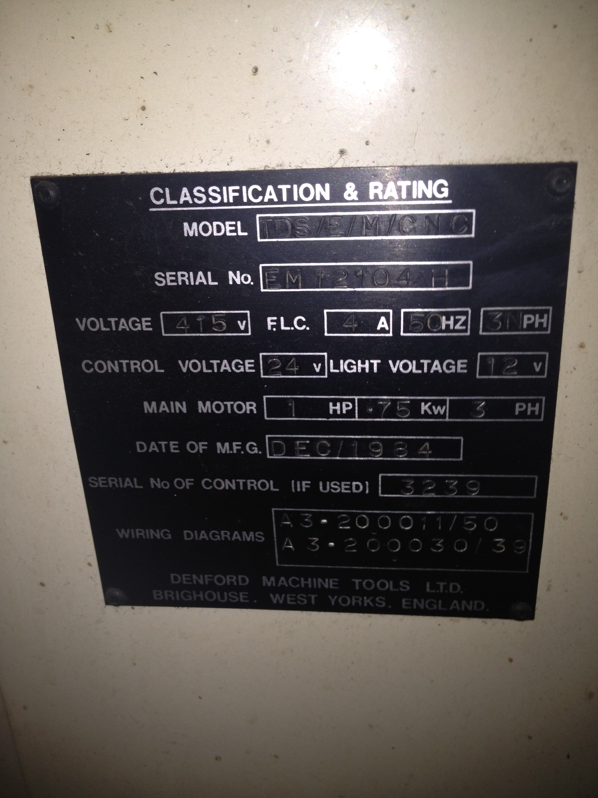

Specs plate attached to the side of the machine.

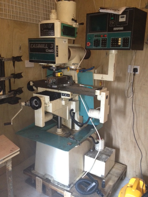

This is my new Easymill 3

Hey Vandal, thanks for your post.
You say your machine is the same and you run the spindle motor through an inverter. Is your spindle motor the same as the one in the pictures? I'm trying to work out if the motor on my machine is dual voltage so I can run it from an inverter like yourself. The name plate shows 440 and not 220. If you could confirm this I'd be greatful.
Re: Can I use an inverter with my easymill 3?
My motor looks identical to the one in the photos. Pretty sure that the dataplate on my motor and on the mill are both marked 220v instead of 440v, I'll confirm when I get home tonight.

I've noticed the time of your post, do you work nights or are you based somewhere west of the UK? I'm thinking that if your in the States your supply voltage may be different to ours so the inrternals of motor might be different to suit that voltage. If I understand correctly, 3 phase is 220 volts in the States while it is 440 volts in the UK.
Sorry this is so late, I just checked and yes, both the motor and the mill are marked 220v on my machine. I'm in the US, 3-phase here is available in 220 or 440v, but not in my home shop. My mill gets 240v 1-phase from a dryer circuit, and I've got two VFD's to make it 3-phase, one for the spindle motor and one for the coolant pump. I'm still using the original CD20 stepper drives etc.
