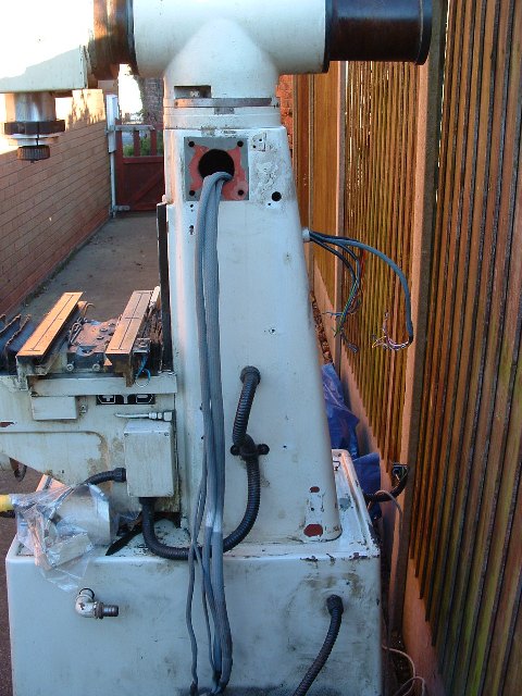

Mine arrived with me about a month ago and here it is, much to the annoyance of the Boss, awaiting the heavy gang to get it in the shed (AKA workshop), which meant taking off the table and the PNC3 control box to get it through the "Workshop" door. Thanks to Dave, Ian, Brendan and Neil, it is now in residence.

I forgot to mention that the magnetic panel enclosure, flood coolant and mist coolant were taken off at that time.
