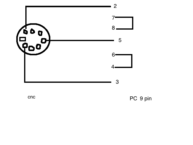

i have a easiturn 3 with PNC 3 and i have make a cable like shown in the attached picture. I use a 9 pin Male on pc side and a ethernet cable (ethernet has 8 cables in it and i use the 3 of them) lenght of the cable 1.5meter. I am using a windows xp pc.
The communication between the cnc and the pc must be ok because when sending from the cnc to the pc everything is ok. The problem is when i want to send the code back to the cnc. On the CNC side i choose data link - Host Computer and in the pc side in the easyDNC programm i push SEND. Then the easyDNC says Waiting for CNC and nothing happen. After a while If i press reset on the cnc the procedure on easyDNC says 100% and in the cnc is tranfered only the first block.
When i make the same procedure and have drip feed enabled in easyDNC then it is executing the first line and after that stucks again. If i press STOP on the easyDNC and then send again it executes the second line.
This all is possible only for G01 commands. M04 dont work. Nothing happen when i send them.

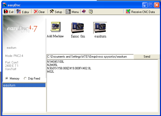

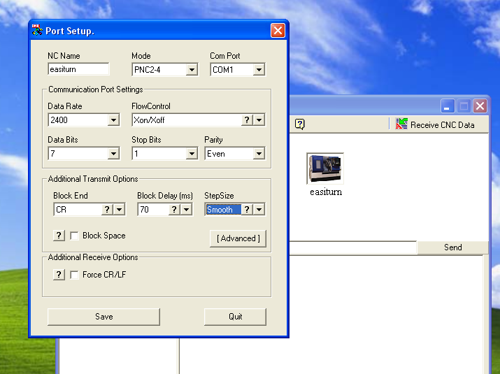

I attach a picture with my easyDNC settings and my G code with i have sended from my cnc.
Please help me i dont know what else to do !

I think there could be a couple of reasons for this. Either
a) the PC is sending all of the CNC program but the control only recognises the first block.
b) The PC sends the first block and is waiting for the control to request the next block.
I am not familiar with EasyDNC but here are some suggestions...
1.Try turning off the XON-XOFF flow control (set it to "no flow control" or similar). You may also have to increase the "Block Delay" to something like 1000ms. This solution will not work for Drip-Feed but may work for storing a program in teh CNC.
2. Try changing the Stop Bits to "2 stop bits"
3. if the PNC control has a "Paper Tape" option on the screen then try this (Paper Tape option used Xon-Xoff type flow control)
HTH
HTH

Re: easiturn 3 , data link problem. Please help!
so ok ! i have found the problem and the problem is easyDNC . If i transmit with hyperterm for example the line G01X170Z470FX1500
in this format :
ctrl+B (this is the STX (02) character) G01X170Z470FX1500L ctrl+M (CR(0D)) ctrl+B (STX(02))
the cnc returns me a ACK(06) and i can type the next block and continue without problem.
EasyDNC transmit this one :
so the cnc dont answer until it gets the next STX character and it is waiting and nothing happens.

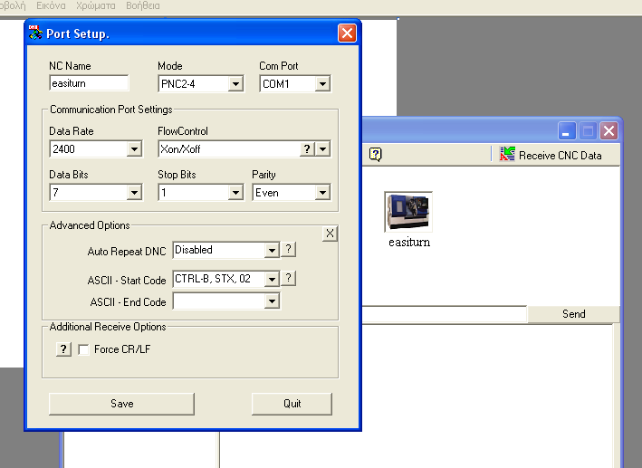

IF i could program the easyDNC to send this format :
ctrl+B (STX(02)) G01X160Z460FX1500L ctrl+M (CR(0D)) ctrl+B (STX(02))
i can save in my memory but for drip feed i would need to have this format :
ctrl+B (this is the STX (02) character) G01X170Z470FX1500L ctrl+M (CR(0D)) ctrl+B (STX(02)) ctrl+B (STX(02)) ctrl+B (STX(02)) ctrl+B (STX(02)) ...
(it must send the STX character until the cnc has completed his move and when it has completed it sends the ACK (06) and then the easyDNC will continue with the next )
ctrl+B (STX(02)) G01X160Z460FX1500L ctrl+M (CR(0D)) ctrl+B (STX(02)) ctrl+B (STX(02)) ctrl+B (STX(02)) ctrl+B (STX(02)) ctrl+B (STX(02))...
can anybody help me to do this ? or does someone know if i could make a program in matlab ?

I'd contact easyDNC - I'm sure they will have a way of adding the STX to the end of each line.
ps, I'd also see if ETX works from hyperterminal...that makes more sense than using an STX at the end.
after the CR it must be some character.Any character works but i have choosen STX...Denford Admin wrote:I'd contact easyDNC - I'm sure they will have a way of adding the STX to the end of each line.
i will contact them and if nothing can be done then i will try to write a programm in matlab
If it just needs any character then how about LF (Line Feed) it may be that easyDNC has the option of appending CR+LF at the end or just CRafter the CR it must be some character.Any character works but i have choosen STX...
If you have choosen the PNC2-4 mode then it transmit only CR at the end whatever you do.exept that i need for drip feed to send this "any character" again and again until the cnc has finished his move and respont with a ACK to continue in the next line.Denford Admin wrote:If it just needs any character then how about LF (Line Feed) it may be that easyDNC has the option of appending CR+LF at the end or just CRafter the CR it must be some character.Any character works but i have choosen STX...
