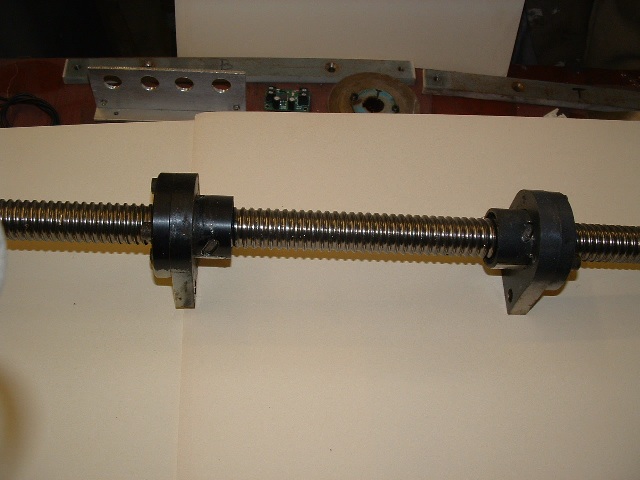

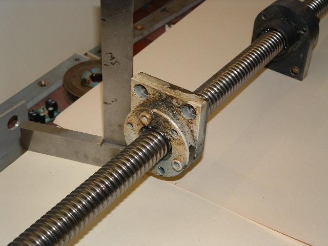

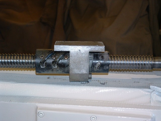

Re: EasiMill backlash adjustment
Here are 3 photographs of the Y axis ball screw and nuts. The nuts are by Warner Electric, the front (pulley) end being RM 2505 UF, the rear one is RM 2505 A. They are non-adjustable, have no pre-load and (sadly) no wipers.
This is really useful - rather hoping you might post some pics of the X axis arrangement and details of the nuts as you go. Do you have any plans to replace the screw and nuts or are yours in good shape?
Hello Ian.
I am in the middle of a refurbishment of this Easimill, the base, column and knee were painted yesterday and it's a hobby rather than a job.
I'll take some pictures tomorrow of the X axis twin ballscrew and nut arrangement. Anything else on this machine you would like a photo or details of?

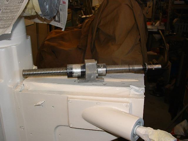

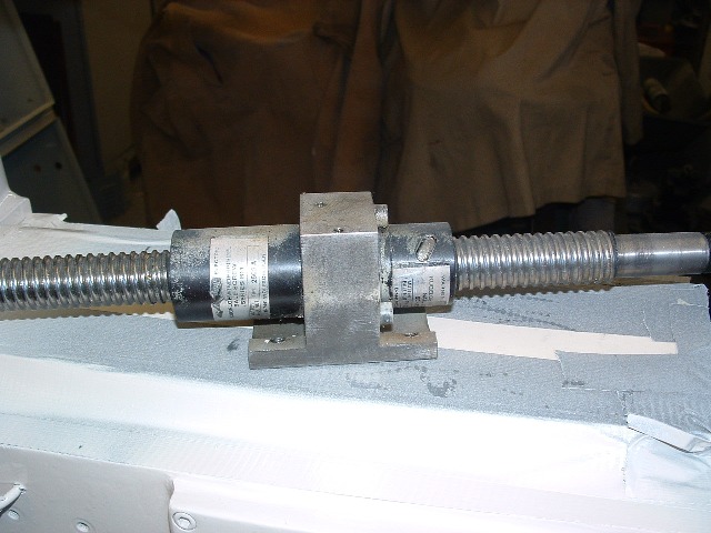

X axis nuts are Warner Electric series RM type 2025 UF, attached in their carriers to the saddle by 2 capscrews each end.
I haven't looked to find replacements.
