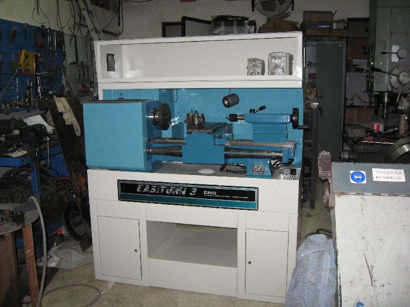

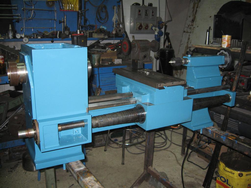

hi guys i start my restoration on the lathe i will drive this machine with mach3
please let me know some comments

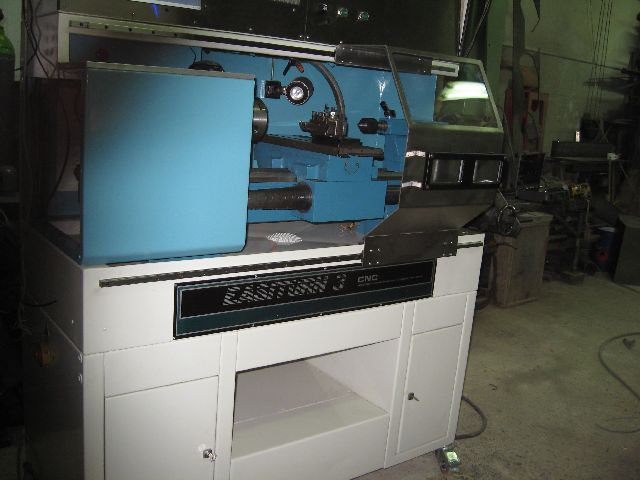

Post by jekran » Sun 09 May , 2010 10:02 am
an other

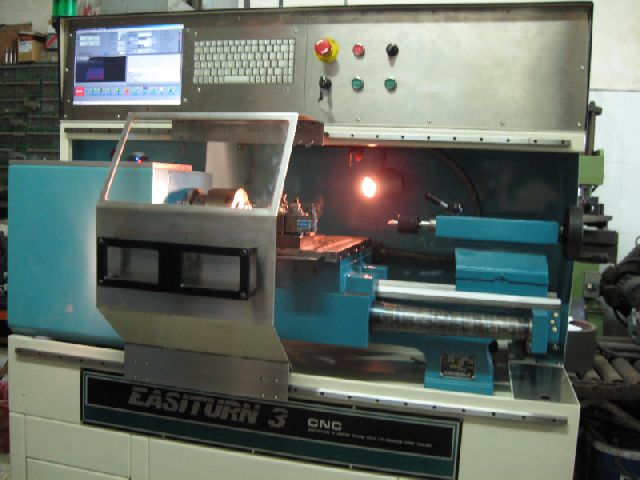

Post by jekran » Wed 30 Jun , 2010 17:14 pm
some more photo almost ready

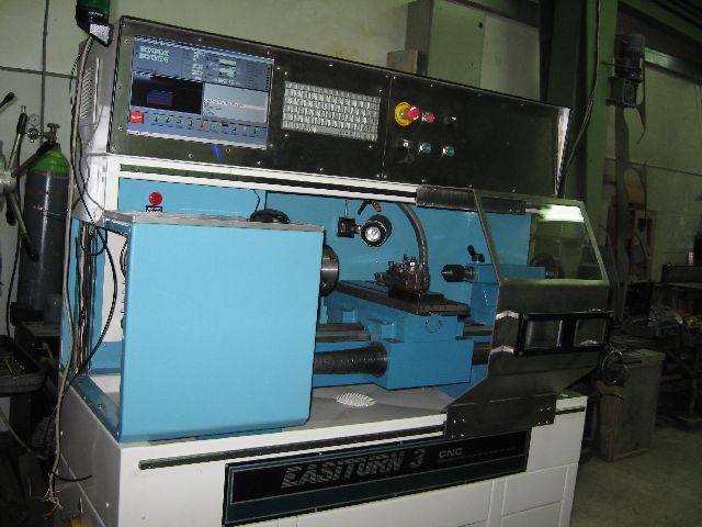

Post by jekran » Wed 30 Jun , 2010 17:16 pm
some work been done denford

Post by bradders » Thu 01 Jul , 2010 8:11 am
Brilliant, Nice to see our old machines back up and running
Re: denford easiturn retro
Post by Denford Admin » Thu 01 Jul , 2010 8:34 am
Yes that looks like an excellent retrofit :D

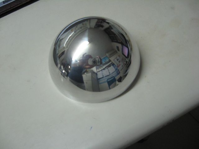

Was that a test part, or something you are going to be making on the machine ?

thanks guys for your compliments
that part was one of a small prodution that was made with the denford easiturn 3 i am still on testing the machine and now i need to make a ATC 8 position i will post some photo in the near future
