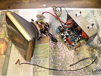

I have a small monitor which came from my Triac. A green on black screen.
I don't know if this is the same as the easimill, but if it is any of use. It is either free for collection, or cost of courier.
