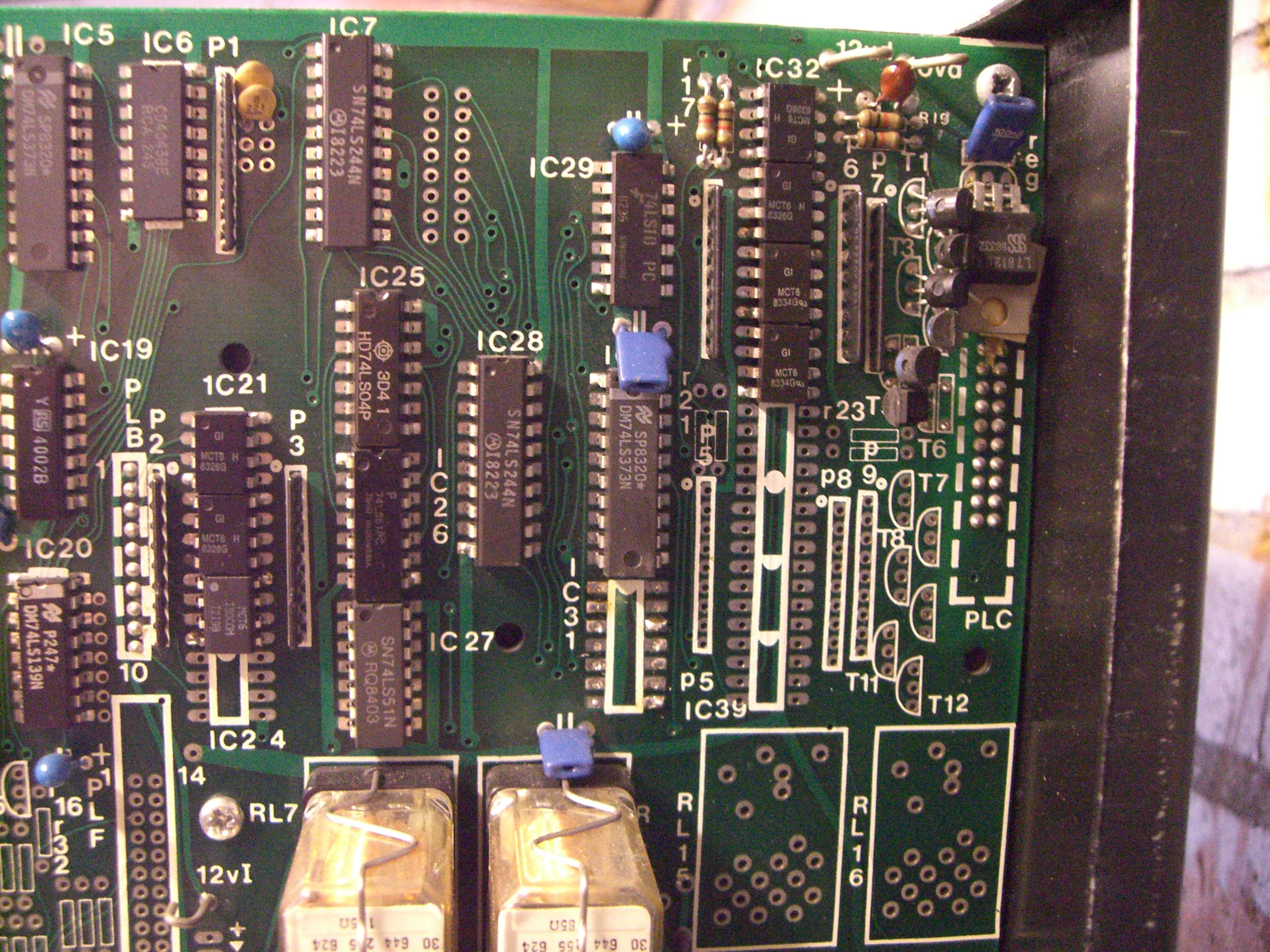

I have no IC39 it empty, see image
Just got to thank you Martin on all you help so far on my issue, you have been a big help.
Adee
PNC3 interface board

The drawings are the same for the PNC3 Lathe & Mill so I guess we need to be looking at the what the drawings show as the Y Axis on the Electrical Drawings.
Therefore the IC for the Z Step is IC35 & the signal goes out on pin 19 of the ribbon cable.

Are all the pins ok on connector PLC?. Looking at your picture there looks to be a compound covering the top 4 soldered joints.

Just checked the stuff you pointed out on the PLC, It was just a bit of the backing stuff from the mosfet above it.
