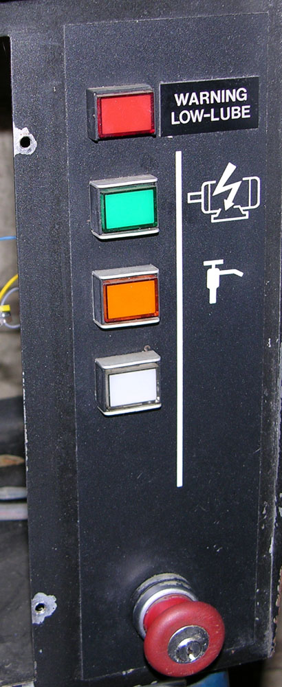

Can anyone tell me the purpose of the grey on/off push button please?
This is the cabinet containing the Fagor control on my Easiturn, Thanks...

Post by Martin » Wed 27 Apr , 2011 18:17 pm
I presume it is a Axis Limit Overide Switch.

Post by Multispool » Wed 27 Apr , 2011 20:09 pm
thanks Martin...
