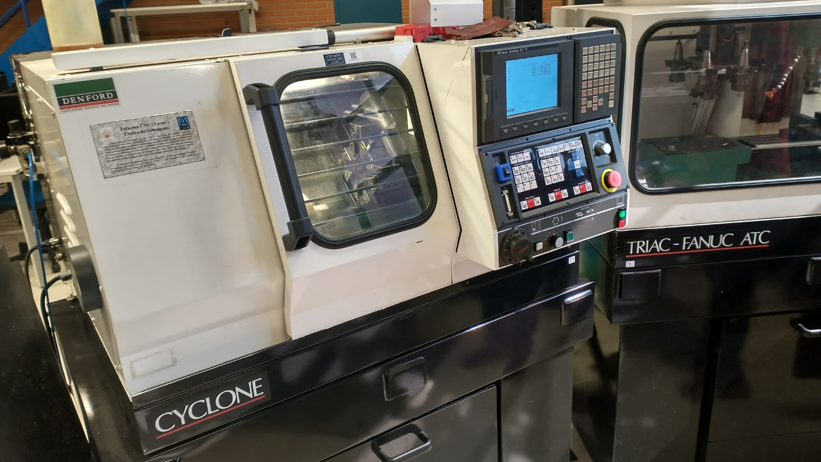

I'm trying to run a Cyclone machine with a FANUC 21i-T controller that has been sitting idle for a while and want to verify the parameters. As we're having issues running even basic G code instructions.
Machine serial code is: EO5415
Electronics serial code is: E98YAO344
is there a file with the factory parameters for this setup available?

Thank you, exported the parameters from my machine and was able to compare and find the source of the problem. Someone had messed with the parameters on the machine and it was acting all sorts of weird :?

Speaking of, the machine doesn't return to zero on startup or save any of its offsets when turning off and on. Would you suggest loading the full file? What can I look at to diagnose the source of that issue?
