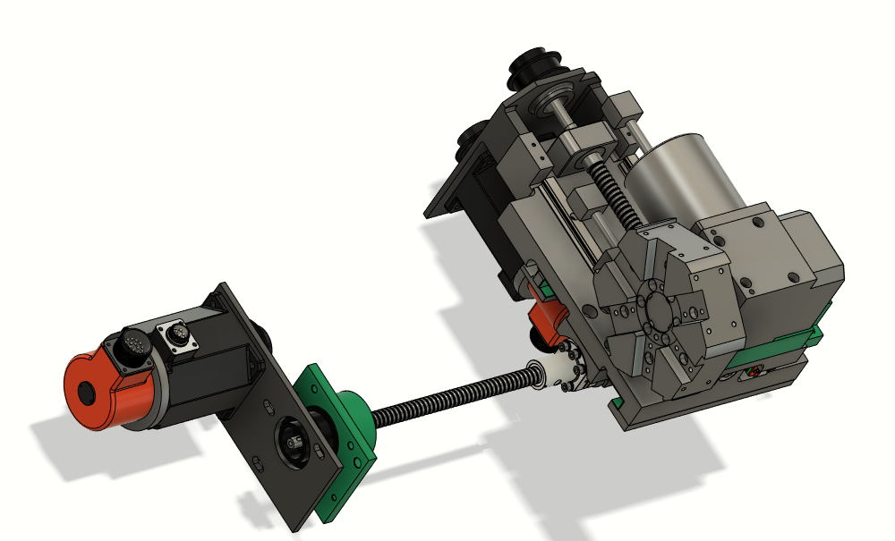

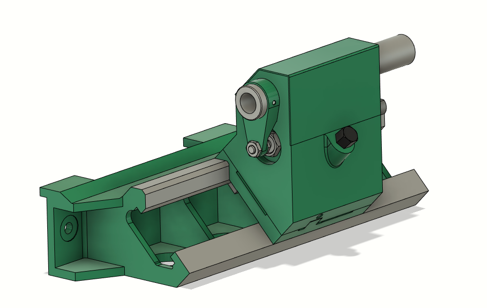

I have cad modeled most of the machine as i plan to do a linear rail conversion and keep the old control alive for as long as it lasts, It is a Fanuc 0T-A from the year 1983, i have attached an image of a 100% functional cad model of the denford cyclones tailstock, and a work in progress view on my CAD of the lathe itself. I plan to model the machine but also make an alternative model of the modernized machine as eventually i plan to create a denford inspired cnc lathe from scratch, with some significant design changes.
I originally planned to do a weld repair on the x axis but dovetails are just not very good to modern linear guided machines, not to mention the trouble of actually doing it and regrinding it to a factory spec i dont have.
The original fanuc wont last forever, but i can keep it alive as long as possible, they are easy to repair the old boards.
If there is any interest in my little project i will update here with some pictures of how it is going, but business is very busy so im probably going to be quite slow in my progress, i am fortunate to use the machines at work to "rebirth" the denford lathe. I even painted the sheet metal the doosan colours as we were all joking that it was a mini doosan puma lathe.. and we are a doosan user.
