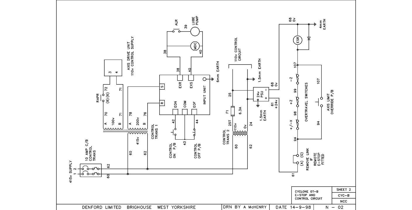

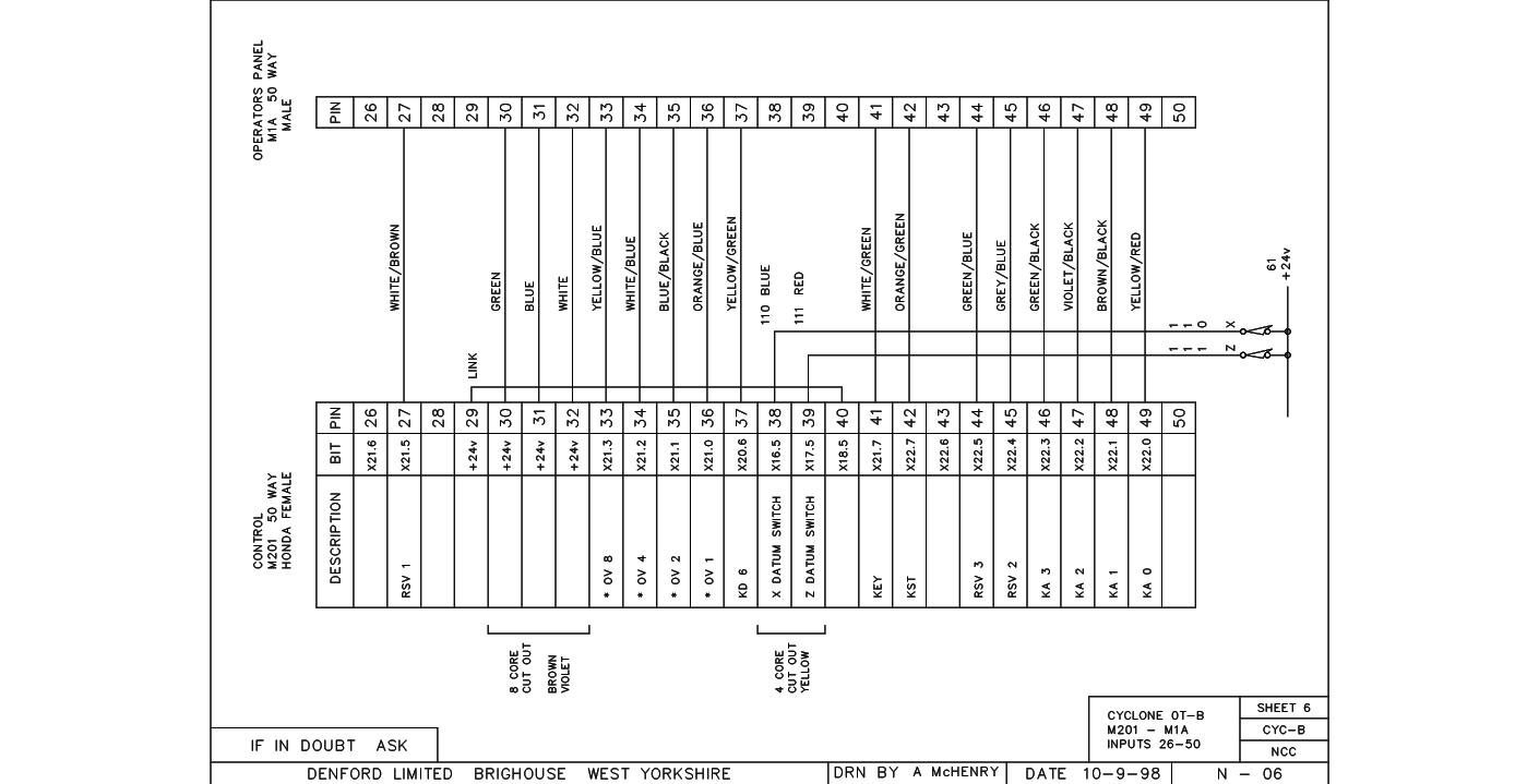

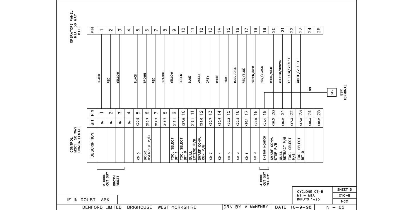

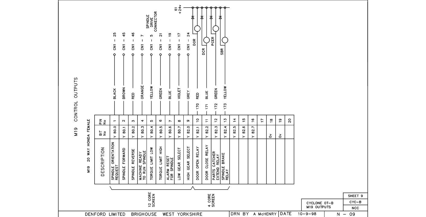

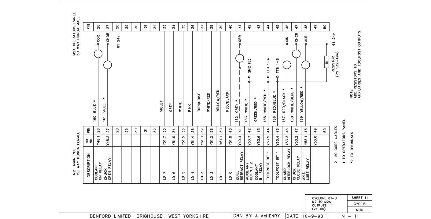

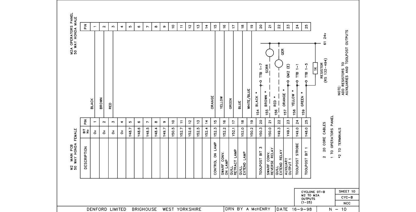

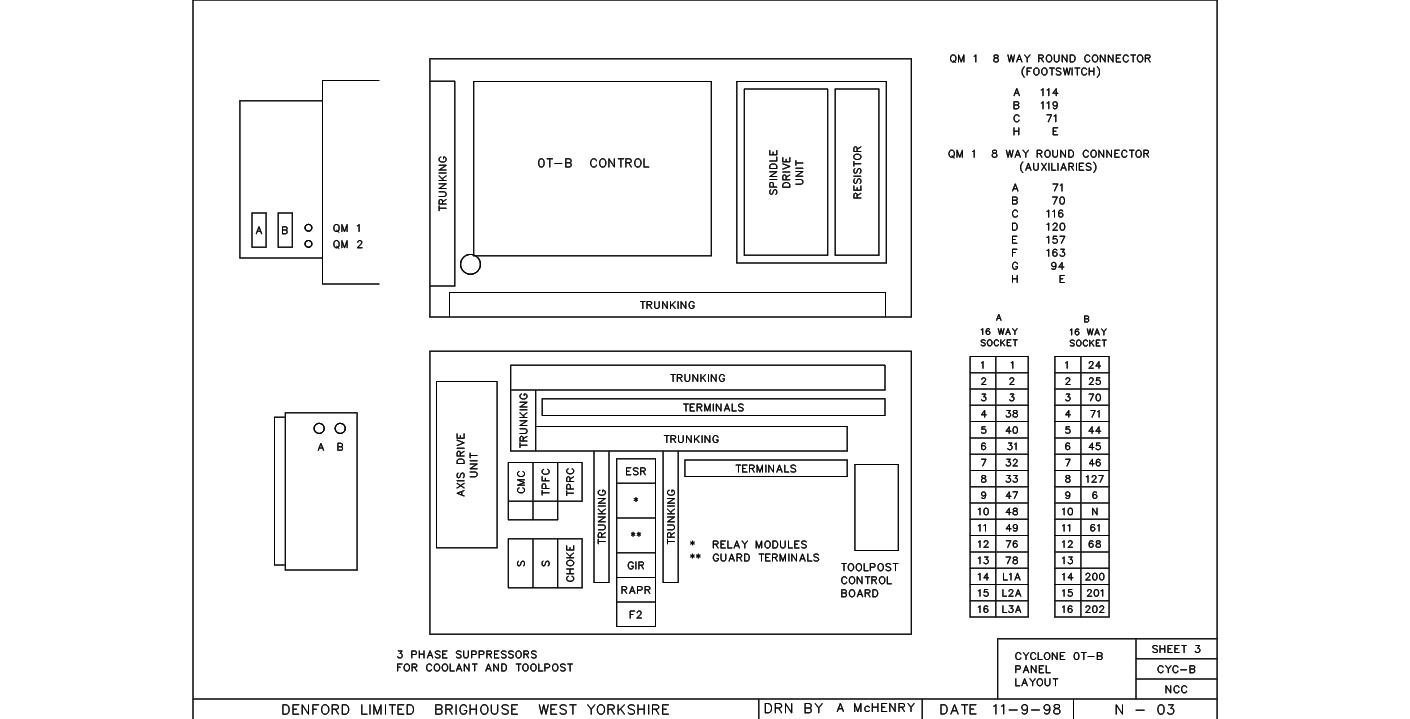

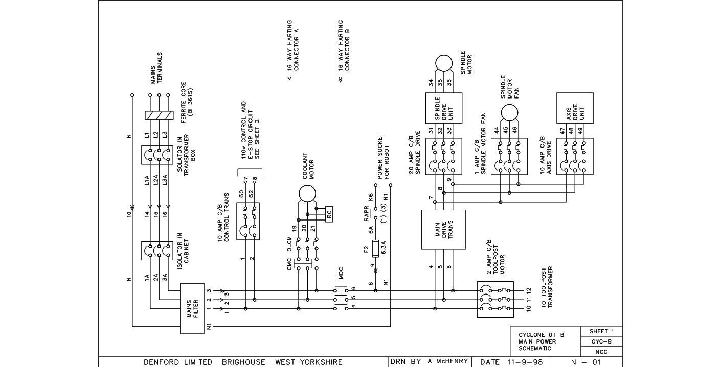

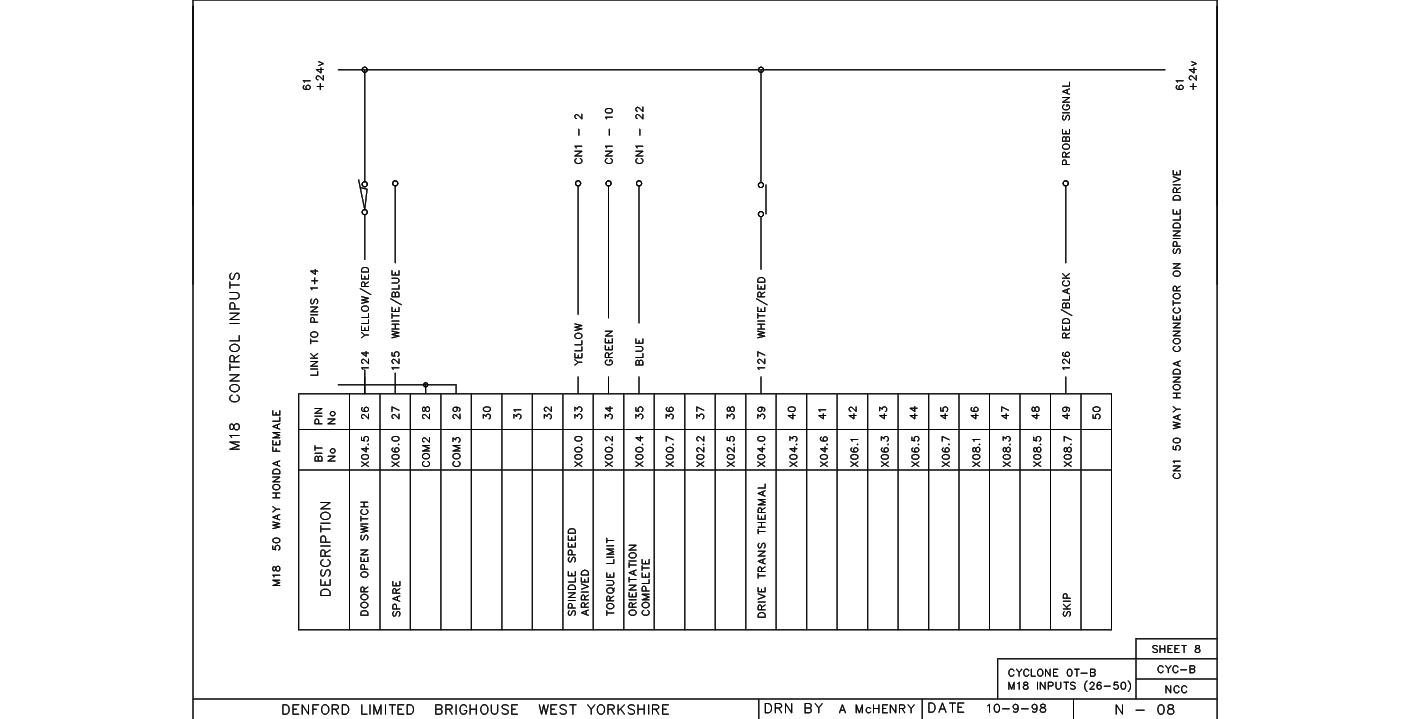

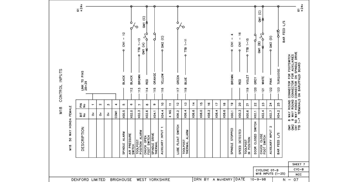

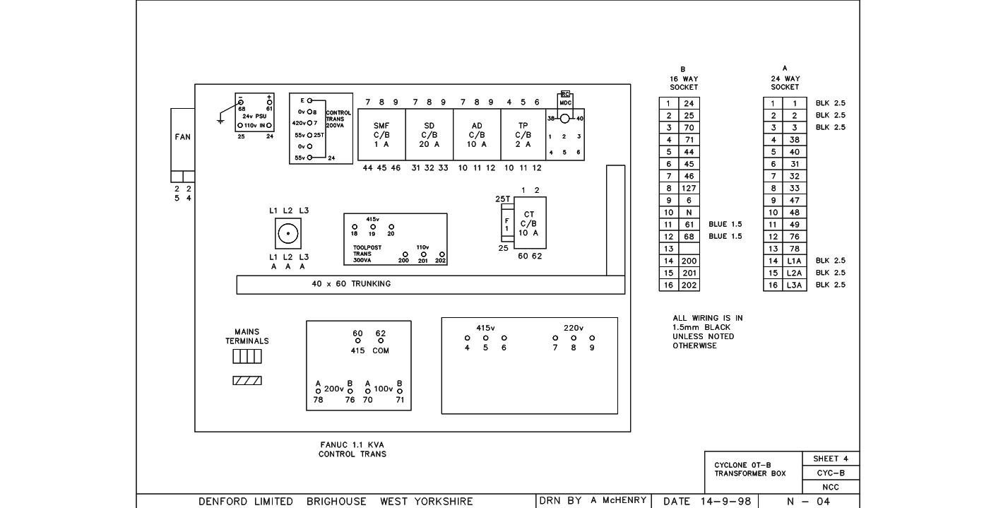

After a lot of searching, I found these schematics that seem to correspnd to my machine.
Circuit 1.jpg (128.89 KiB) Viewed 14378 times
Circuit 2.jpg (115.37 KiB) Viewed 14378 times
Circuit 3.jpg (109.83 KiB) Viewed 14378 times
Circuit 4.jpg (89.76 KiB) Viewed 14378 times
Circuit 5.jpg (104.72 KiB) Viewed 14378 times
Circuit 6.jpg (101.67 KiB) Viewed 14378 times
