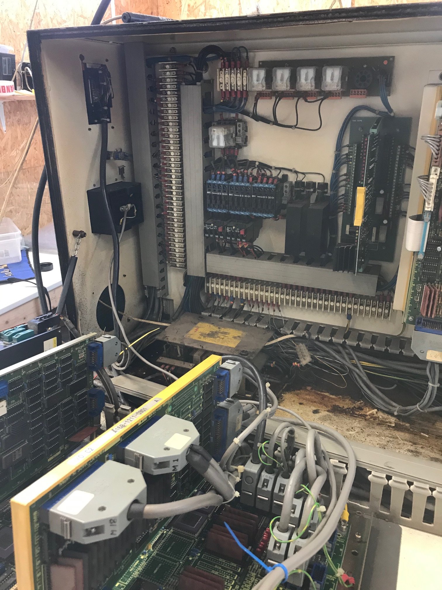

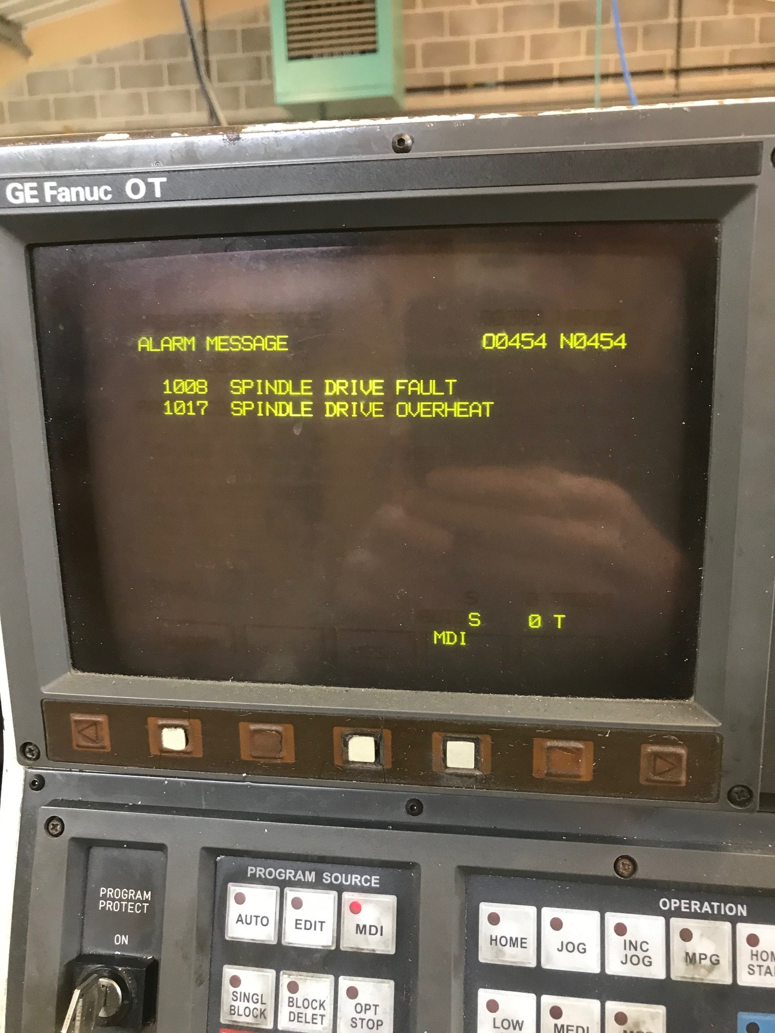

New to the forum here, we have a Denford Cylone that has been running fine for the last few years, however mid-way through running a program the machine alarmed out with the following alarms:
1008 Spindle Drive Fault
1017 Spindle Drive Overheat
1032 Drive Transformer Overheat
I managed to clear the 1032 alarm by adjusting the Diagnostic Parameters. However I cannot clear the 1008 and 1017 Alarms. On startup, there is no loud "thump" as the contactors usually drop in. We have checked the obvious (Slideway Oil Level as I have heard this can generate an E-Stop Fault), and we had a spare spindle motor here that we wired in and tried, but still the same alarms.

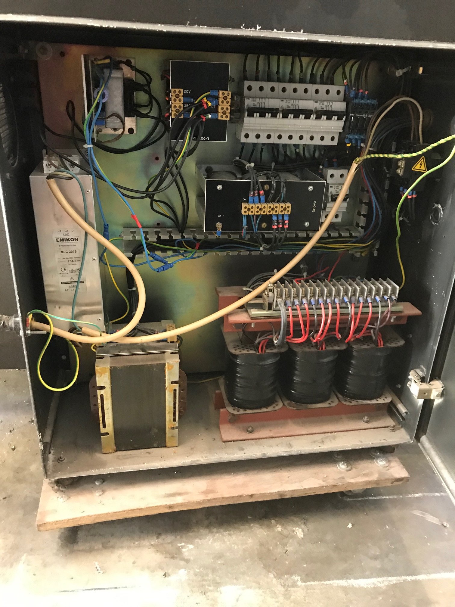

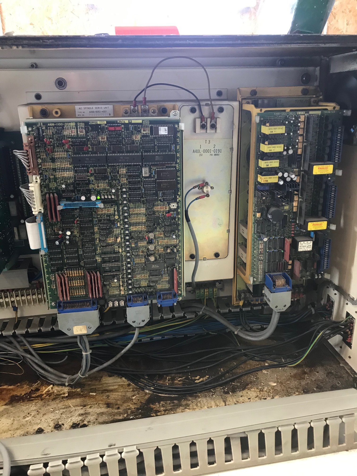

Regarding age and serial number of the machine, I couldn't actually find an information plate on the machine but took a few pictures as attached.
Very much appreciate any suggestions for what to check!

Have you checked the Thermal sensor on the big Balast Resistor ?
Fanuc does a full "sweep" of everything to make sure all is OK at startup, as you rightly say a peripheral like slideway oil level will trigger the 1008 alarm so as you also have an overheat alarm I would check that sensor, that great big resistor gets extremely hot, especially if you have been running a lot of CSS movements !!!
After that it is check fuses and the re-set on the spindle drive if there is one :D
