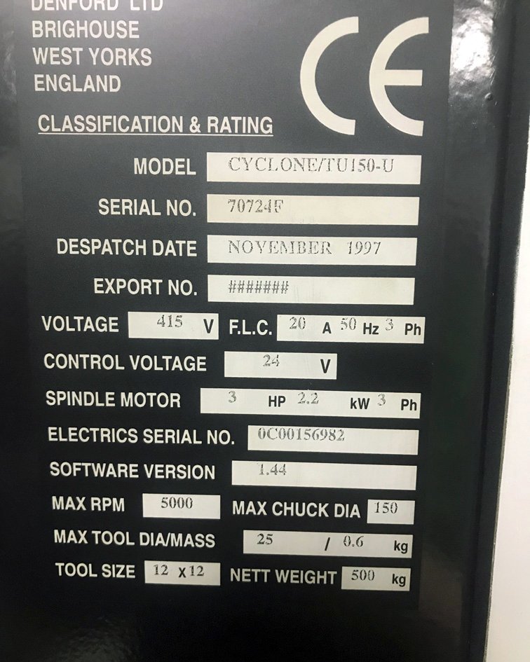

I just bought a 1997 Denford Cyclone TU150U which I’m going to convert to single phase. However I’m a little confused about the motor power as the different specifications don’t agree.
According to the side plate it is 3hp, 2.2 kW on 3-phase 415v with 5000 max rpm.

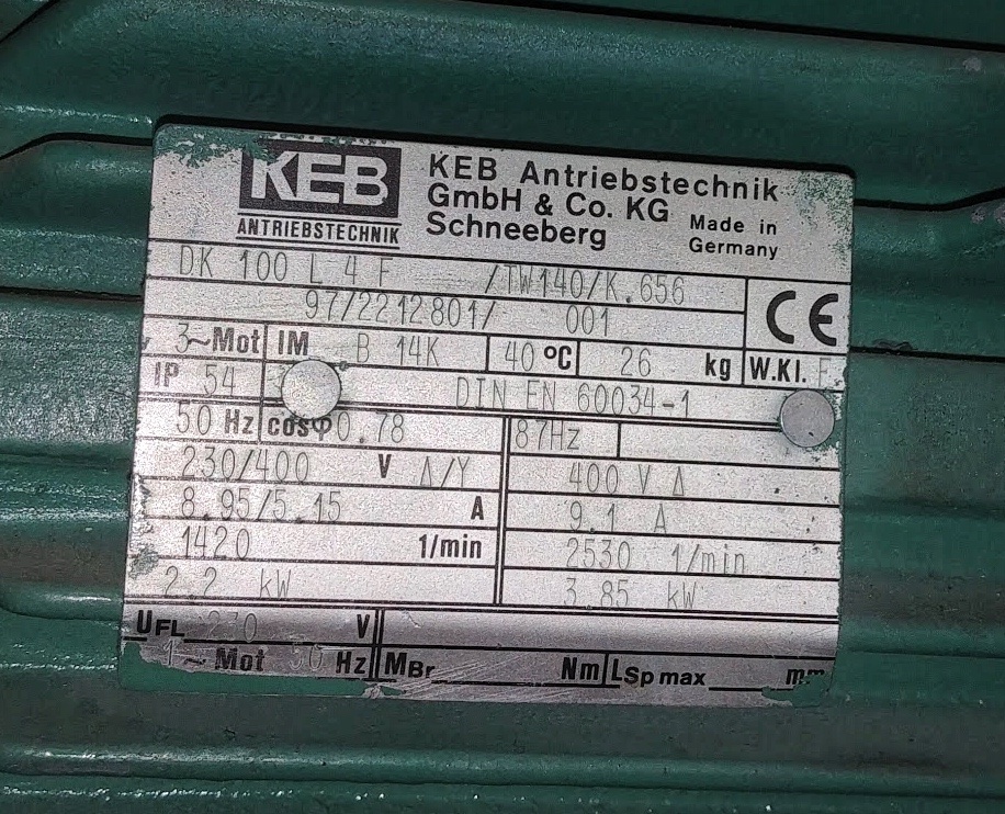

The KEB Motor plate says 400v Delta is 3.85 kW and 2530rpm. Alternatively 230v Delta and 400v Star gives 2.2kW and 1420rpm. The gearing between the motor and the spindle seems to be 1:1.

The motor is inverter rated, so the plate can be a bit misleading if you don't quite understand what the numbers mean.
A key principle to understand, is torque is proportional to current. As motor speed increases, the voltage required to drive the current through the windings increases. Once you reach the limit of the voltage you have available, current then drops off, resulting in the motor changing from being in a constant torque speed range, into a constant power speed range.
Now if you run the motor 240V delta/400V star, the speed at which that change occurs, is 1420rpm. From 0-1420rpm, the motors torque output is constant (it will vary slightly, but I'm going for the basic principles here!), and the power output will rise from 0 to 2.2kw. Once you exceed 1420rpm, the motors torque then starts decreasing, and output power will remain constant.
Now if you run the motor 400V delta, that changeover point is 2530rpm, but output torque will remain constant until that speed, at which point the motor is producing 3.85kw.
I've never actually checked, but I suspect Denford may run at reduced current to give a good margin of safety, so they'll be running 400V delta, but at reduced current, which means they'll be limting motor output to 3kw at 2530rpm, but maintain that 3kw all the way to 5000rpm.

Here is a photo of the motor plate if anyone wants to see it:
You mention that they maintain constant torque to 3kW although on my machine plate it says 2.2kW. Does your machine have a higher rating?
I wonder if I would lose anything with 230V Delta as that has constant torque up to 2.2kW, the same as the rating plate on the machine?

I see there are 2 different motor specs for the Cyclone. There is the 2.2KW like mine:

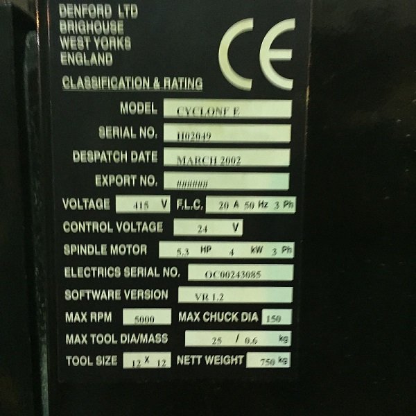

And then there is the 4KW on this later example:
Cyclone 4kw.jpg (61.92 KiB) Viewed 30110 times
Could it be that both machines have the exact same motor and VFD but they only differ due to the settings in the VFD? My KEB F4 VFD is spec'd at 4KW.

On my spec sheet from Denford, it quotes the motor as 5000RPM 4KW, but I'm pretty sure its the same motor as yours, just originally run at 415v variable frequency rather than 230v variable frequency, both wired in Delta.
Also, you won't need a 4KW VFD if you are switching to 230v input, as the motor is only rated at 2.2KW in this configuration, so you could save some pennies and get a smaller inverter. I got the 4kw, because the KEB I took out was rated at this, but that was driving the motors at higher voltage, hence the higher power rating.
