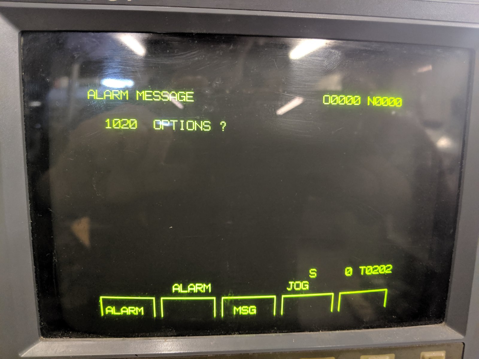

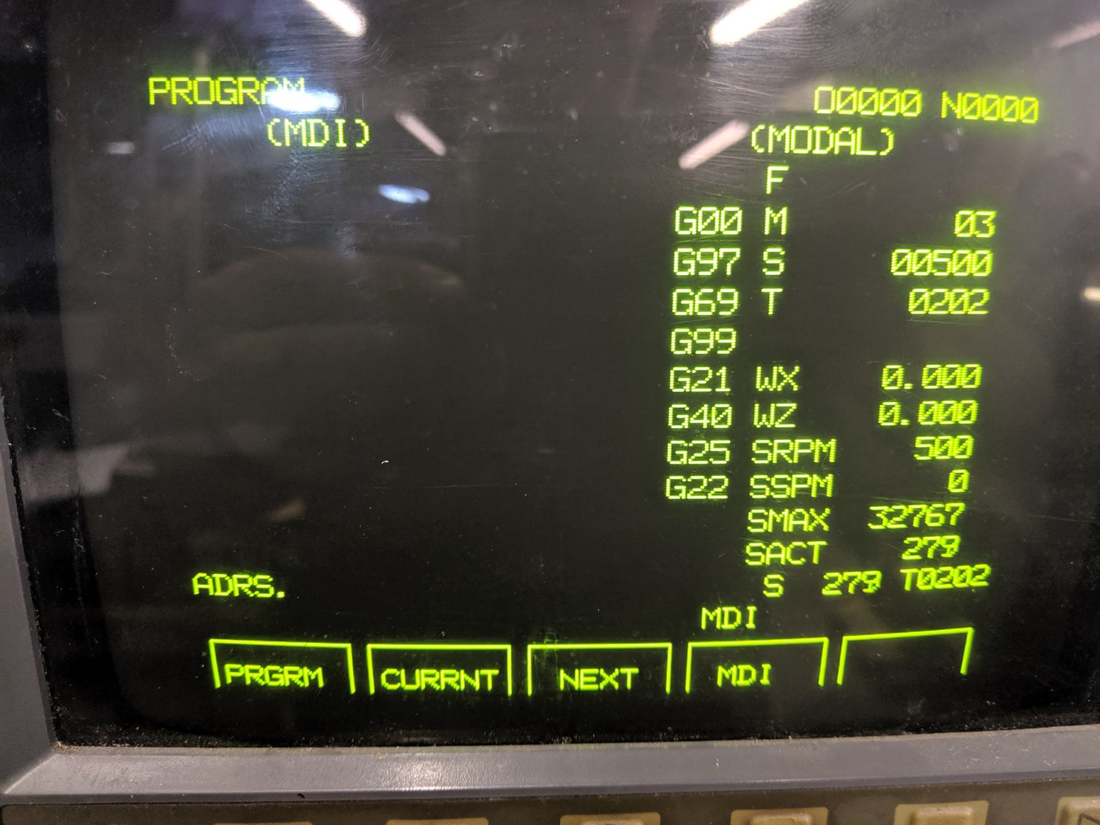

Hi, we have just got a Cyclone (CY03079B) when it arrived to us it had already lost its parameters, I've typed them in from the sticky parameters post and that has made the '404 Servo Alarm (VRDY ON)' go and I can now zero return and start the spindle.
my problems are that :
1 the spindle doesn't run at the correct speed
2 I can't toolchange either in Program or with the Jog with the panel switch
if I program S500 the the screen tells me SACT is 275
if I program T0101 the cycle start light stays on but nothing happens, the the panel switch it give me a 'OPTIONS?' alarm
I'm assuming that I've entered some parameters incorrectly?

Re: correct parameters?
hi Martin, just tried that its not changed the speed problem

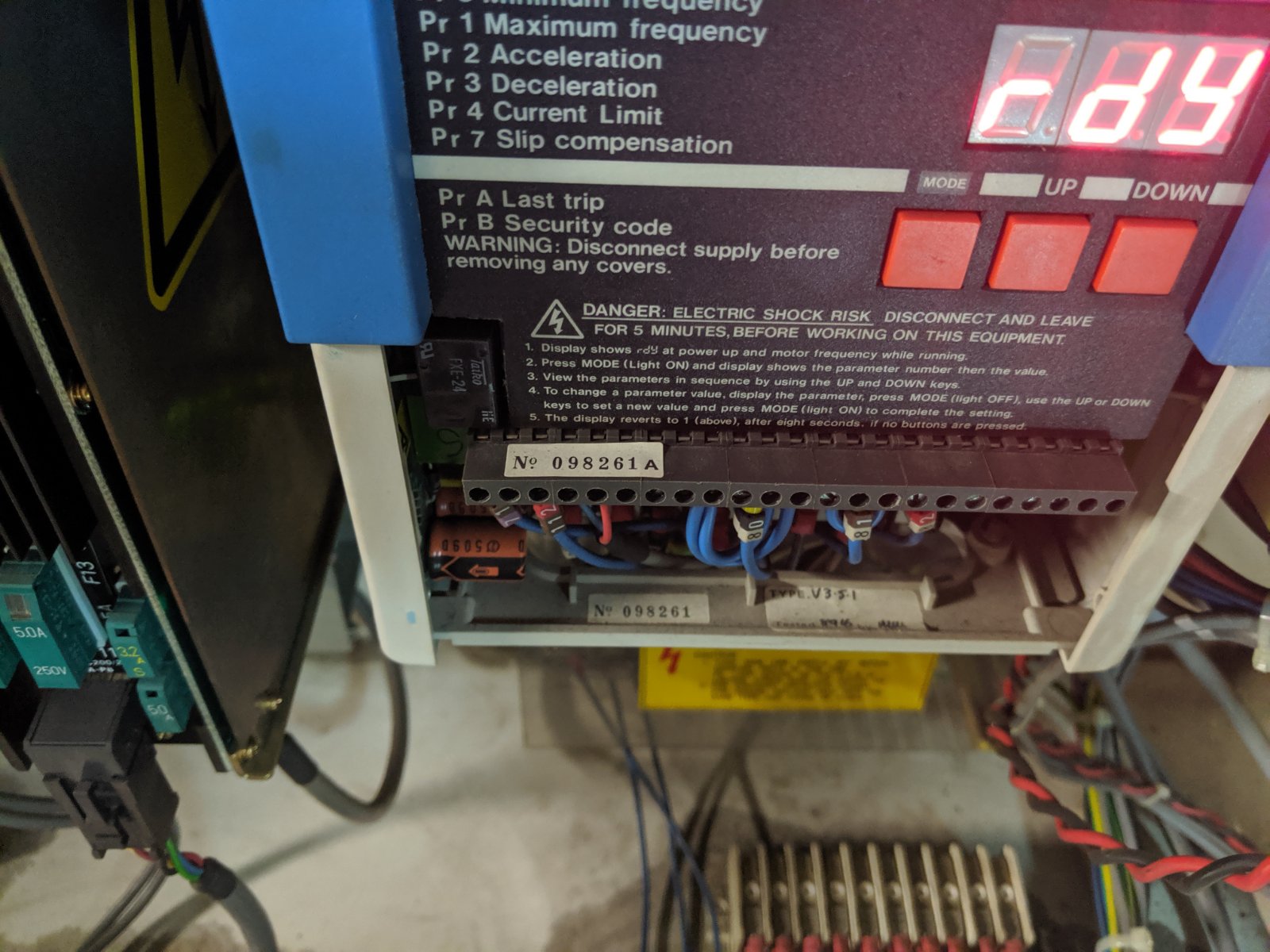

could it have anything to do with tuning this drive?
I dont have any documentation on itRe: correct parameters?
It could be. Not sure if we have any documents either.
Does it say what model it is?

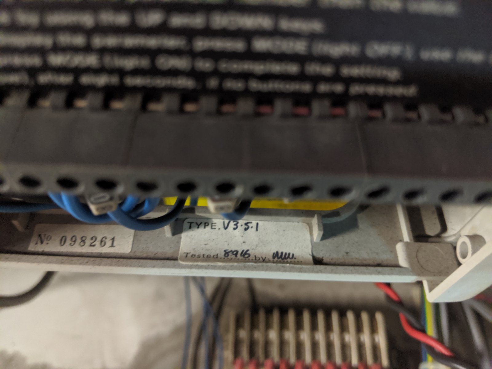

here is all the markings I can see
