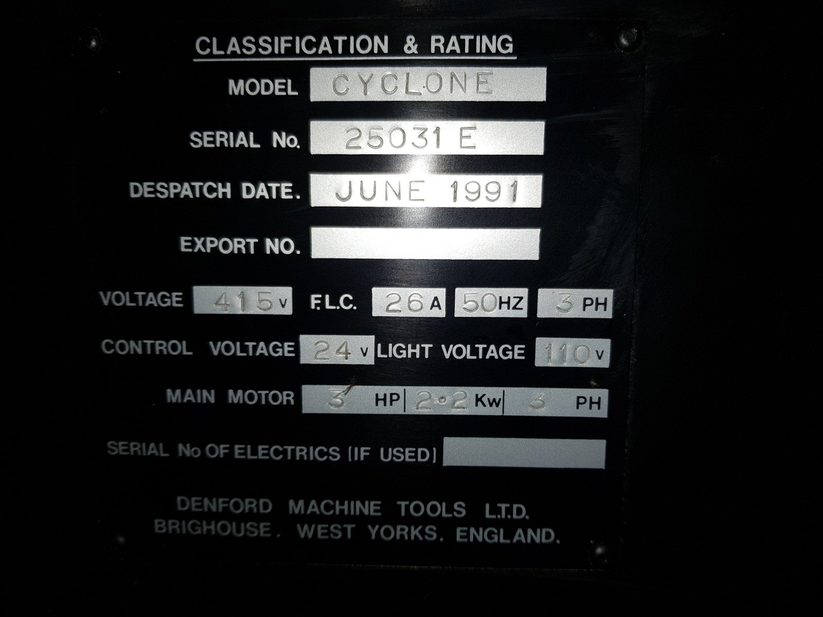

The rating plate says 415V at 26A (32kW?) which seems high even as a worst case startup current. I presume the VFD on the spindle can be tuned down a little to bring this into the realms of realistic budgets.

The current quoted in the literature as well as on the rating plates seems random! I've seen rating plates as low as 16A and up to 29A where the literature is generally 16 to 20A.

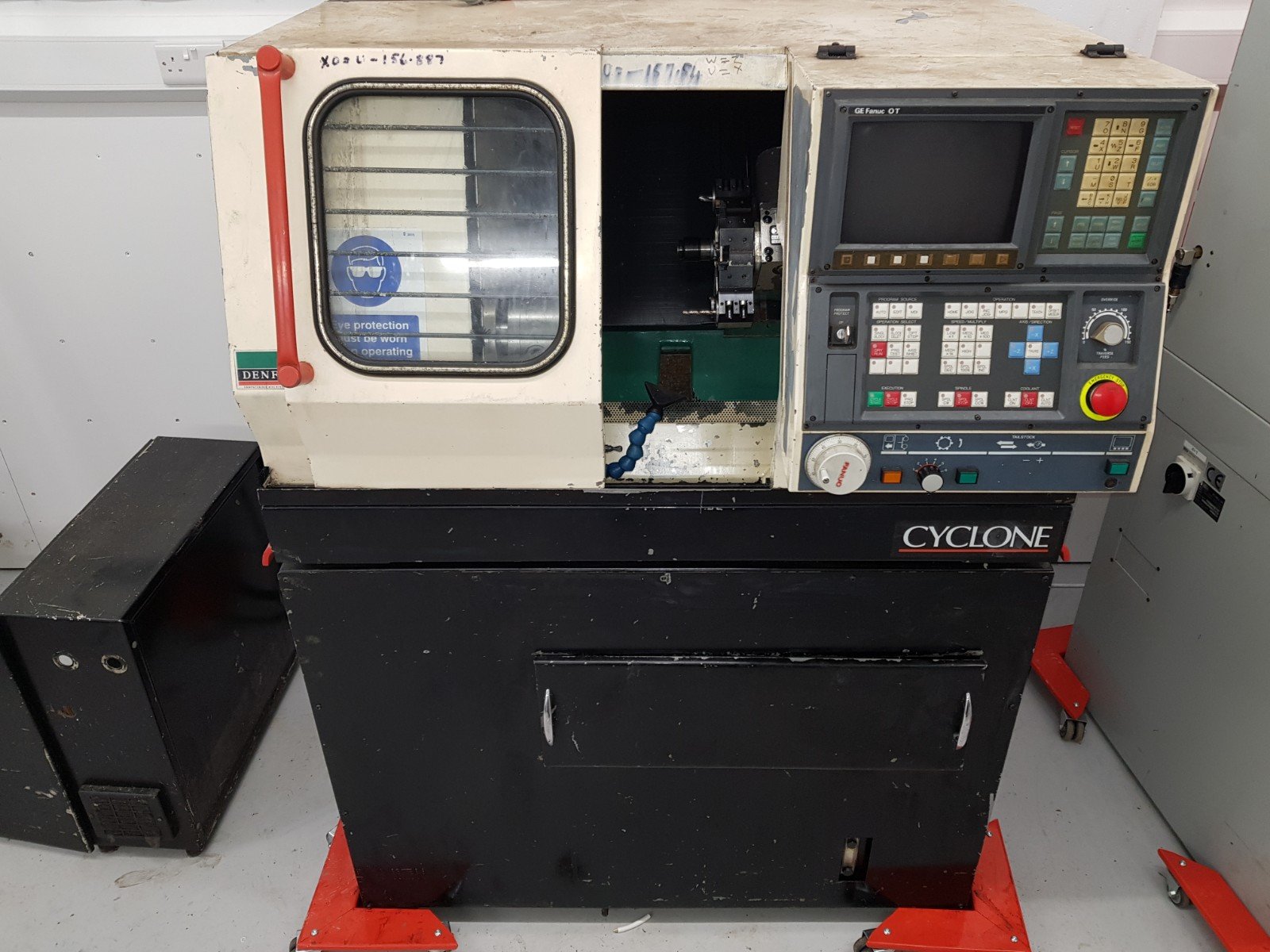

I have a Cyclone P with Fanuc 21i and use a Drives direct converter, the converter gives 16A 3 phase 400v and is housed in its own cabinet with a lot of filtering etc. I bought the inverter first and then had the rest of the conversion done with the filtering but the cost was about the same as you have been quoted. The converter has been great and allows me to run the cyclone and a small Yang mill at the same time.
I can’t see any Fanuc drives or the system in the photos, do you have any photos of them?

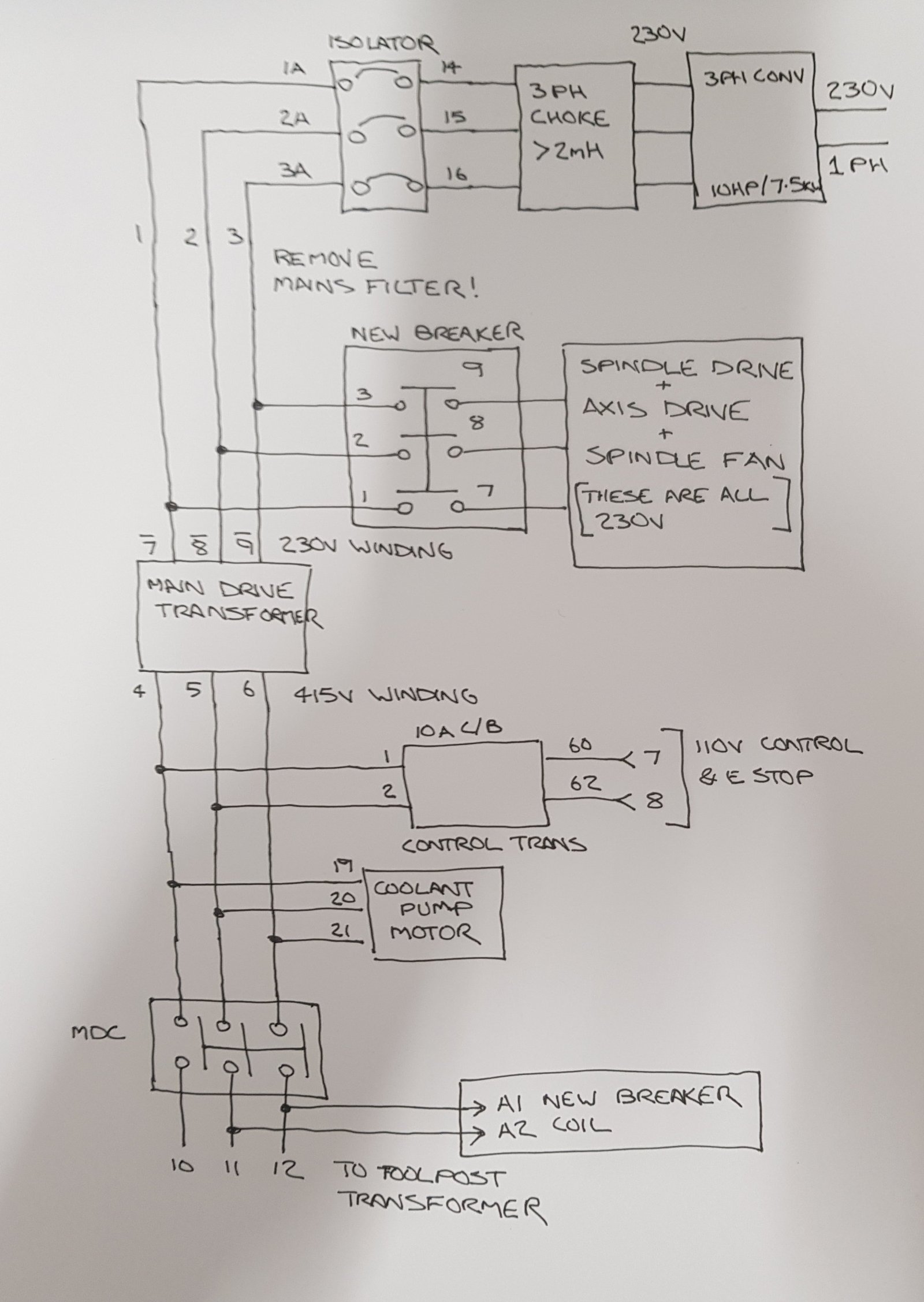

Good news - I have it running!
To make yours run, you will need a 10Hp / 7.5kW Phase converter. I used a digital converter, I don't know if it will work with a rotary, but it seems likely.
The Cyclone needs 415v to operate, but can be made to run on 230V 3 Phase (see later).
The simplest option is to buy a 415V, 10Hp converter and add a 3 Phase Choke (which cleans up the noisy output of your phase converter so it doesn't upset the CNC pixies. I bought a 7kw, 3mH 3Ph choke on eBay for £40 (used).
You will also need to increase the carrier frequency of the converter from 3khz (or whatever it's default is) to around 12 to 15kHz. This makes the choke work better - and keeps the pixies happy.
There's no need to use a 'special' CNC converter - inside the box is just a phase converter and a choke. It is not worth the £2k price difference!
A suitable 415v phase converter will cost around £1000. However, there are cheaper options!
I bought a Santerno SINUS M 10Hp Phase converter for around £500:
https://inverterdrive.com/group/AC-Inve ... 0V-Single/
It spits out 230v - but we need 415V. There are two options for this:
Find a 3Phase 220V to 415v transformer. While the phase converter needs to be 10Hp / 7.5kW to supply the high start current, the transformer doesn't need to be that big. 4kVA is plenty as the highest continuous power I've seen the lathe draw is 2.5kW. These are often found on eBay, having been stripped out of CNC Machines.

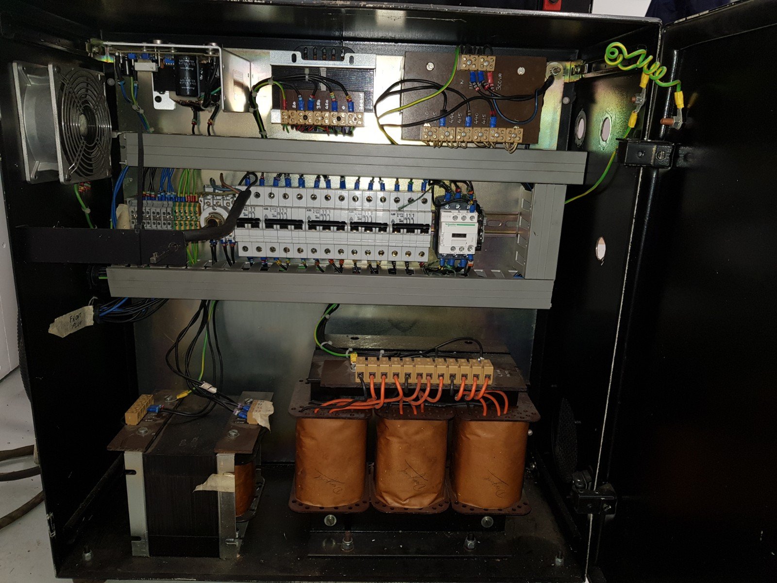

But wait a minute! Inside the transformer box, there is just such a 4.5kVA 3Phase 220V to 415v transformer - why can't I use that?!
Well, with a bit of re-wiring ans one additional contactor you can. Inside the Cyclone, it's used to supply 220V to the servo drives & spindle from the 415v input. I figured these could run off the phase converter and I could use the transformer to step up the 230V to 415v to run everything else. This does require one additional contactor:
https://uk.rs-online.com/web/p/contactors/6851542/
The new contactor uses the output of the MDC to power it's coil and connects 230V from the phase converter to the axis & spindle drives.
Originally, I left these powered continuously (not switched at the same time as the MDC) but it confused the pixies.
I've attached the modified circuit for the transformer box.
If you have any mains filters in the transformer box, remove them! They will overheat and the smoke will escape, connected to an inverter. Te choke you have added does the same job.

Just as a quick update, 2 Months on from getting it up and running on 230V 3 Phase - it's still running nicely!
I've pushed it quite hard a few times and it has not complained - and the magic smoke has not escaped!
£500 Inverter + £100 choke is all you need!
The 10Hp is only needed for a few seconds on startup. After that, the highest draw I've seen is about 4Hp. I'm using the same inverter to run my Emco Mill and it's happy running both at the same time.
Si

I've been in the process of converting my Cyclone to run Mach4.
[While I like Fanuc and the OT-B isn't the worst of them, the lathe is best suited to production work rather than small, quick jobs because of how time consuming it is entering the G-Code. I figured Mach4 would suit my needs better.]
I've also been converting it to run on single phase. I've used a small 1.5kW VFD to supply 3PH 230V into a 115V step down transformer to supply the coolant pump, fan, contactors & tool changer. However the spindle is what really takes power to run - and I found it's happy running on single phase!
You have to connect two of the 3PH 230V inputs together. Connect them to Live and the remaining phase to neutral. It's worth trying two phases only at first. Change which two out of three until the display lights up. If you run it like this, you get AL-02 (low voltage) Alarm. Try connecting the remaining phase to one then the other of the two and in one combination, it runs perfectly!
So, by separating the feed to the spindle (through a contactor), you can run the rest of the machine from a single 1.5kW VFD which is inexpensive. I tried one of the Chinese Cheap inverters, but I failed to persuade it to run up on connection to the mains. There is a parameter for this - but it didn't work on mine. Instead I bought a Delta VFD which worked as expected.
You still need a choke for the small inverter - but a much smaller one.

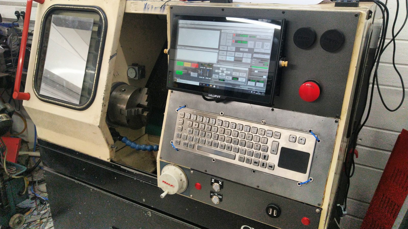

I've now finished the Mach4 Conversion - and it works well, including threading & Rigid Tapping.
I've used a CSMIO-IP/S which will talk directly to the OE Spindle Encoder.
2 x Allen Bradley Ultra3000 Servo Drives which will directly control the original Fanuc Red Cap Servo motors, with Step/Direction (or 10V Analogue if you want).
The Toolchanger, I think because it's old, was much simpler to control than some. It has just 4 outputs (of which only 3 are used) for the binary position of the turret, a brake (24V) input and 3Ph 115V in for the motor. I wrote a very easy toolchange macro in Mach4 which works reliably.
I think,the hardest part (other than research to find pinouts of the motor etc connectors) was that I had to make my own 3Ph 300VA 230 to 115V transformer out of 3 x single phase transformers connected together. I just couldn't find one to buy that was affordable and/or small enough. If any of you are thinking about a similar conversion, I'm very happy to answer questions. The setup of the Ultra3000 drives is easy once you know what you're doing - and I can help with that too.
I Plasma cut the replacement control panels. The Keyboard is held in with cable ties as I had an earth-loop problem and I wanted to try isolating it & earthing separately. However it was something else, so it's now earth bonded to the chassis. I've not got around to replacing all the mounting screws yet.
It's probably the most challenging conversion I've done yet - but the end result is really good. No better than the original Fanuc in operation, but no worse and a lot more user friendly!
