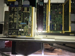

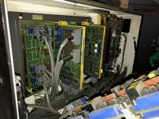

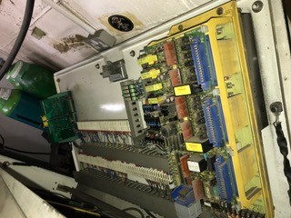

We used 2 different controls on the RH80 so a few pictures inside the electrical cabinet would be helpful.

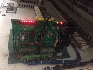

Post by Adam19 » Tue 24 Apr , 2018 16:21 pm
Pictures attached, hopefully you can see them!

Re: Cyclone Diagnostic Parameters
Post by Martin » Tue 24 Apr , 2018 20:11 pm
Ok. You have a toolpost control board fitted. It's the board in the distance in picture "lathe 4.jpg".
There may be a fuse on the base card which you can check. Also check that the card is fully pushed in. We used to fit a couple of cable ties round both cards to stop them coming apart.
Are there any lights lit on the board?

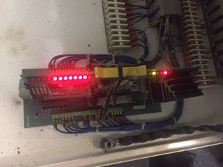

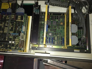

Post by Adam19 » Wed 25 Apr , 2018 8:05 am
Fuse seems ok and board is fully pushed, your right, there is a cable tie holding it back as well.
Pictures attached of lights...
Post by Martin » Wed 25 Apr , 2018 13:24 pm
Are any of the LED's labelled?
I can't locate any drawings or the manual for it.
