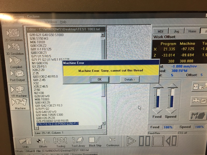

What happens when you program 300 rpm and try and cut the thread? Does it just hang up in program or do you get a message on screen?
If so can you post another photo showing the program and the message?
How did you create the program? What package?
Re: Denford cyclone TU150E Threading problem
Steve wrote:What happens when you program 300 rpm and try and cut the thread? Does it just hang up in program or do you get a message on screen?

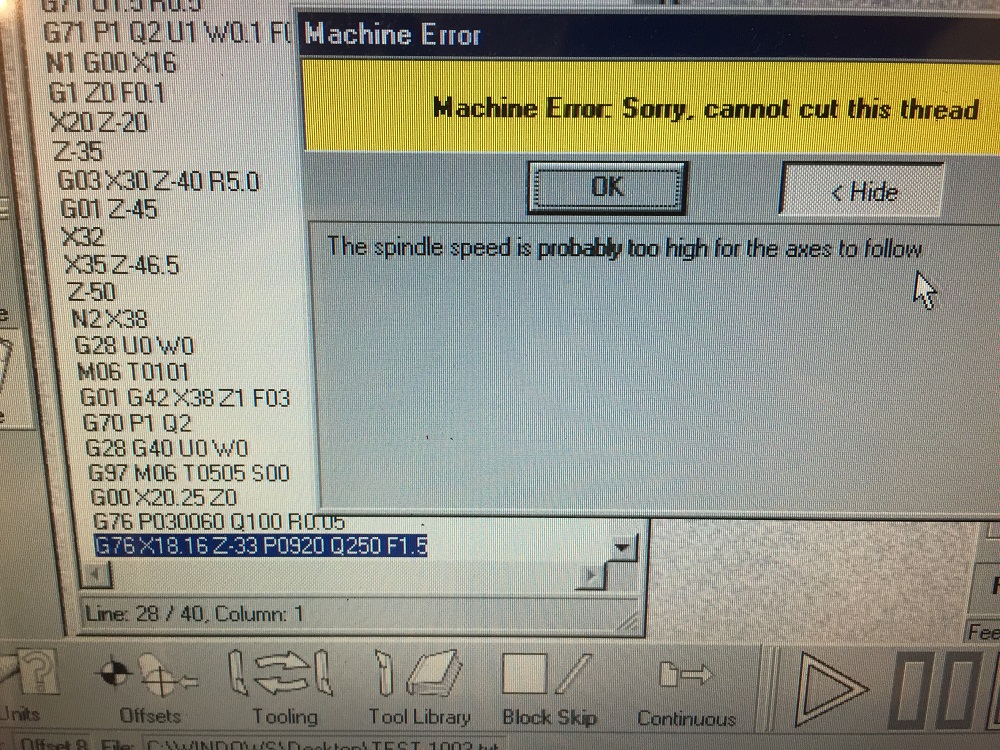

Hello
When I try program 300 rpm the machine stop and i get messege on screen.
I copied the program(g-code) from the user manual for denford starturn pc
What does it say when you click on the details tab.
I will upload th threading program Monday for you to try.
May be the program is the problem.
Steve wrote:What does it say when you click on the details tab.
Hello Steve
When I click on the details tab it does say "The spindle speed is probably too high for the axes to follow"
I will be very grateful if you check this program on your machine. Regards
Hi Dont know if you got this sorted but would say that you have G96 instead of G97
Phil
