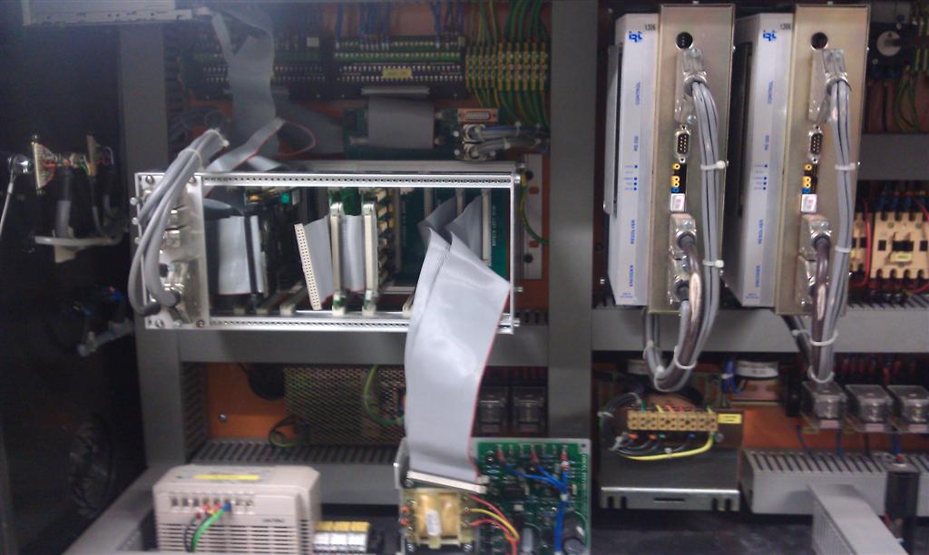

Just got hold of another cyclone but this one is alot newer (think my other is like 86) this is a 1997 one with a denford Tutor and when i've put power to it, it just comes up with error 128, i've e-mail denford tech and showed them a pic in the back of the machine and they say i'm missing a STE motion card from the back, anyone got one or know where to get one??? i've got work waiting for it to run!!!!
Thanks in advance!
Kenny
Re: TU150 U Won't Startup
Post by Denford Admin » Tue 05 Apr , 2011 12:24 pm
here is the photo kenny sent in:
